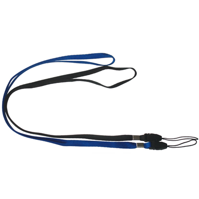

If you've got a MK2, then as it uses RF, I think you're stuck, so I had a look around and would an ankle pouch like this be of use?
Otherwise, what about Jim's suggestion of wearing it around your neck? Get one of those detachable neck strap so you can unclip it.
