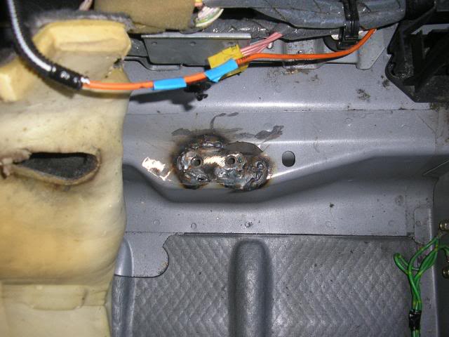

Pound to pinch it's the bracket closest to the central tunnel that has fractured if so you will either need to remove the carpet or cut it with a stanley knife.
I had done a few it is a common fault you will find that it is not that obvious if you take the lazy way and use the knife.
I welded the first one but have done the last few with epoxy; bonding a 16 guage metal patch in place of the thin original metal that will be floating about. Provided you can afford the time to let it cure properly 24-48 hrs
If you make up the patches drill several holes in them and the area over which they go the resin will fill any gaps and squeeze through the holes and make a surprisingly strong bond. and all of which will be covered by a thick carpet. just make sure not to forget the nut or better still a plate with a thread for the seat mounting bolt. It will need obviously to be in the right place and have a bit of float.
Hope I am wrong and you find the simple answer. But if not it's not that difficult, good luck

No, just bring your Citroen Keithhirsty wrote:Do I need to be a member?
Yes, it is and not an uncommon problem eitheraddo wrote:the failure shown there is terrifying!
One very good reason to find out why a seat rocks and get it fixed if it does...
Pug 405s suffer this same failure and it might be applicable to all PSA vehicles.
