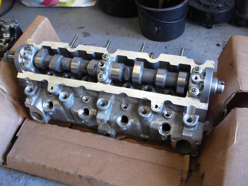

Original camshaft was snapped into 4 pieces. Two of the valves were bent. Two of the bearing caps were cracked.
I dissassembled another head on a spare engine and found another cracked camshaft and another smashed bearing cap. Bit of a nightmare to find these heads in good condition. My new one, pictured above, is the result of the combination of three heads.
