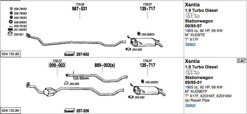

Hi guys well after iv just finshed repairing my car i took the car out to see if everything was ok.But when i was sat at the traffi lights i pulled off then there was aloud noise coming from the exhaust so i go it home up on the ramp and whats happend is that where the pipe goes into the rear box had broke apart but the this happend to the last owner and he had just put loads of the exhaust paste onit so is there anyother way to repair it without having to weld it and would be fine for the mot as i have the mot in april and i dont really wanna have to buy a whole new exhaust

Your only real way to sort this permanently is to get a replacement
connecting section of exhaust. If it's the main feed between the front
box and the rear one or the actual rear box flange - you'll need to make
an accurate examination to make the right replacement.
The best way is to see what's on offer on ebay as sometimes there are
clearance bargains where the postage is higher than the cost of the pipe!
Alternatively a decent section off a scrapper if funds are tight?

The exhaust on mine was falling apart a bit on that join aswell as on the cat, I did weld it up while GSF had the new one on order (full length from manifold to rear box including a cat for about £36!) though the metal was getting fairly thin so it could have only been a tempory measure.

This happened to us - there's obviously a jinx on Xantia exhausts in Devon - our rear box came adrift at the top of Kingsbridge shortly after we'd started our 130 mile return journey back to Gloucestershire. Turn round, creep back to our daughter's (sounding like a tractor), borrow old clothes, grovel under back of car with big pliers, a metal coat-hanger (to bodge a bracket for the pipe) and some fire-gum.
This seems to be a common failure, the box end-plate rots through where it's welded to the pipe flange. When I fitted a new box, I sprayed two coats of wood-stove paint on both end-plates.
Replacing the box is the only sensible repair, not too expensive and easy enough to do - the box is fairly heavy - looks more the size for a small truck!
