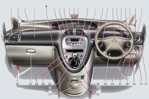

There's an electric motor with a mini propeller for the interior temperature sensor.
This is a very small motor :-k could it make such a loud noise?
Try listening close to the area which is marked as number 5 in the picture.
