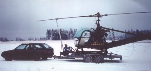

Hi Paul,
on a trailer with a BX Estate
Picture (Courtesy Mr P. Chidlow) as posted recently on the BXC site .
XMX
How about Towing a Helicoptercitroenxm wrote: Unless your being REALLY stupid or the weight looks stupidly over, normally they will leave you alone as they have more important things to worry about.
Paul
