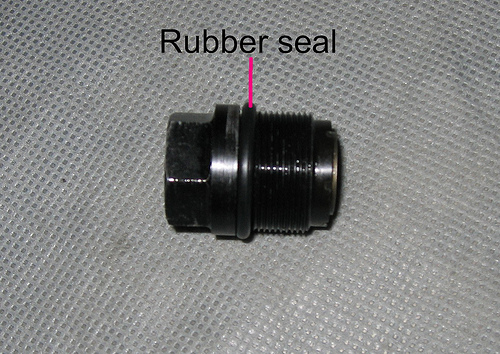

Unread post by DickieG »
Its more than likely due to the rubber seal around the main union going flat, the seal is available separately from dealers, here's a photo of the seal

Unread post by citroenxm »
Lots of LHM fluid on your Alintator WILL eventually kill it as all the Brush dust gathers with the LHM and accumilates around the brushes and stops them for working properly, The seal is rather a simple replacement, as shown by dickie, remove the feed pipe NEAREST the pully with 12mm spanner or union spanner, IT MAY VERY WELL BE TIGHT, theres NO NEED to deperessurise the system as I discovered you can change a pump with the system under pressure, anyway, remove the pipe, then with a 17mm spanner undo the next part its screwed into then undo it slowly, as theres a spring under it, HAVE A RAG under the pump, because while the union is off the LHM tank is higher, lhm WILL come out of the orface while the union is off, change the seal, and replace... if your quick enough you wont loose too much fluid..
