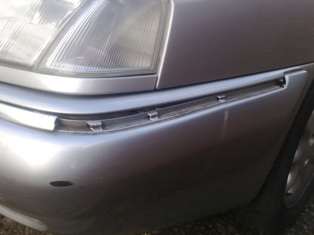

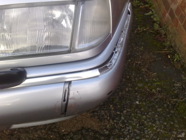

Hi fellas, just picked up my latest Xantia from a fellow member, cheeres Steve :D
But its had a little knock on the front bumber and part of the trim has come off. I think it can be popped back on somehow but wondered if any of you guys new if there was some method for this? Dont really wanna start banging it and have it crack on me, Take a look at the pics and you will see what i mean.
Any ideas fellas? :D

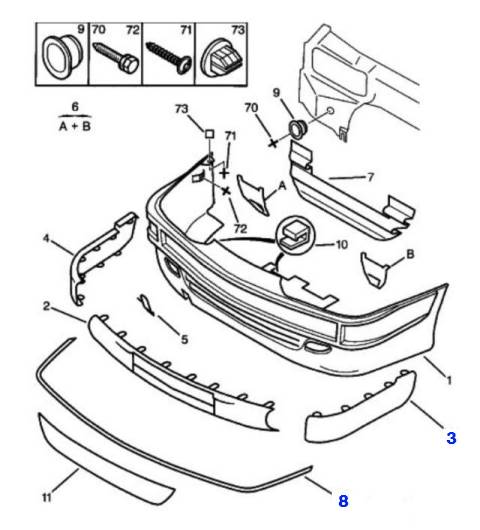

I've never removed the bumper but according to this pic it seems that part #3 can be fitted without bumper removal.
I hope this pic helps.

Wow, that is a great help, cheers for that. See what you mean about the part 3, it seems to snap on, as it were.

You can tell us the result if it really needed just a snap on.
Part #8 is just for the outlook and if that part is missing now then you can get one from a scrapcar.

Well just gave it a firm push and it didnt want to move anywhere. Will have another go in the morning see if i can give it a bit more wellie!

The outer bumper section do simply clip on, you may have a bent tag stopping it clipping on.

DickieG wrote:The outer bumper section do simply clip on, you may have a bent tag stopping it clipping on.
Well i recon instead of forcing it back on as is, it might be a wise idea to take it off to take a look at it. If its a bent clip im just gonna break forcing it back on.
Will give it a wurl in the morning and let you know what happens

If i remember correctly the silver/chrome insert is one complete piece and should have corresponding tabs/clips on the inside.You need to slot the end into the recess on the rear corners first as otherwise you will never get it to line up correctly.
Oh yours is a S2 not a S1 may not be the same as on my S1 :oops:
