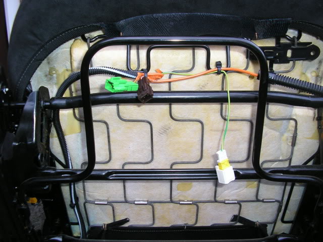

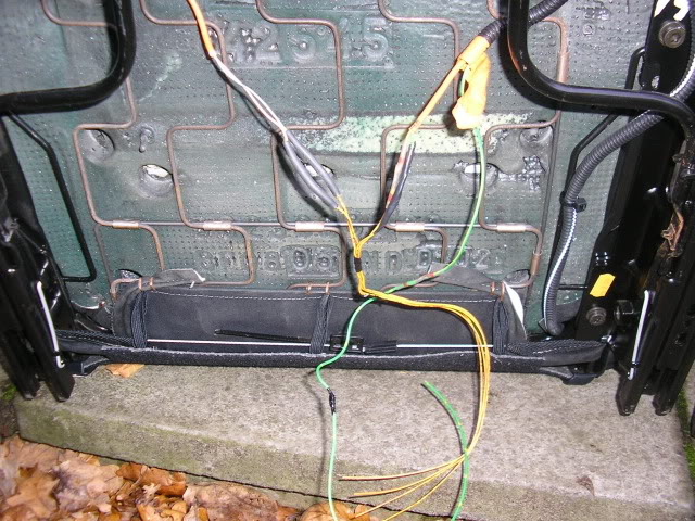

Went to scrappy today to aquire the leather seats but on closer inspection the passenger one has a tear/rip on the base and the smaller of the rear seats is also very tatty in areas :cry: :cry:
So it was off to plan B and i managed to get the fronts seats for my TD.Now these have the side airbags and my mk1 doesnt so this is a view of the underside of both showing wiring/connections etc
Drivers seat
Passenger seat
As can be seen from the second picture the wiring has already been repaired
so has no plugs.
Am i correct in thinking that
1.The white plug in the first picture is the extra earth wire and that i dont need to connect it to anything.
2.The brown plug is for the pre tensioners
3.The green plug is for the side airbag
If the above is correct then i only need to join the brown plug to my existing pre tensioner wiring and everything should work as normal ie the airbag ECU will not detect the side airbags and turn said dash light off :)
Cheers
Colin
Posts: 55116
x 8407
Absolutely spot-on Colin, just leave the green connectors dangling. I would connect the green/yellow wires to earth though. Not absolutely sure what they do but just in case they are needed.
I will rely to your PM in a while, I'm not ignoring it!!!
EDIT: Shame the leathers were not good :cry:
