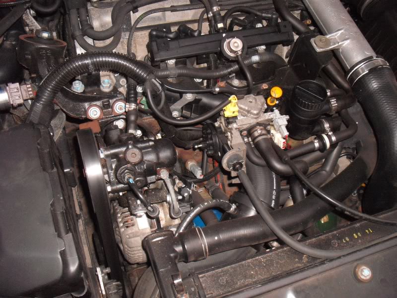

I noticed this sensor at the weekend (it's the one right in the middle of the picture):

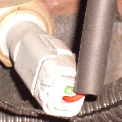

It appears to only have one wire (the red one) attached. The green one appears to be in the plug, but either not connected or maybe cut:
The BOL isn't a great deal of help with this. Is it the oil temperature sensor or a coolant sensor? Or neither? :) Please can anyone advise if theirs is the same?

Think its oil temp sensor. Oil level sensor is at the rear. Its meant to have one wire, but sure does look like one has broken :wink: Don't worry thats how it should be, mine is the same, and so was the spare engine loom i had.

Isnt that the oil pressure warning sensor and the oil temp sensor is in the sump? i ask because my TCT engine has a sensor in the front of the sump but no plug in the loom to connect to it :? any ideas?

Yes, that is the pressure sensor Dean. The temperature sensor is in the sump with a blue plug on it as far as I recall...

That doesn't look cut in the picture but more like its fractured to me :(

No, that's normal on MK2 wiring Will :roll: I know it seems odd but it crops up all over the place. Your MK1 has a totally different sort of connector here...
