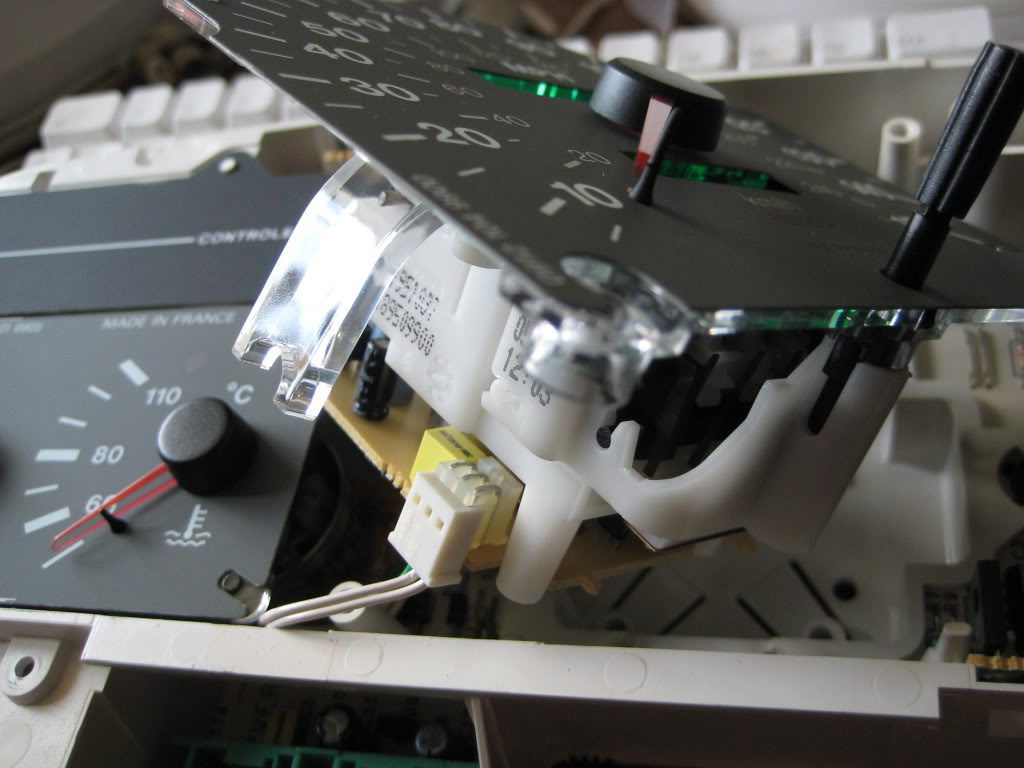

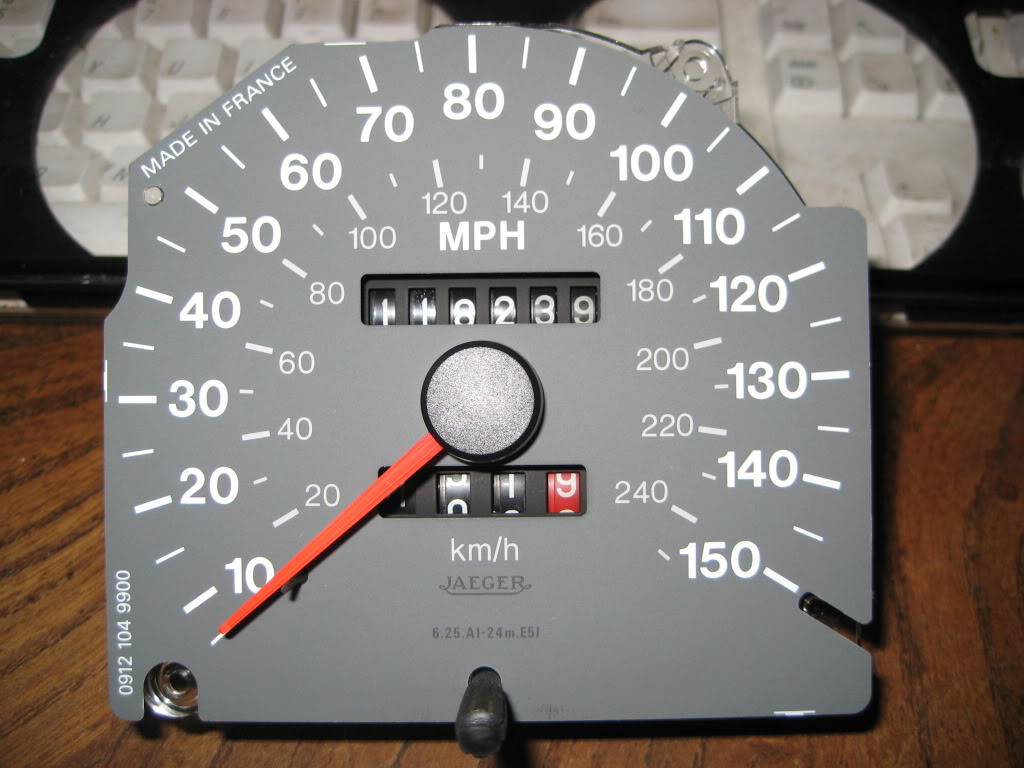

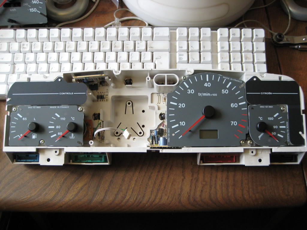

- [1] Remove the 6 screws holding the shroud
[2] Remove 5 screws holding the speedo head into the frame - two front, 3 rear
[3] Unplug 3 pin plug onto the circuit board
[4] Removed speedo head looks like this (8695, 8696)

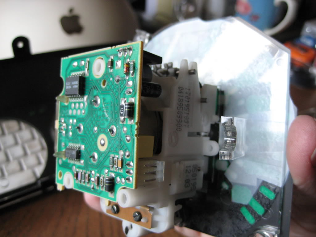

[5] Examine the printed circuit board

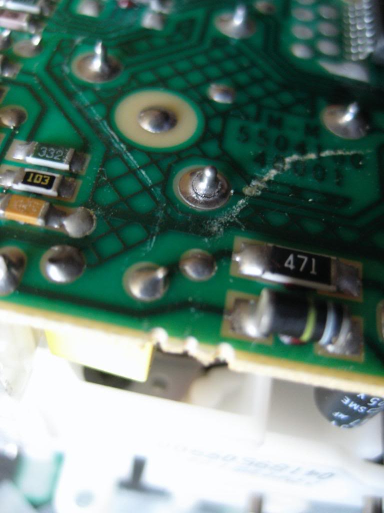

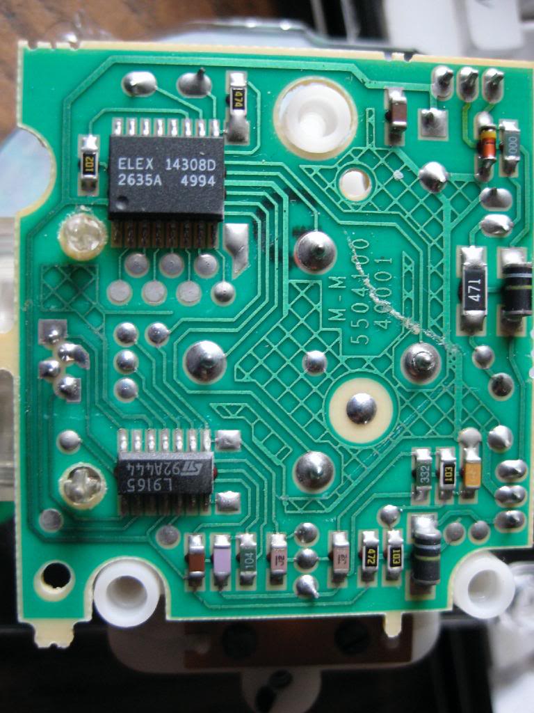

The likely culprits are one of the four soldered posts. The broken solder on
one of the pins can clearly be seen in the photos. The pin was loose on the
circuit board.

Lovely write-up and photos andmcit. Nice and clear so I think I am going to now go and throw myself into this repair...
