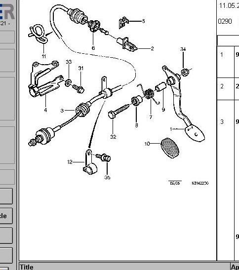

Hello there i'm new to this forum nad could do with some help.
I have just done a complete clutch change on a citroen xantia.
I've also changed the clutch cable and the plastic clip but can't remember the sequence for the how the spring goes onto the pedal.
The one way i set it up the pedal was that high that it fouled on the steering column.
I can't figure it out and have spent hours looking on the internet to no avail.
Can anyone please help ?
A picture would be ideal but a description will help.
Thanks
Mike :(

Hi Mike,
Welcome to the forum :D
Will this picture help?

once it is all together to the point of offering up the pedel, i always leave the hooked end of the spring at one side or under the pedel that alows the other end to just sit in the right place,
then get the bolt in (on RHD cars fit the bolt same direction as Jims diagram) with the nut on,
now just push the hooked end of the spring with a screw driver up over the pedel arm
(that diagram looks like its for a LHD car), but its just about the same for RHD,
