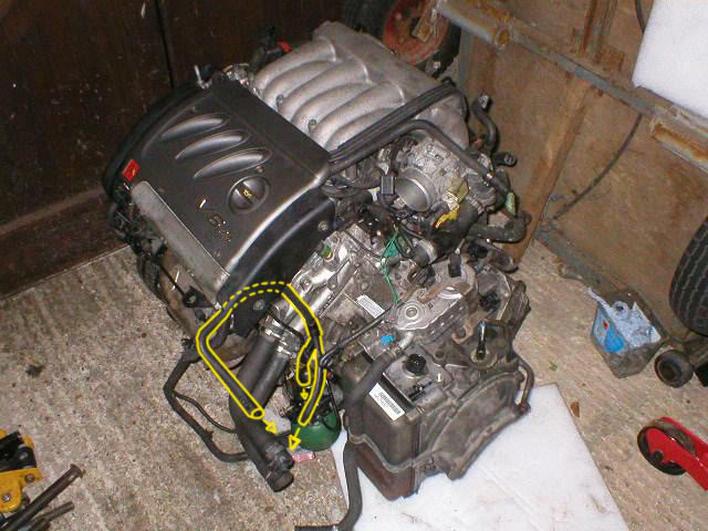

So, finally, this evening with plans to remedy said leak I find it's another
one of Citroen's wonderful weird inventions that I've not seen before and
don't have a spare handy for. Figures. :roll: The source of the leak turns out
to be the regulator/front electrovalve hydraulic feed pipe. This runs off the
rump of the regulator and runs up round a plastic capping on the engine's
nearside. The pipe runs round toward the battery and joints onto a metal
feed that appears to run to the reservoir.
That wouldn't be so bad but just near the top of the gearbox there's a T
joint that runs off a plastic shrouded joint back to the front electrovalve that
sits on the radiator cross member. To help visualise things (So long as you
don't mind Jim!!) I've found one of the pictures from the gearbox job very
helpful!! Actually, I'm hoping this whole post will mean more to Jim perhaps
than many others...
The leak is on the electrovalve feed about 10mm from the T joint and a
plastic sleeve so there's little to get hold of and bridging a metal/plastic
feed pipe into and no chance of a jubilee on both ends were I to try this
kind of repair. :(
In case you didn't know, the pipe required is the one outlined in yellow! :D

Because the hose goes to the electrovalve which is mounted on the body of the car, the problem is that this piece of hose gets flexed when the engine moves.
Mine broke there and I managed a repair that has lasted 3 years without leaking. I cut the hose just past the split, and cut off the remaining bit up to the T. This leaves about 8mm of T junction standing proud, which is enough for a seal, but not enough for mechanical support, and not enough to fit any standard hose clip that I know of.
I considered cutting out and replacing the T piece, but the hoses are different diameter, and I couldn't find a suitable replacement.
So I wrapped a few turns of steel lacing wire around the small hose about 10mm from the end, tight enough that it is not going to slip off, and bound a small cable tie into the last turn of that. So I had a loose hose with a cable tie securely fastened near the end of it.
Then with the hose pushed onto the T piece, the cable tie reaches around the back of the T piece and is suitably tightened.

mine went a few years ago on the red one same pipe i think.
unfortunately citroen only sell it as a complete pipe with the metal T-bit. it extends down to under the nearside wheel arch, which is where mine failed.
i'm trying to recall a price, i have a feeling it was the expensive one 130 quid or something and took a month to come in stock from france. could be wrong it was a few years ago.

Item 3
00005270FA OIL BACK HARNES 58.13 GBP GBP
Item 2
00005270PS OIL BACK HARNES 132.47 GBP GBP

'Fortunately' I need item3 - the second item seems to have a combined metal
and rubber hose jobbie so presumably that's why it's made of polished brass?

That pipe (no 3) split on mine when I applied too much pressure to the side of it as I was removing the pipe containing the thermostat, after ordering it it arrived within a couple of days.

I've been trawling the net trying to find a supplier of desmopan hose in the hope of being able to buy it by the length for repair purposes, but as yet no luck :( Seems daft having to buy a complete assembly when the rubber bit just clips on...

Unfortunately the hose that's perished on mine is part of item 2 in the diagram and I don't really want to fork out £130 when I could get a metre of hose for a fiver that would do the job. Might have to get some petrol hose in the short term as I'll be driving her down to Bordeaux next month and I don't really want to leave a green trail along the péage.
