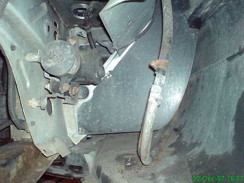

Its a Diesel, and it sits under the DRIVERS (off side) UK Cars, side wing, ahead of the wheel arch inner liner... the wires connecting it come through near the ECU's and its connected to the main harness in that area...

Here is how to disable EGR pump (and therefore EGR operation) on Bosch Inj XM 2.1TD.... works a treat! See:Its a Diesel, and it sits under the DRIVERS (off side) UK Cars, side wing, ahead of the wheel arch inner liner... the wires connecting it come through near the ECU's and its connected to the main harness in that area...
Paul
http://www.topcorp1.com/swing/coffinclimax.html#EGR

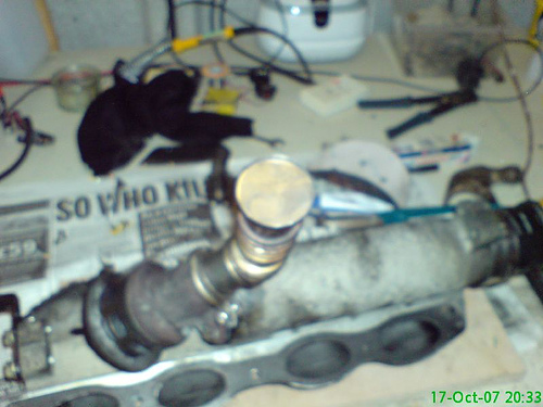

As you say Steve, a nice easy way to disable EGR on a 2.1TD XM. Mine is a 1997 auto with Bosch mechanical injection - in fact the only HiTech bit seems to be the EGR!A nice easy way to disconnect the EGR but if the valve's sticky or leaky it doesn't work. Also on ECU controlled engines that could put the car into limp mode. The blanking plate method is better but more time consuming.
Here's how I did it on the XM 2.5 I had.
I would however point out that IF the EGR valve is sticky or leaky, (even if left in working order), it will require fixing..... the car now runs as sweet as a nut BTW, and slightly better on DERV to boot! 8)
Many thanks to you guys who helped.

That's exactly why I blank them off with a plate, it doesn't matter then if the valve's faulty. Though I have heard of the blanking plates being corroded through.
For owners of newer/fussier cars I would think twice before diabling the EGR system, for example it's thought that EGR faults are what leads to the demise of the Renault 1.9 DCi's.
