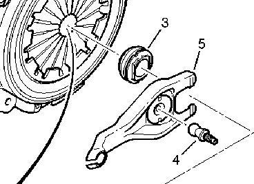

Sadly Brian, it's not a 'box I'm familiar with but I'd be very much inclined to think the release bearing has come to the end of its life.
It's a very different arrangement to the usual BE3 in having a floating release arm on a balljoint as this picture shows:
I cannot see how exactly the release bearing is attached to the arm but I suspect that very much like the BE3 it is clipped on with rather flimsy plastic clips. If those have given out, the bearing may be floating more than it should and parts of it are rubbing on the diaphragm spring that should not be.
In any case, it's a gearbox off job and if it's the original clutch, it's not done bad.
The good thing is that the BE series of 'boxes with the cable clutches are a whole lot easier to remove than the hydraulically clutched ones that need special tools to replace the release bearing.
