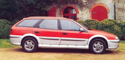

Anyone else here dream of a 4WD Xantia?

No thanks...addo wrote: Anyone else here dream of a 4WD Xantia?

To put it into perspective, I love this video, but you simply can't maintain that aspect in a FWD car...
