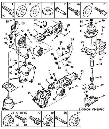

If ive found the correct part then its iten 13
Hope this helps
Colin

Colin thanks - that does indeed look very much the part.
I'll get to it tommorrow and check for any damage caused by its absense.
