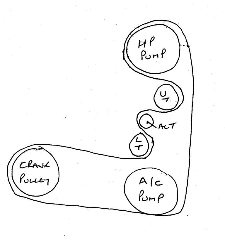

Take careful note of the routing of the Auxillary belt as it's nothing like any other engine. If you do loose how it goes, I have a diagram...

This is the diagram of the Activa Auxillary belt...
Apologies for the quality of the sketch :oops:

That looks somewhat like a sculpture of a seated woman, nursing.

addo wrote:That looks somewhat like a sculpture of a seated woman, nursing.
That made me chuckle :lol: :lol: :lol:

Barbara Hepworth is still among us :D
