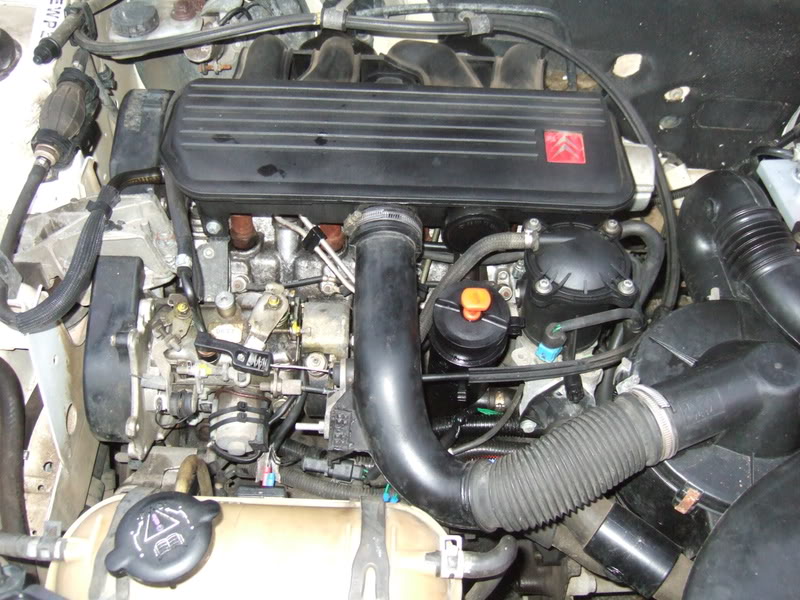

pic of the engine:

Excellent :) Always helps to have a picture and a VIN number...
According to Citroen it has the XUD9 engine and the picture confirms this pretty much. It has a Lucas injection pump so no trying to run it on veg. It'll kill the pump...
The correct glowplugs are the BERU GN909. (GSF Part. No. BBGN909).
The engine looks nice and clean and the other problems are pretty minior so it has to be worth a bit of TLC.
Glowplugs are an absolute doddle to swap on these. You can see them clearly, looking like baby spark plugs with a heavy cable daisy-chained between them.
Give it an oil change and see how it goes...
