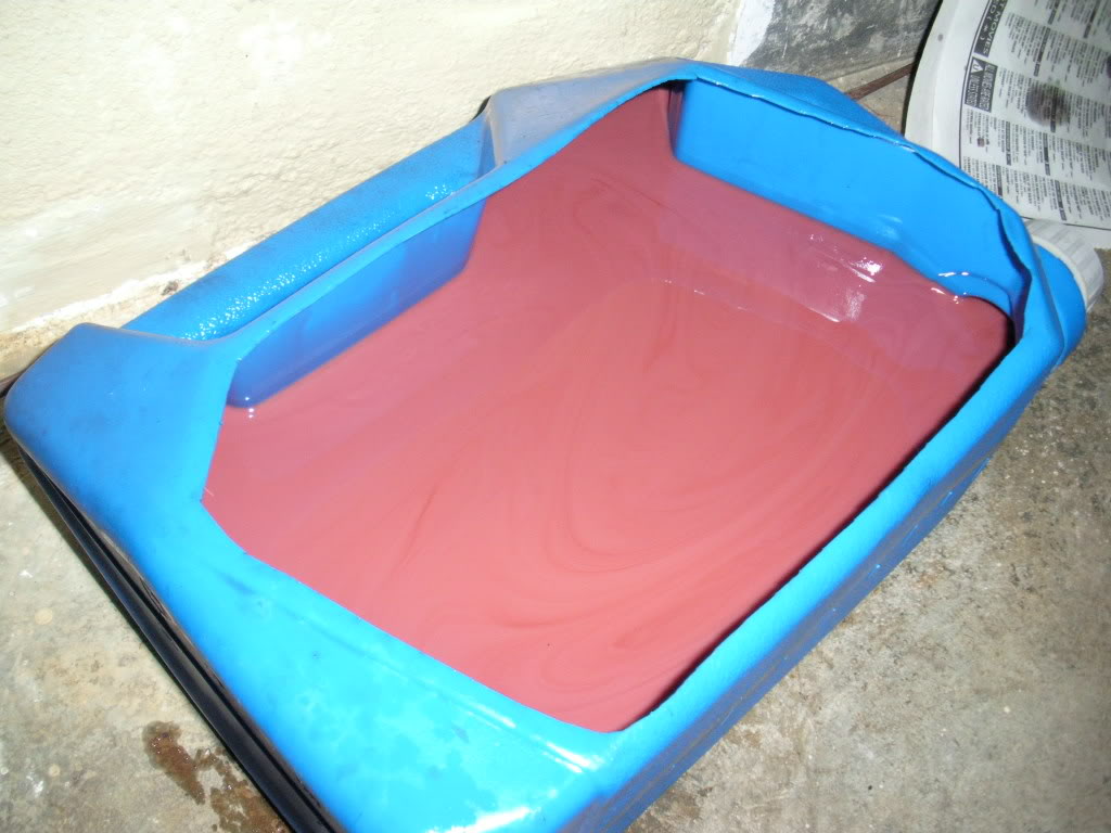

So, after driving through heavy rain and spots of standing water (not that deep, probably 3 to 5 cm) I feared that the same might happen again. Sure enough, when I got home, pulled out the ATF dipstick and I could see some change in the ATF colour. See here:
Did the normal drain and refill (2.5 lit) today. Will probably repeat after a week (what you guys think?).

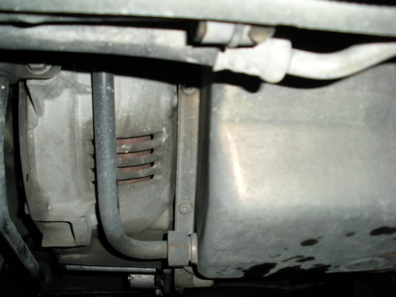

My only concern is: how could this happen? Is the car designed only to be driven on sunny days? Where could the water get in through? Here?
I suspect that the vent holes on the bellhousing may have let water in. Any solution to this problem? Help really appreciated!

I wouldnt have thought the vent holes would let in water, if water could get into the oil through there then i would imagine you would get fluid coming out ?
What about the oil cooler ? its not allowing the oil/water to mix is it ? is the car using coolant ?

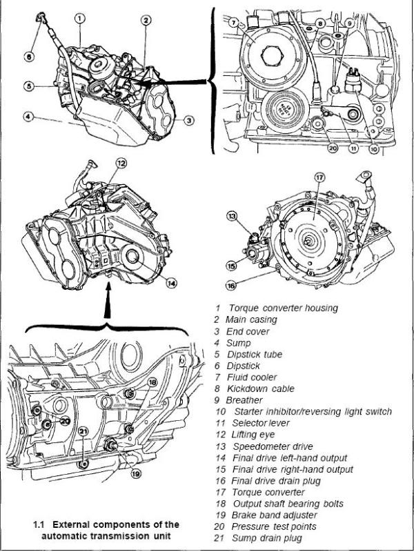

There is a (small) vent on top of the box somewhere which protrudes the box. The vent should have a small cap.
This is only there to cater for normal temperature related fluid volume changes.
Only if the engine bay has been truly flooded you will get water in here - in small amounts.
It is very easy to modify this for wading/fording : simply clamp a length of tube over the vent and lead the tube to a hole in the air filter box.

I'm really sure it's not water from the coolant. I've changed the ATF about 3000 km ago and there's no water contamination, only normal dark-colour dirty ATF. After heavy-storm driving, the ATF turned cloudy....and that was the first time this year I've driven it through noticeably deep standing water (okay...3-5 cm).

There is no way that the ATF can be contaminated through the vent holes.
As Wheeler already pointed out, if that was the case, you would as well lose ATF out from the same place.
And thats not going to happen.
Unless a major gearbox fault has occurred.

But, just to check the position of the breather tube, refer below:
It's way up on the gearbox and I'd say well protected from road splash. Now I'm really frowning whenever it's raining heavily......
