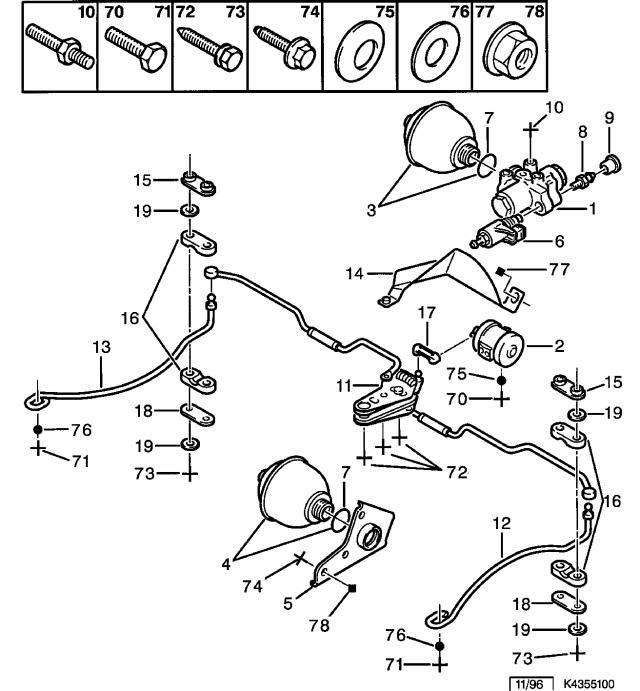

Sl4yer wrote: I got to pull at the roll control linkages behind the front wheels today too. The car did roll both ways, but it took quite an effort. Is this normal? Also, it didn't seem to return when the linkage was released, but only when I pushed it back. It's probably fine, and certainly seems to drive OK. I probably haven't got a mechanic's grip! Any opinions appreciated.
Hi James,
Yes, the rods do need a fair pull but the car should return to level on it's own after you have let go of them.
The rods link up to the roll corrector (Item 2 in the picture below) and this is basically a height corrector sitting on its side and lacking the damping elements of a standard height corrector so it responds instantly. The mecanism on the roll corrector that the rods actuate is very similar to the mechanism in a height corrector and suffers the same woes if not kept well lubricated.
Securely support the car on stands, get under and have a look at the roll corrector and give all its mechanism (item 11 in the picture below) a good clean and spray with lube. Whilst you are there, have a look at the blocks (16) on the wishbone linkages and the linkages themselves (13). The linkages can bind in the blocks and the linkage rods can wear oval where they run through the blocks. Both items are easy to replace and surprisingly cheap from a Stealer too :lol: I spray the linkages where they run through the blocks with spray grease from time to time and when I'm feeling like doing the job properly, dismantle them, clean them and give them a proper greasing.
This PDF will give you instructions on how to set up the roll corrector linkages and some more pictures of how it all hangs together.
