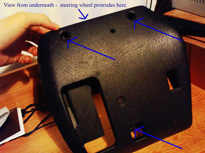

I've actually got a MkII Xantia steering wheel shrouding right next to me on my computer desk - hows that for a coincidence!
In fact, as its on my desk, and I want to test out the camera on my new phone I've taken a picture for you Keith!
The three blue arrows (apart from the top one which shows where the steering wheel would be in relation to the shrouding) are where the T20 torx screws are.
Hope this helps
EDIT: To take it off, it looks like once the screws are undone you pull the top bit towards the steering wheel and twist it upwards, unless you push the bottom bit back?
Anyway, be careful when taking the shrouding off as there are little fiddly tabs that keep everything clipped in and snap easily.
Hope this helps
