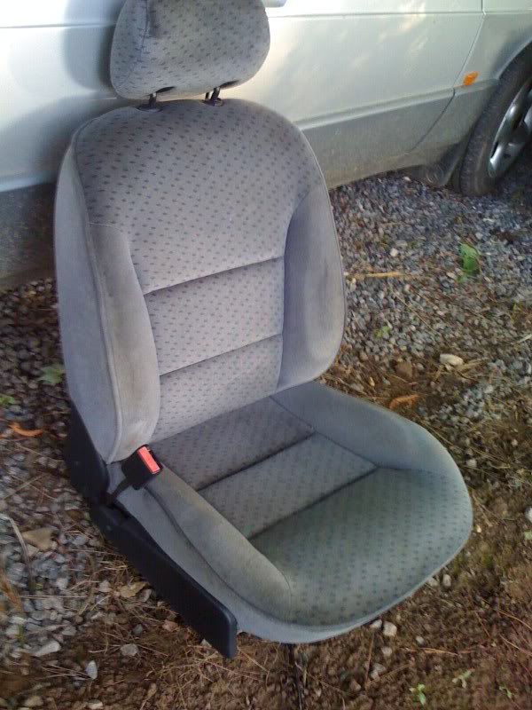

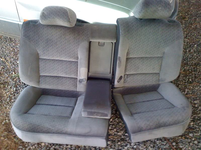

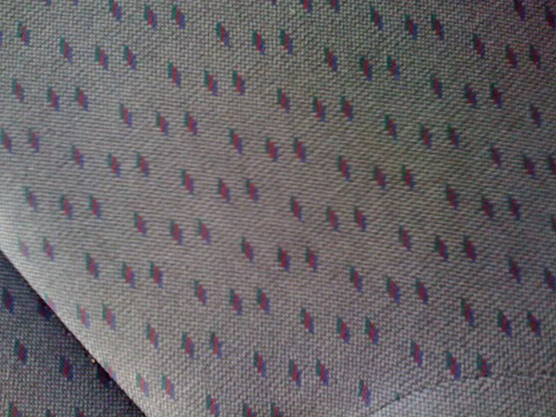

I've got a set of seats and matching door cards that I'm not sure what
I'm going to do with off a s2 which DON'T have side airbags:
They're clean, ODOURLESS and don't have tears or burns or kiddy marks
on them; the 'bruises' in the pictures are where they've been standing on
one another in the back of an XM...
- what do you need?
Andrew
- what do you need?
Andrew
