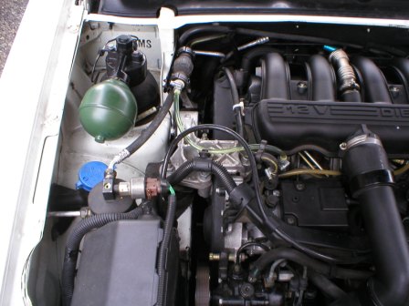

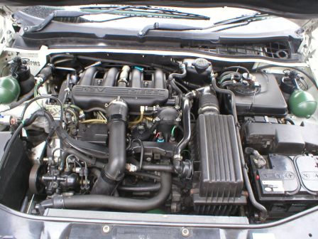

If you were to go for a 2.1 say, you would need to get the complete running gear as everything is different. You'd even need hoses and silly little things like the radiator expansion tank. You'd also need the 2.1 pedal box as the clutch is hydraulic (different gearbox) and the throttle is an electric "fly-by-wire" type, operating a sensor under the airbox.
You'd need also the gearbox selector cable mecahnism and maybe even the gearstick.
The 2.1 may be a possibility as the same running gear was used in a number of Peugeot and Citroen White Vans along with the Peugeot 406.
It is still a big undertaking though. I remain concerned at the bodyshell differences in the region of the engine mount. below are some pictures of a 2.1TD Xantia engine bay and you can see how different it is..
A slightly easier proposition may be the HDi 90 engine. At least that used the same BE3 gearbox and drive train as the later 1.9TD and did not have an intercooler. I'm not sure of the engine mounting arrangement but again, it may not be so complex as the 110 HDi. Your biggest difficulty with the 90 HDi would be electrical and the need of an HDi fuel tank with the lift pump installed inside it.
