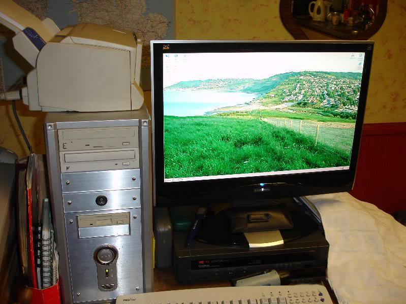

Hiya Mike..
I have installed 2 RAM sticks of ! GIG DDR 400 something? mpg? lol.. So I have a total of 2 GIGs of RAM. I had to leave the central slot empty or I can't run on duel core?.. I did want to upgrade the RAM but I was unable to find any 2 GIG sticks of 400? and my motherboard wont take the DDR 800 (so I am informed)..
My M/board is an NF7 series approx 2 years old now... Hmm I will try to add a pic of my PC layout if I can get photobucket to work.. :)
My PC is stood on an old VHS player that still works very well via my AverTV card.. I built my PC on the kitchen table and it's been there ever since! :oops: I had to buy another kitchen table for mealtimes.. lmho.. :roll: :)
My desktop pic is of Charmouth in Dorset (looking Westward toward Lyme Regis) where I spend my holidays most years. I keep most of my shortcuts in a folder on my desktop so as not to spoil the picture.. :)
