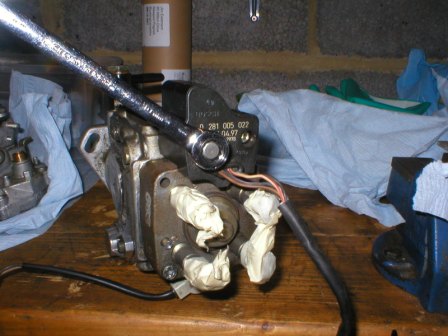

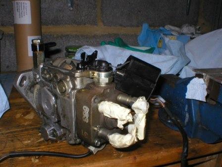

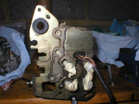

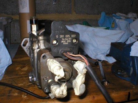

Pictures:
The first shows the armour in place. The drilled out rivets can be seen.
The next shows the module above the stop solenoid after the armour is removed. You can see the two screws holding it.
Removing the screws with a Hex bit and spanner
And finally, the stop solenoid exposed.
If you carefully slice off the top and front of the armour it will be possible to withdraw the electronics and wire straight to the solenoid.
Note that the pump head is removed in these shots for clarity. The boost sense diaphragm housing and the fuel return line connection will considerably impede access when in place. On the bench it could be done with a Dremel but in-situ, I still think it would be close to nigh-on impossible unless you made a few well chosen cuts and then took a hammer and cold chisel to it

I've only got to remove the two bolts holding the black ecu on that sits on top of the stop solenoid.
Using the picture above I've arrowed the two bolts I need to remove, but I think as the armour isn't there the bolts are of the shear off type.
The metal armour doesn't exist on my bosch pump.
- Posts: 54807
- x 8203
Ahh, sounds like your pump has been previously de-armoured before romie. That makes it easier...
