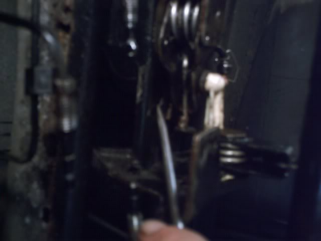

Today I took off the HC to get a better look at things. Looking at the pivot spring (the silver one in my picture) one end tensions against the bar that comes out of the front of the HC the other end of it (after its wound round the pivot) is just going nowhere i.e into air -
If you look at the picture I have (as best as I could with a screwdriver) pointed out a hole in the plate, should the straight end of the spring go into this? Looking at it on the car its the only thing that could hold the straight end of the spring with to give it tension. If you have good eyesight you can see the hole at the end of the screwdriver, with the end of the spring right next to it

Sturdybloke wrote:You can see that the end of the spring in the background is correctly located. The end of the spring in the foregroung is just hanging about. Is it meant to sit in the notch/cutout on in the bracket?
Definately shouldn't be hanging about loose. The spring should be symetrical and be able to act in the same fashion in both directions. Does it look like it will stay in if you put it back in the notch, or is the notch worn/damaged ?

Think I have It sorted now. Its lifting fine so we shall see. I think that it was due to the spring jumping out of the notch on the cradle and then just flapping about.
