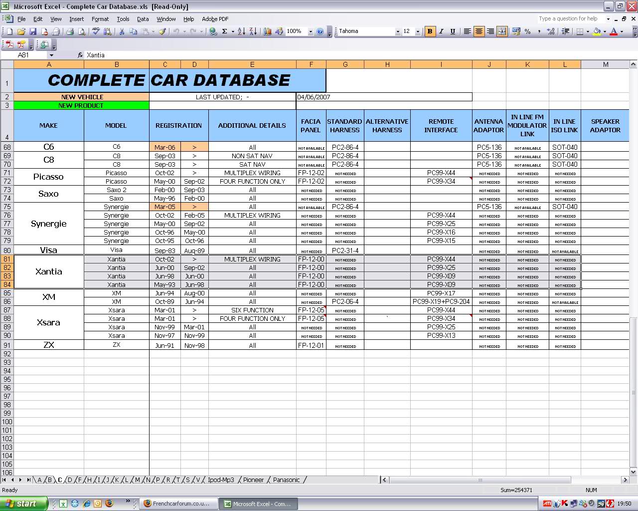

Here's the list of Autoleads adapter cables for the Xantia (apologies for the large size, but the text was unreadable otherwise):
I replaced my stock radio cassette with a Sony head unit. I stuck in an Autoleads PC99-09 remote interface cable and Bob's your uncle. The cables are about 30 quid in Halfrauds, but I was lucky enough to pick one up on ebay for a fiver. Happy days...
If you want to stick with an OEM radio, try it before you buy
