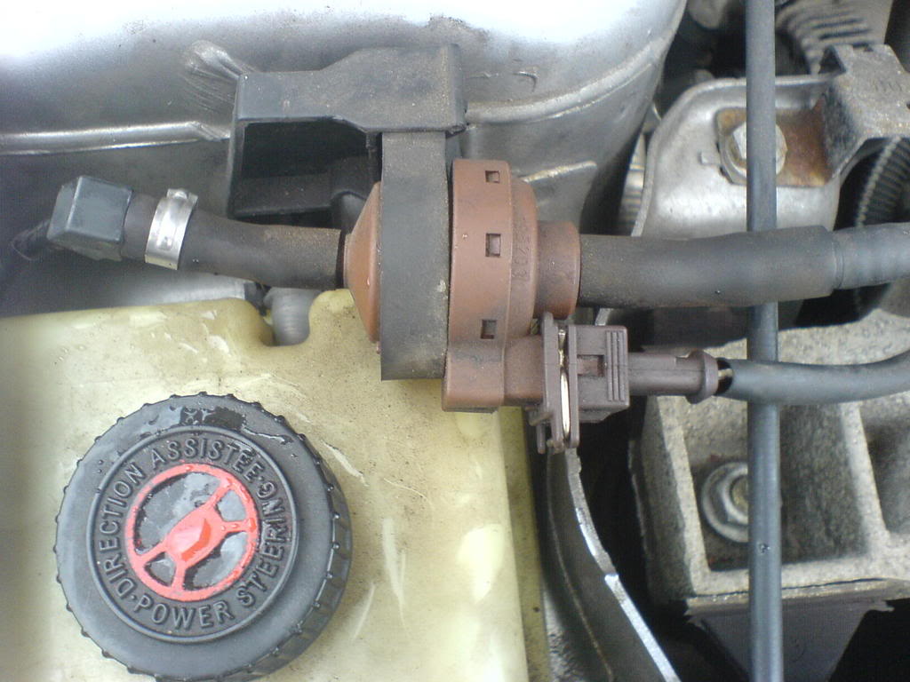

pug_owner2002
- Posts: 288
- Joined: 27 Feb 2005, 21:05
- x 3
Hello All,
I've had a look this morning and the rubber hose appears to be ok.
The picture below shows what I think is the MAP sensor, hopefully someone can tell me if I am correct.
One test I have tried doing is disconnecting the rubber hose from what I think is the map sensor (the hose I disconnected is on the right of the picture) this seemed to make the car run better and never made the fault lamp come on?
Is the pipe that is on the left of the picture the one that goes to the charcoal canister? if so do I just split it and block it up with a bolt or something?
Thanks again for any help as it is much apprecited.
