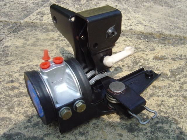

We all refer to the Xantia height corrector as simply a height corrector, but as most will know this refers to the height corrector and the cradle, as supplied ready to fit.
The part that normally seizes is indeed the cradle, at least here in the UK they do, mostly due to the fact that they sit under the rear of the car getting covered in wet spray, salt and whatever else the road has to chuck up.
Now as said before the cradle arrangement will sieze, a lot of people see that the plastic clip has popped off and quite rightly think "i'll pop a new link on and that will sort it" Well in my experience it dont! It only makes the clip stronger thus resulting in a broken metal link, see piccy.
Also note the shiny new plastic clip and broken link!!
This piccy shows the recon height corrector ready to fit.
And as for the throttling valve inside, well this was replaced years ago with a plasic sleeve arrangement, this will block up quicker than a toilet at Glastobury, so keep the LHM clean and if in doubt, FLUSH IT OUT.
See piccy of modern type throttling valve.
Hope the pics help to explain the problem, as they sat a picture tells a thousand words!!
As you may have realised I have fitted more of these height correctors than I care to remember, just so happens that the classic broken link one was removed from a 2001 Xantia yesterday.
Must go now I have another Xantia height corrector to fit!!!!!

slim123 wrote:We all refer to the Xantia height corrector as simply a height corrector, but as most will know this refers to the height corrector and the cradle, as supplied ready to fit.
Guess that must be a regional thing then ;)
I cut my teeth on GS's and CX's, and they didn't have a "cradle", they just had a long torsion bar going from the roll bar clamp to the height corrector... why they took a simple, reliable and indestructable torsion bar and replaced it with a complicated bracket, spring, and plastic clip for the Xantia is anyones guess!
Just refering to the entire assembly as "the height corrector" is bound to cause confusion IMHO, and unnecessary replacement of an expensive and seldom faulty item.
Agreed - the spring unit must be checked and cleaned/lubricated as well. I think this is a regional thing though to - over here in New Zealand the spring units show no sign of deterioration or seizing even on 12/13 year old cars. Probably the same in Australia. I greased the springs on mine as a preventative measure all the same.
What model/year has a valve like that ? I've stripped the front height corrector on my 1997 Xantia a few months ago to clean it, and it didn't have anything like that, it had the standard small round discs with pinholes held apart with spacers...

The new plastic type throttle valve was fitted to the later cars, I dont have any info as in dates or RP no's.
Pleiades tell me that most going in for overhaul have this type now, but getting it out aint easy especially for DIY as it is crimped into the ally housing, they tell me that they have to drill it out before fitting a better modified throttling valve, does not block so easy and keeps the height corrector more responsive.
Also the cradle is built as a rivited unit and is not designed to be taken apart (like so many things today) To clean this properly will need the use of drilling and tapping then putting back together using set screws.
The word from the experts is that one of their fastest selling items is, the Xantia rear height corrector.
A lot will ask, why not the front one?? that seems to be location, under most engines (except Jap engines) there will be a small amount of oil residue and the heat from the exhaust helps to keep the fromt height corrector dry and fairly rust free.
