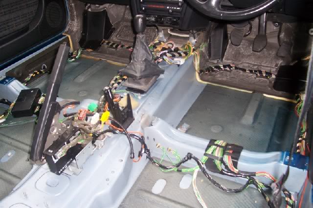

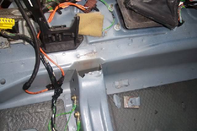

Update on this thread. Now I know how to use PhotoBucket.com. I have some interesting pics to show.
Crack in Xantia Scuttle trim over heater inlet. The crack is so neat I though it was a join in the plastic.
Damaged cross member under driver's seat.
Close up of damage.

KevMayer
- Posts: 1051
- Joined: 12 Sep 2003, 22:01
- x 2
There was no sign of rust thankfully.
The seat fixing nut has come away as you can see.
I am rather suspicious of the cause. It could either be brittle metal in that area, a very fat person has owned the car, a young couple have been using the car for nocternal visits to the countryside (but they'd use the passenger seat surely !) or my worst suspicion is that it is the type of shock loading damage you get if the car has been in an accident.
The car is all back together now. I fabricated a saddle out of some sheet steel (a heavy duty shelf from work... they wont miss it !). I bolted it in place and all is well.
I sealed the scuttle panel and the crack with some car body silicone sealant and its been dry ever since.
I attached the alarm ECU to the white metal bracket to keep it off the floor just incase of future leaks.
