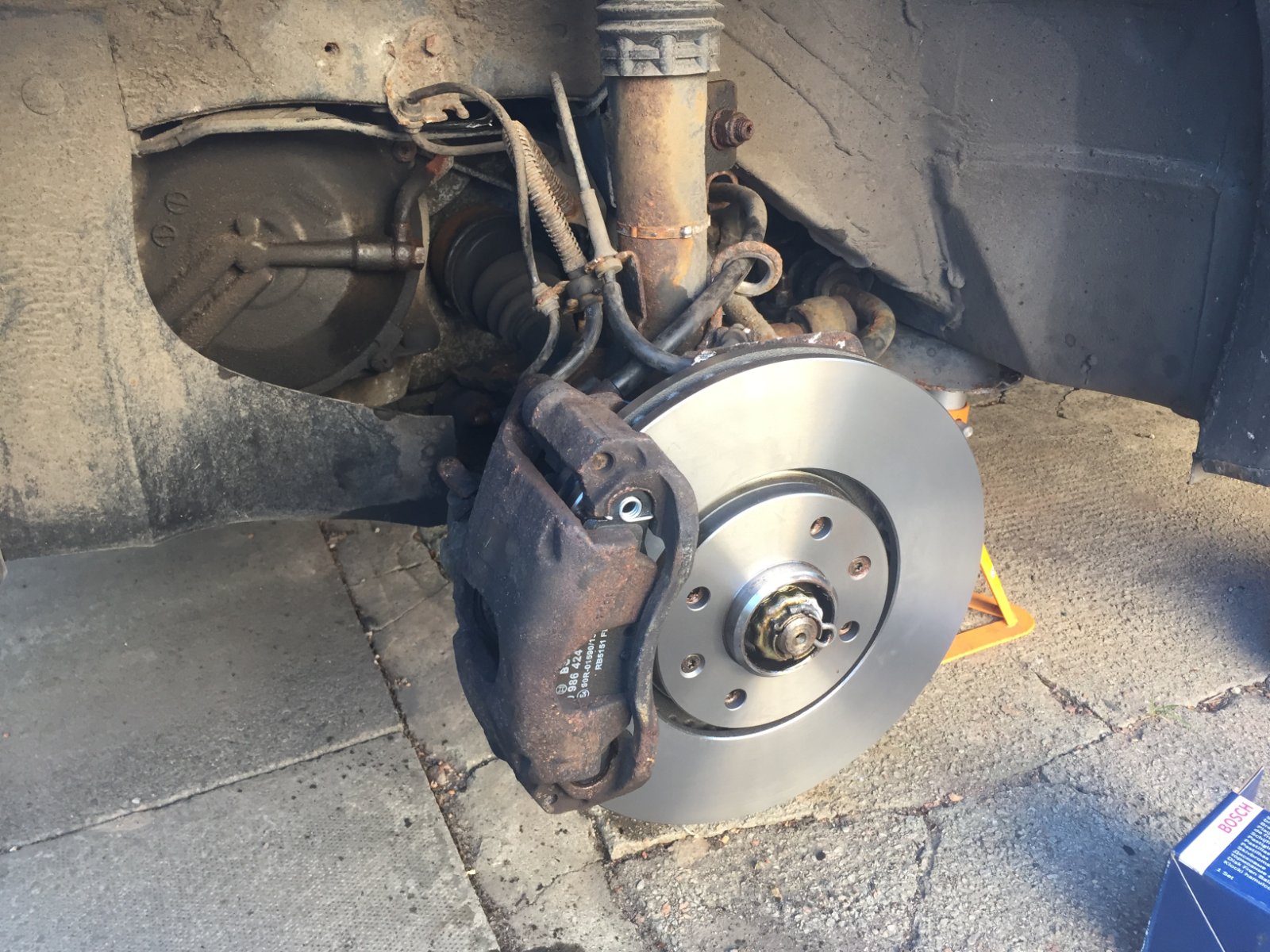

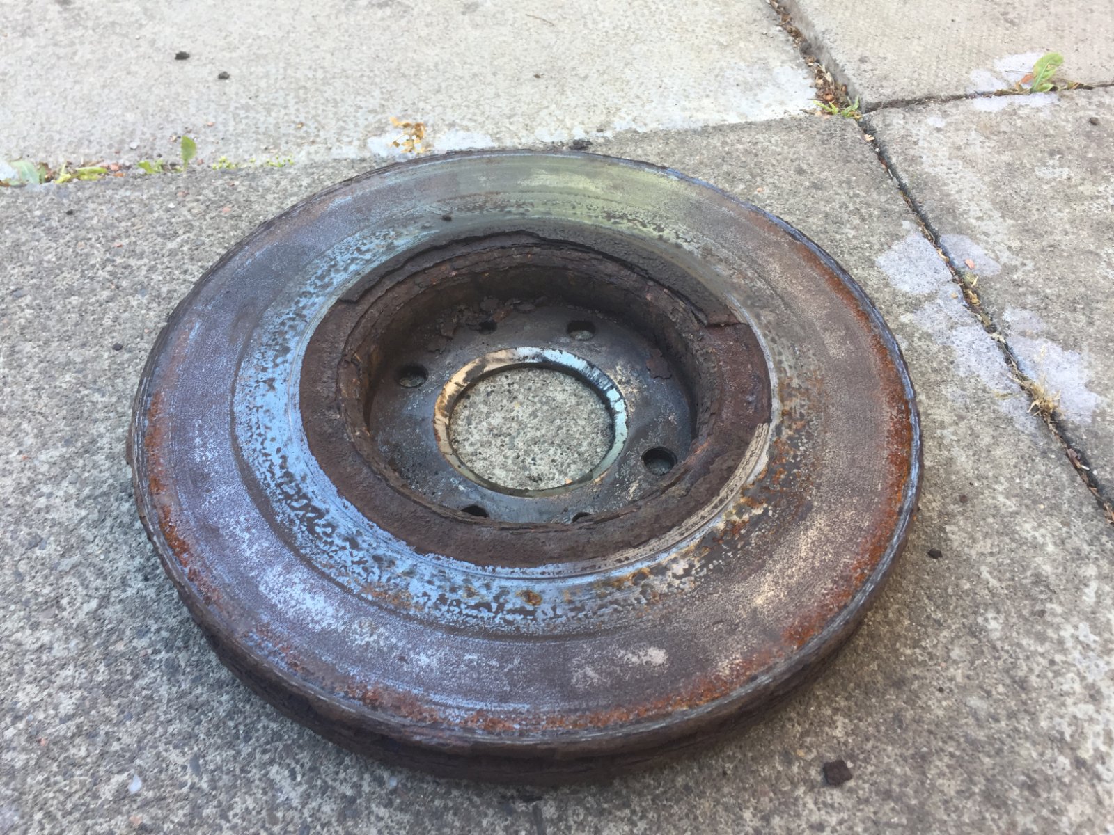

The good news is the brake work all went pretty smoothly on Saturday. =D>
Sure enough, the old pads were down to about 3mm of material and the discs were pretty awful, especially around the inside:
The pad carrier whose two mounting bolts I thought might be troublesome to get out on the left hand side wasn't. I just used my large torque wrench (as I don't have a breaker bar) and my standard T55 socket, no problem. They were a bit tight all the way out but once I cleaned the threads in the hole they went back in easily finger tight.
The old pads were wedged into the carrier so tight (rusted ?) that it took a cold chisel and some destruction of pad material to get them out! On the contrary, the new pads were an absolute perfect fit, snug, but I was able to push them back and forth freely just with my fingers. (Unlike the pads that I fitted to the Ion recently where I had to file the ears down quite a bit to get them to fit at all!)
For £15 a disc and about £30 for a full set of pads I'm very happy:
As I mentioned in the other thread, the rear brakes needed a clean and overhaul as well, and the pad locating pin snapped on one side when I tried to remove it, so I bought the little kit that has the pin, nuts, washers, spring clip and stone shield for both sides, on the assumption that the other side would break when i tried to remove it - which it duly did! #-o
Unlike the first side where the pin broke close to the nut making it easy to remove, this one broke half way up the pin, making it impossible to directly extract the pin as the nut was rusted on and difficult to access. [-X
In the end I gave up on any fancy tricks and just used a claw hammer to progressively bend the nut/pin at the blind end util I could thread the now semi-circle pin out the wrong end. :lol: That pin is as soft as butter, it's no wonder it snapped once the nut rusted to the housing!
Both pads on that side were rusted to the housing so out they came, everything cleaned up then back in again with the new pins and shields, and brakes bled. Only a little bit of air from the rear brakes.
I took it for a drive expecting it to take a while to bed in (the Ion brakes did) but no, they were working reasonably well immediately which has not been my general experience with new brakes, and within about 10 miles of driving with a few quick stops they felt fully broken in.
And all I can say is WOW, are these brakes good now! :-D Best Xantia brakes I've ever had by far. Previously they were "OK", but they did vibrate when braking from high speed if they were hot (probably all that rust around the middle) and they just didn't seem as sensitive as they should be. A bit "dead" feeling and requiring quite a bit of pedal pressure. I had a similar issue on my old 2.0i which despite lots of work on the brakes never felt right.
These are now really, really impressive. Instead of getting nothing as you press the pedal harder then too much braking, they start responding very smoothly and gently at first but rapidly brake very hard as you push the pedal harder. Very controllable, sensitive, and immense stopping power when you push a bit harder. Very happy. =D> Hopefully it'll wind the needle off the brake tester at the garage during the MOT. :lol:

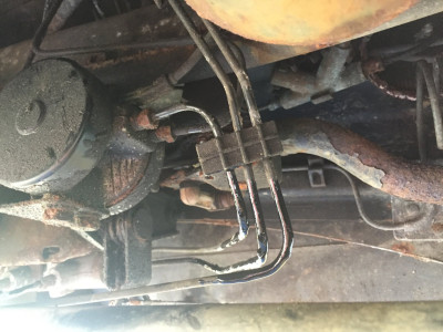

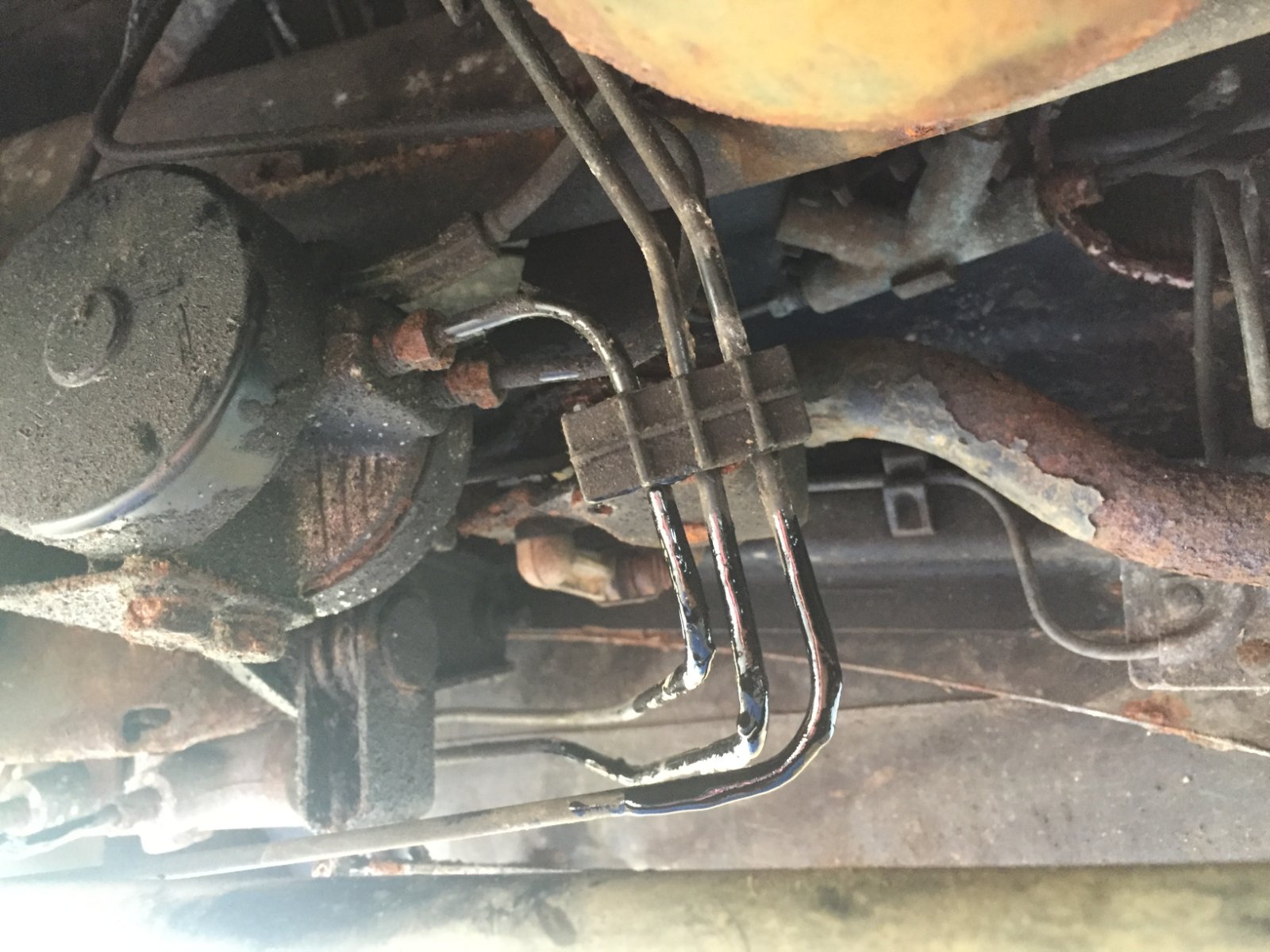

While I was under the car I noticed two annoying things. One was that one of the brake/suspension lines under the rear beside the height corrector looked like it had literally exploded with rust at a bend! :shock: I realised it would get spotted in the MOT as it was in a really obvious place and looked bad so I bought some black hammerite to sand and paint it. I was actually concerned enough about the remaining steel left that I was unwilling to sand the pipe while the car was pressurised - so I fully depressurised the suspension and pressure regulator before attempting to sand it just in case so I didn't get an eye full of high pressure oil... :lol:
While I was at it I did quite a few other spots where it was starting to rust on bends - it seems like the enamel must have cracked on some of the bends ever so slightly when manufactured allowing water in to eventually rust them. All tided up now though and protected from getting any worse:

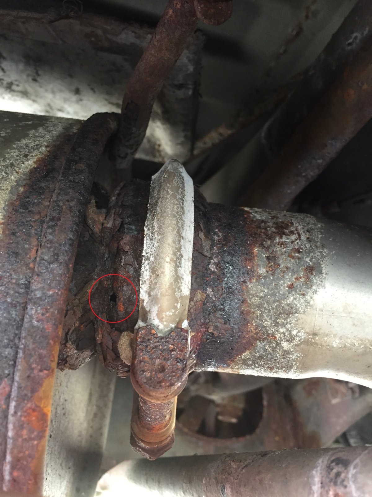

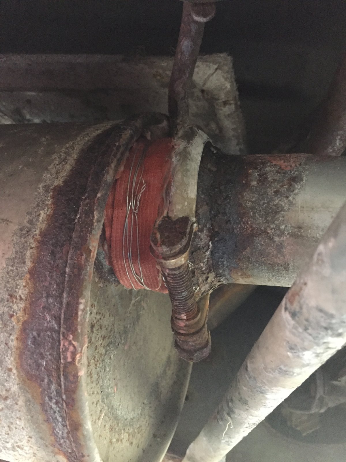

I then noticed one other problem that I wasn't expecting - a noisy hole in the exhaust that I only just replaced less than 4 years ago! :evil:
To be fair, it was only a cheap £70 exhaust, and the car has sat a lot in the last year which is never good for exhaust rust due to pooled condensation sitting in the pipes.
You can't hear it while driving but certainly can from outside near the rear of the car, and I'm sure it will get bigger quickly...so I'm now faced with a dilemma. I want to book it in for an MOT in 2 weeks but do I:

Well done on the brakes, Simon. Reward in itself!
It all looks very dry under there, and ought to have a good waxing - especially those hydraulic pipes.
Best time of the year to do it.

DHallworth wrote: 04 Jul 2018, 22:21 I bought one of the cheap polish exhausts for the Activa with the wonky tips as I'm intending to get it a stainless exhaust made up. Other then a wonky tip, it was very easy to fit and sounds quite good. I'm sure it was around £65.
The exhaust that's on the car now is one of those same Polish ones, I think I paid £70 for it. If you recall, you and your 208 pal helped fit it for me - must have only been 3 years ago or less as I've only had the car since mid 2014. I remember that the hangers needed bending a bit, also that the angle of the bend on the pipe where it goes onto the rear silencer wasn't quite right, causing some sealing difficulties at the rear muffler joint which I had to reseal about 6 months later but maybe that was a one off manufacturing error when doing the pipe bends.
Looking at my ebay history the exhaust I linked to a few posts ago does indeed seem to be the same one from the same guy - Tomasz Gerlach. When you check the address on Google street view it's a medium size barn similar to your dad's garage in the middle of the country surrounded by farmland, so I can only assume based on the huge number of different exhausts he lists for sale and the 3 week delivery time that he just makes the exhausts to order and then ships them. :lol: I contacted him by ebay and he said he has sold a few Xantia V6 exhausts and not had any feedback about alignment issues.

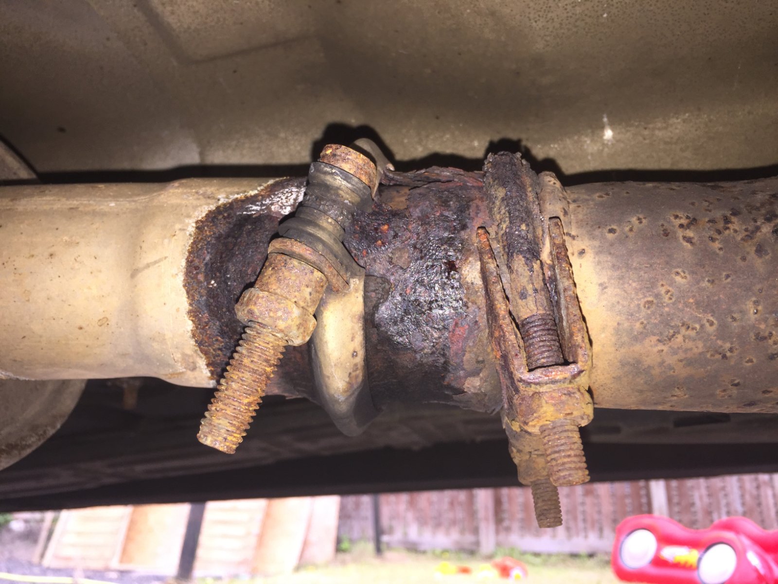

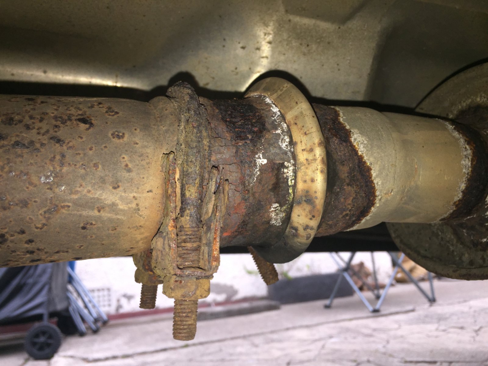

I hope yours lasts better, mine is rusted pretty badly now at the muffler joint and also at the cat joint:
The outer sleeve of the cat tail is rusted away on one side, so there is not much holding it together now, although remarkably it isn't leaking at all. Because this cat tail is going to require some work to fit a new exhaust I've decided to go for a temporary fix for the MOT leading to....

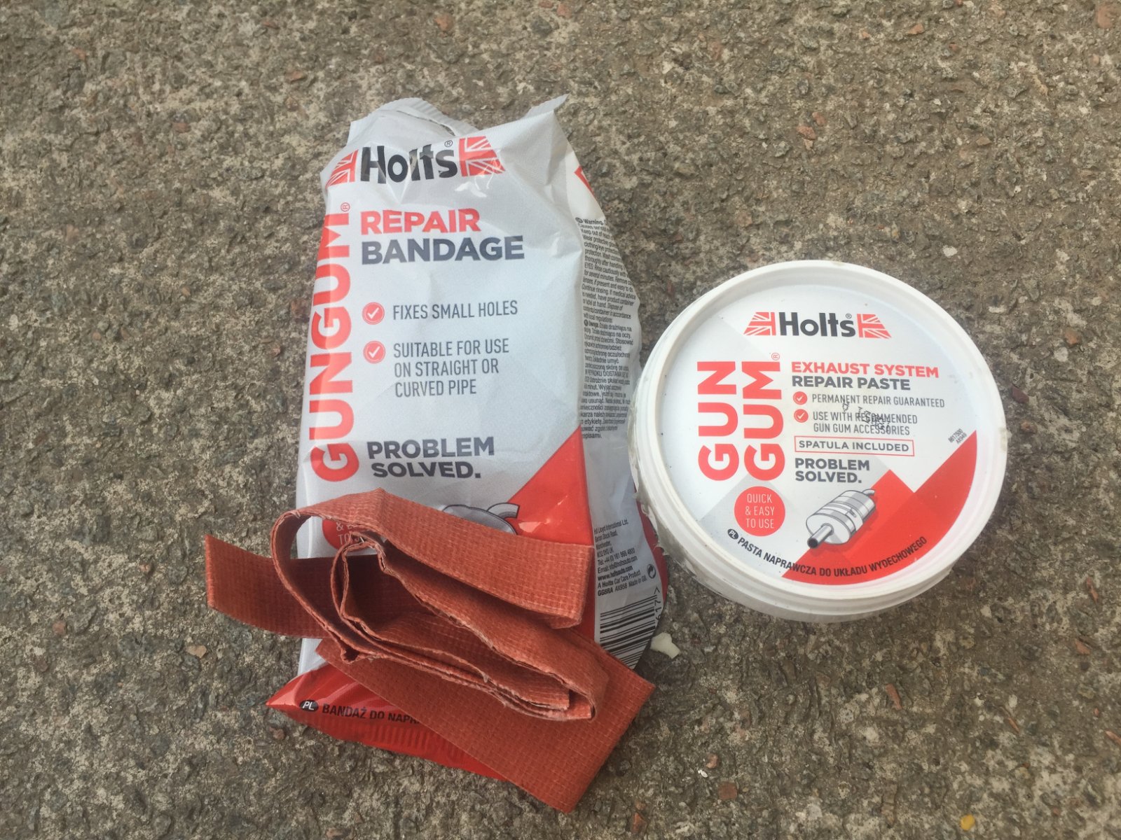

If I were you, as s short term measure, I'd get a tin of gun gum from Halfords or the likes and spread it around that hole. Wear gloves as it really sticks to your fingers! Get a good thick layer of it on it and leave it for a long while to Harden before you start the car so it doesn't blow through it and it should be fine if driven gently to the MOT :)
I must have read your mind. :-D The night before you posted that I went to halfords to get both some gun gum and a bandage:
I've tried the bandages before on their own and they don't work for this kind of hole as the surface isn't flat, but I was also concerned that the gun gum by itself would blow out in a relatively short time, so I combined the two. I put loads of gun gum around the area of the hole and a coating all the way around the circumference of the pipe as well, then I fitted the bandage around it as well:
I let the car idle for about 30 minutes to heat up the pipe and allow both the gum and the bandage to set, plus I was going to give it a couple of days before trying to drive it. It's completely silent at the moment but I won't know until I've driven it how well it might last.
With that silenced I've now discovered that there is a slight exhaust blow under the engine bay somewhere. :( It's not at the front downpipe, I think it may be the rear downpipe from the rear bank but I haven't had a chance to look yet, but it's minor so hopefully won't get picked up. [-o<
After mostly driving an EV for the last year and doing all the high mileage in it and doing nothing to it other than brakes, I'd forgotten how much I hate dealing with exhaust problems! :evil:
This patch will hopefully get me through the MOT but I think I'll have to order another exhaust from Tomasz and fit it later this year - I'm just a bit scared of running into problems trying to figure out how to couple it to the cat when half the cat tail outer sleeve has rusted away.
On my old V6 the outer sleeve broke cleanly off, and I then ended up hacksawing some slots in the pipe from the centre silencer and using a standard U-bolt clamp onto the main inner cat tail, which seemed to work! :lol:
However with half of a rusted outer sleeve still present that would get in the way of the U-bolt.
