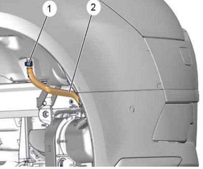

Hello Marc and colleagues,
Do you think it is possible to change the LDS fluid in some different steps?
For example, instead:
# Start the engine.
# Place the suspension height control in the "LOW" position.
# Stop the engine.
# Raise the vehicle and support on axle stands, wheels free.
# Open the LDS fluid reservoir cap.
Remove:
# The front right wheel
# The front right mud guard
# Remove the collar (1) Using tool [1].
# Uncouple the hose ( 2) from the LDS fluid reservoir.
# Drain the LDS fluid reservoir.
Can I do the following:
# Start the engine.
# Depressurise the hydraulic system via Diagbox.
# When done, disconnect the battery.
# Use a jack and raise the right wheel.
# Unmount the right wheel and the mudguard.
The difference would be instead of lowering the suspension, I want to depressurise it via Diagbox and use just the car's jack. What it's confusing to me is if after lifting the car on a jack, some LDS can go back from the tank into the spring cylinder.
What do you think?
Thank you very much,
Vlad.

Re: Citroen C5 - Changing LDS fluid
There's nothing wrong with doing that Vlad, - although in the instructions - BEFORE you unclip the collar at 1, you need to clamp the hose at 2 first, otherwise all the LDS will come gushing out as soon as you remove the collar as the LDS is still under some pressure.
Clamp the hose, remove the collar, get your bucket and then unclamp the hose:
If you are going to fully depressurise using Lexia, you will probably need to apply pressure to the tank 0.5 bar as per my other post you've just 'liked'

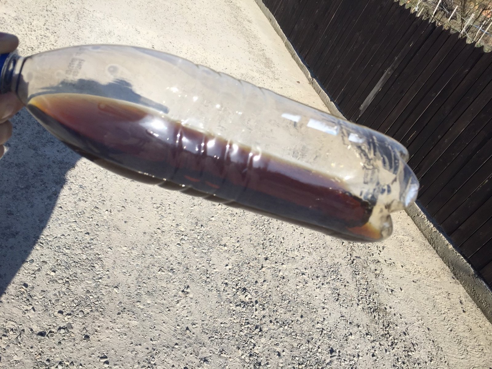

Yes, that LDS you took out in the picture looked pretty black to me Vlad, so even 80% new will be better than that.

Black LDS? that doesn't sound good
vladd.alex
- Posts: 71
- Joined: 06 Jan 2014, 18:34
- x 4
Hmm, not really black but far away of red...Looks like Coke.
