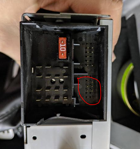

Display has arrived and everything is working well.Now im interested how to connect microphone,I have mic in car from old kit it has 3 seperate wires.This is how its look from rear side(aux is connected).

Ok, so for the standard Mic (which says not fitted in your 307 as standard kit), this is the RD45 pin-out for the MIC. I've used your picture and circled the correct block - channels are below:
"ac" Natural 12-way connector
| Channel number | Allocation of channels of connector |
| 1 | Channel not connected |
| 2 | Channel not connected |
| 3 | Audio/telephone microphone earth input |
| 4 | Right-hand audio auxiliary |
| 5 | Channel not connected |
| 6 | Channel not connected |
| 7 | Channel not connected |
| 8 | Channel not connected |
| 9 | Audio/telephone microphone signal positive input |
| 10 | Left-hand audio auxiliary |
| 11 | Audio earth |
| 12 | Channel not connected |

Thank you very much.I have connected mic as that instructions everything is working good but other person hear it self when talking,I havr tested viber call..

As for the microphone, is it an original PSA one or an aftermarket one?

Perhaps your microphone is too sensitive or in the wrong place for the echo-canceller in the RD45 to work well?

That MIC may not have noise cancelling features - which is why I asked, so may be the cause of the issue.
