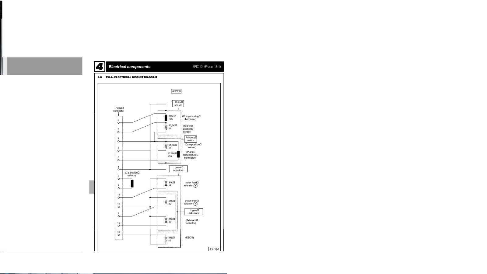

The round plug 'No. 2' is a different pin configuration, I'll have a look in the Epic manual, the others may be the same.
Pete
moizeau
- Posts: 1866
- Joined: 12 Jan 2015, 16:08
- x 429
Re: Xantia 2.1TD 1997 - Keypad/immobiliser
This is the pin out for the actual pump harness, not the vehicle harness. The stop solenoid is 12 and 13. The numbers are written on the plug.

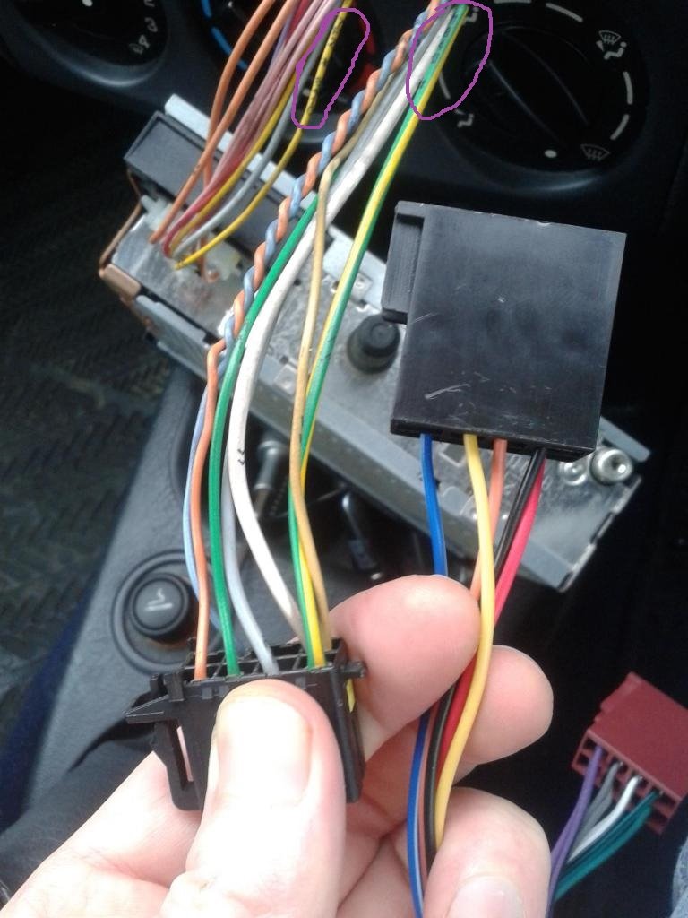

martin churchill wrote: 27 Jun 2019, 11:49 Thanks everyone for the information. The ECU pins I do not have numbers on that so if anyone has a pin layout with numbers it would be appreciated.
The ECU plug will have pin numbers on them, they can be very small & difficult to see but they definitely will be there. Sometimes only the first pin of each row has an identifier pin number then you have to count along to work out the others.
As for the wire codes, they are printed every couple of inches along the length of the wire & again can be difficult to see, sometimes needing to peel tape back a bit.
can be seen here on this radio wiring at the top of the picture, may need to zoom in.
