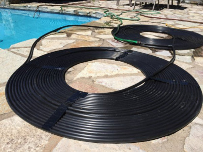

On a slightly different but similar subject I designed and built a simple pool heater for Ken's pool in Mallorca, using sunshine and copper pipes and making use of the existing filter pump system by diverting the output of the filter through the heat exchanger before returning to the pool. Control wasn't great but it did extend the pool usage period by a couple of months each side of the summer!! Not the greatest drawing but it should give you the idea!:-D

The same is often done here, Mick, but using 25mm black HDPE water pipe, laid out back and forth, or as a huge flat coil if there's room. The heat collected/transferred is considerable.
The coil, or laid-out pipe, can go somewhere less obvious, of course...
Black poly pipe can be as cheap as €30+ for 100m.
For DHW, these units sell for around €1000+. OK to put on any roof that doesn't get frost.
The unit then feeds a standard DHW (immersion heater) cylinder, which does little work.
