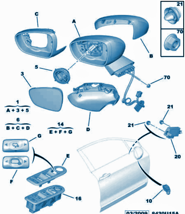

Could someone reupload that mirror removal guide? On mine other mirror is bit loose between mirror's foot and cover, so I think I have to remove mirror-glass and tighten screws inside mirror cover?
- x 6963

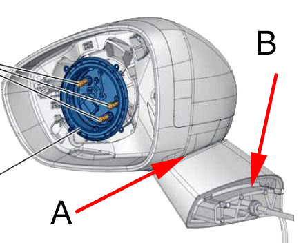

Re: Removing Wing Mirror Glass C5 2008 >
Where is it wobbling Marko? A or B?
- Posts: 9148
- x 1903
Ah, that's interesting as my driver's door mirror wobbles at B. I didn't realise it was a Citroen "thing".
Wobbles at A

Hello. I have a very wobbly drivers side wing mirror - I think it’s wobbly at point A as the post feels sturdy enough. Can is be easily cured? I have the most complicated wing mirror (heated, electrochrome, self indexing, folding) and I’m slightly scared of cracking it open and causing potential damage, unless I know I can stop the wobble.
It rather distracts from the closeting ride when it looks like there’s a earthquake happening behind you.
Any advice much appreciated!
- x 6963

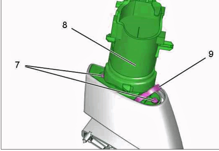

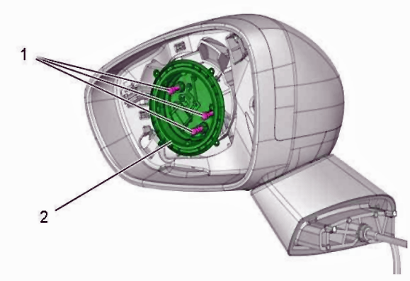

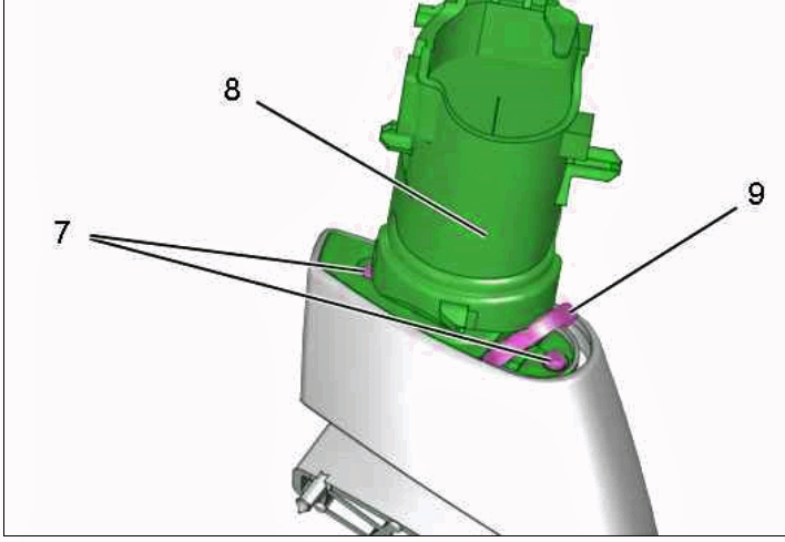

Indeed, at £940.28 for the top of the range mirror fitted to 2008 / 2009 models you want to be very careful. There is no easy fix, but if the wobble is at section A, the only possibility I can see is that there are 2 bolts holding this part on shown as item 7 on the third diagram. Whether or not that is the cause is impossible to tell without stripping the mirror off the car and taking it apart:
To get to the mirror mechanism, the door card needs to come away so that the securing bolts and connectors can be removed to release the mirror. Then all the shell components have to be removed to get to the orientation mechanism - not for the faint hearted. There is no guarantee that it is the bolts that have worked loose, but it is a likely possibility.
| X7 Wing Mirror Parts | Indicator Light Fitting | Securing Bolts (item 7) Orientation Mechanism (8) Protector (9) |

Brilliant. Thanks Marc. I’m not afraid of large scale disassemly but I like to have a grasp of the construction first so this is very helpful. It’s definitely the whole upper part that wobbles so I think your deductions are correct. I had the door car off yesterday as I was upgrading my speakers, but I think I’ll stock up on panel clips and let my nerves recover before I go back in again! If I manage to cure it, I’ll report back.

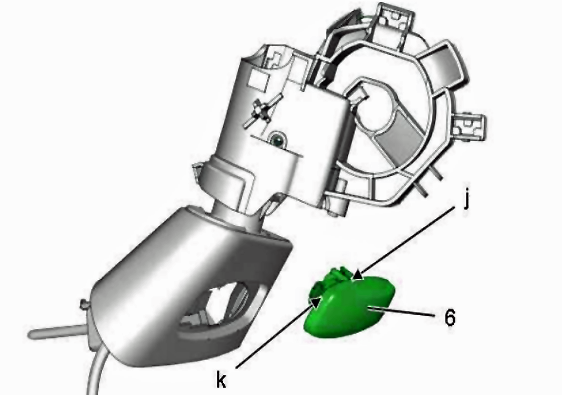

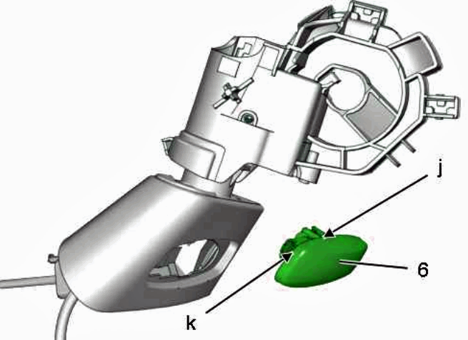

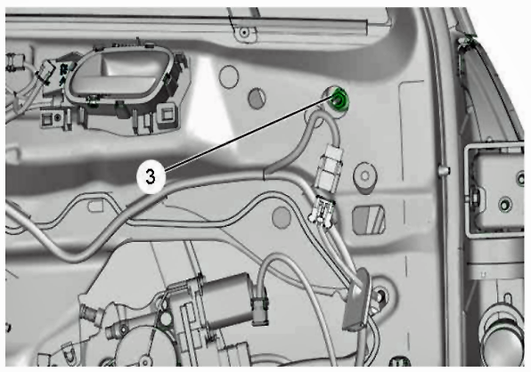

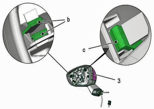

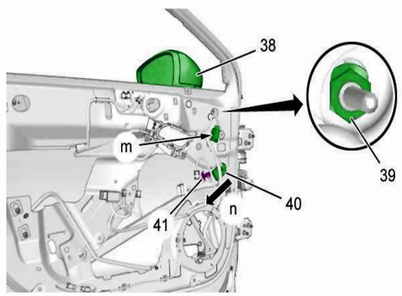

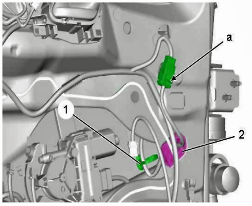

Here you go, a little more detail:
| Release and disconnect: The connector (at " m"). Unclip the clip (41); Using tool [1]. Detach: The grommet (40) (following " n"). Remove: The (39) bolt The rear view mirror (38) | Unclip the clip (1) ; Using tool [1]. Detach: The grommet (2). Unlock and disconnect the connector at "a". |
| Remove the nut (3). | N.B. : Identify the passage of the exterior mirror harness to the interior of the front door before removing the exterior mirror . Remove the mirror (4). Essential: Always replace the damaged fixings. Proceed in the reverse order to removal. Tighten the bolt (3) to 1,2 ± 0,3 daN.m. Check all the equipment works. |

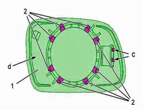

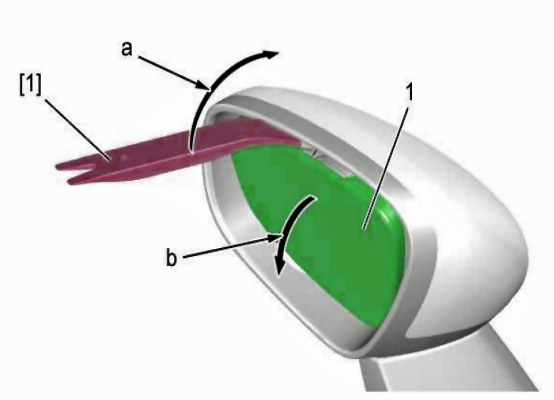

| Adjust the position of the exterior rear view mirror glass (1) (At "b"). Pass the tool [1] behind the glass of the exterior mirror (1) applying force to the tool [1] (At "a"). | Unclip the fixing lugs (2) of the glass of the exterior mirror. Disengage the glass from the exterior rear view mirror (1). Unplug: The electrical connections ( as "c", "d")(according to equipment). Remove the exterior rear view mirror glass (1). Refitting Proceed in the reverse order to removal. Check the electrical operation of the exterior rear view mirror (according to equipment). |
| Remove the bolts (1). Disengage the exterior rear view mirror glass motor (2). | Unlock and disconnect the connector at "a". Remove the exterior rear view mirror glass motor (2). |

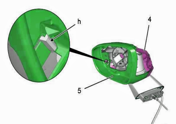

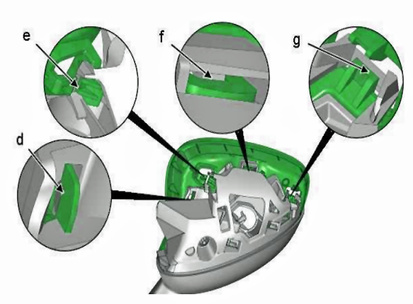

| Unclip the fixings (At "b" and at "c"); Using tool [1]. Detach: The exterior mirror shell (3). | Unclip the fixings (At "d", "e", "f" and at "g"); Using tool [1]. |
| Detach the fixing (at "h"); Using tool [1]. Remove: The half shells (4), (5). N.B.: Locate the routing of the electrical harness . | Unclip: The repeater (6) (at "j"); Using tool [1]. Detach: The repeater (6). Release and disconnect: The connector (at "k"). Remove the side repeater (6). |
| Raise: The protector (9). Remove the bolts (7). Detach - Remove: The orientation mechanism (8). | Trim Cover |
