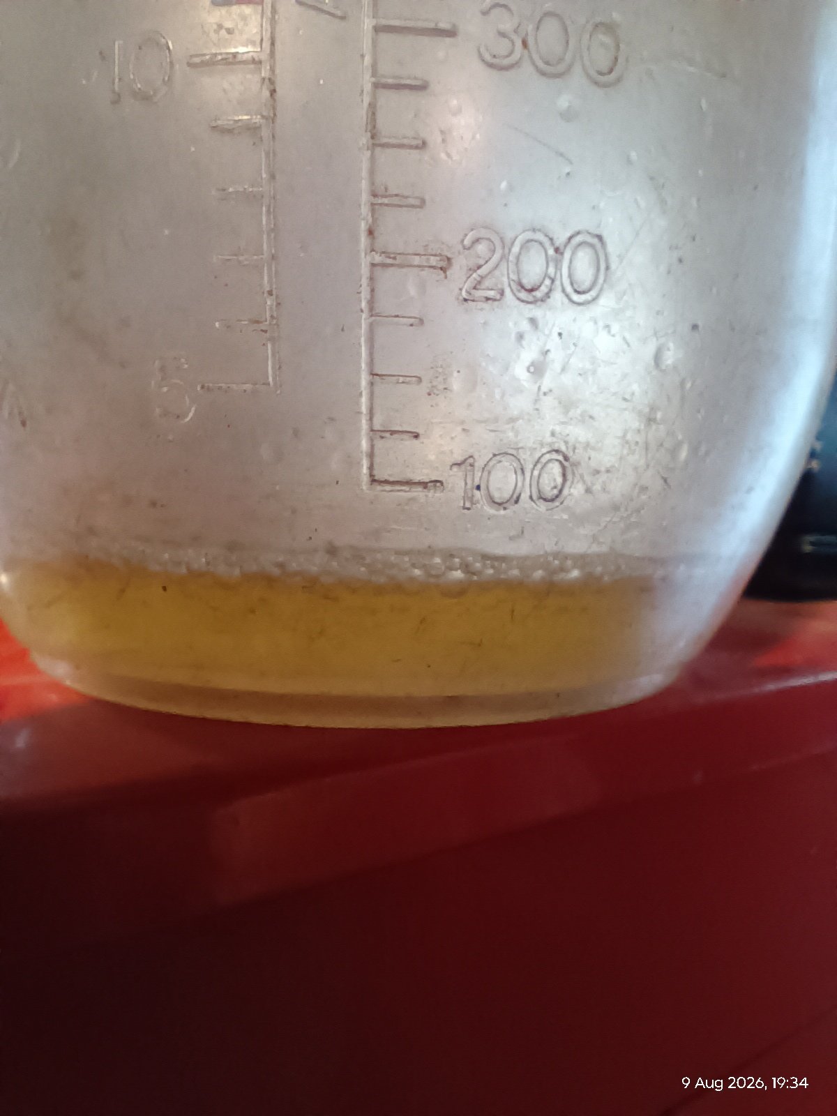

So, going to get some Wynn's Crystal Clear and Protect (anti crystallisation stuff) into the new car's Adblue system.
As per:
viewtopic.php?p=859869&hilit=Wynns#p859869
17 litre car tank.
500ml/45 litres x17 = 189ml.
As I've already treated my new bottle of Adblue, this will be a slight overdose of the stuff, but am sure it'll be fine :)

Or, it seems more like 75ml will have to do for now! That's my Wynn's bottle empty!

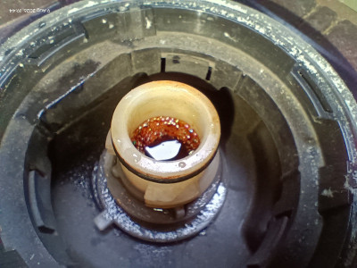

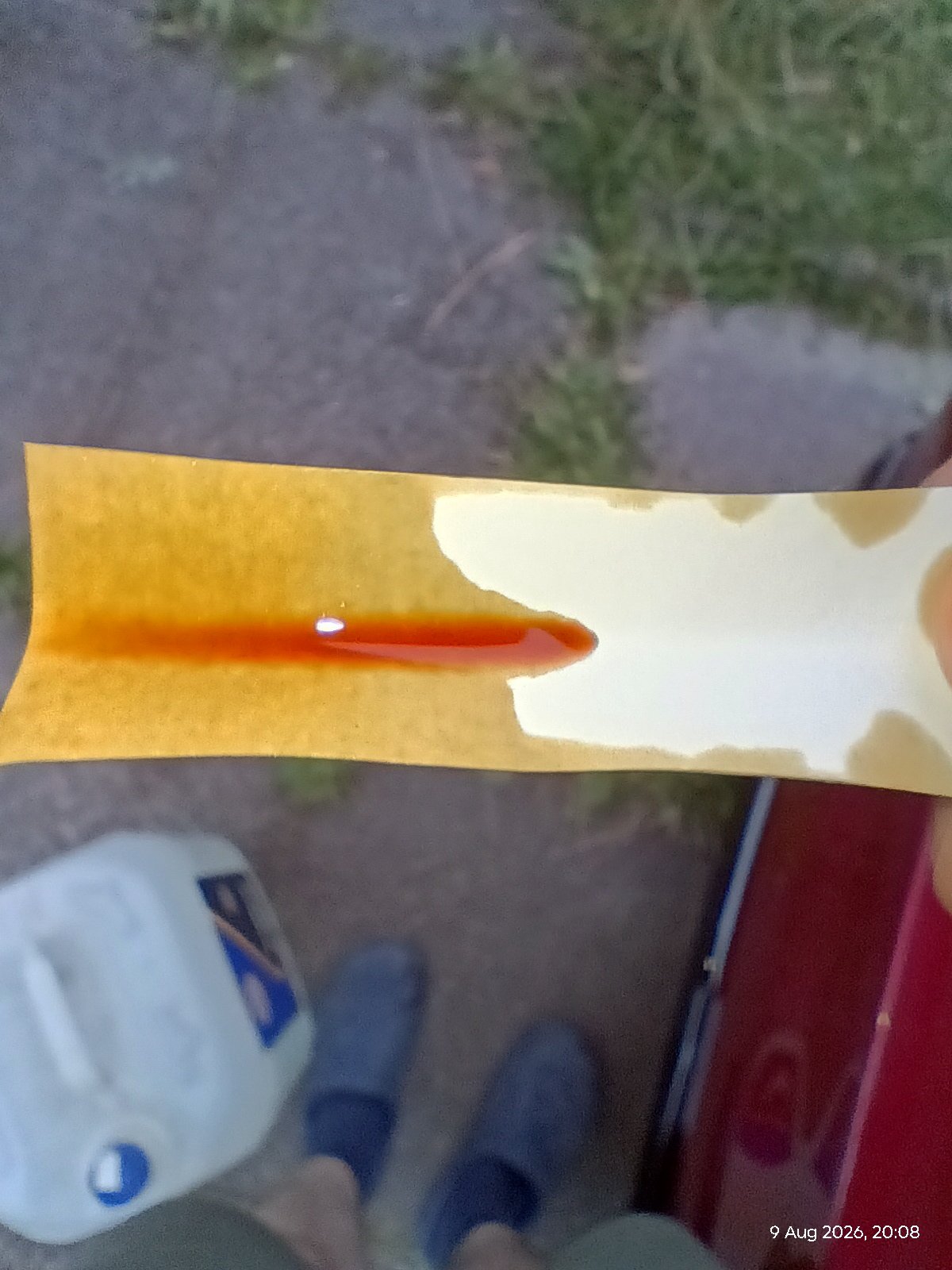

Though speaking of odd colours!! Ice topped the tank up with additive then fresh Adblue (pretty much colourless) this is a surprise:
A VERY red tinge to the tank contents!?!?!

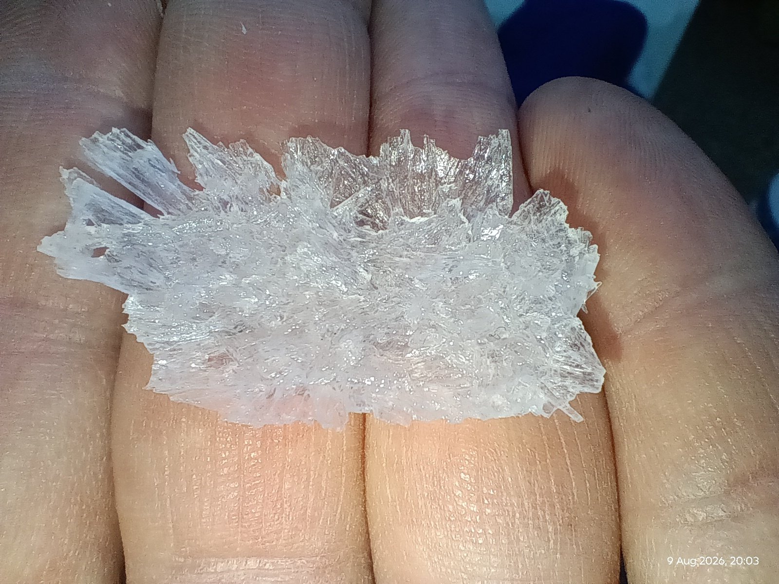

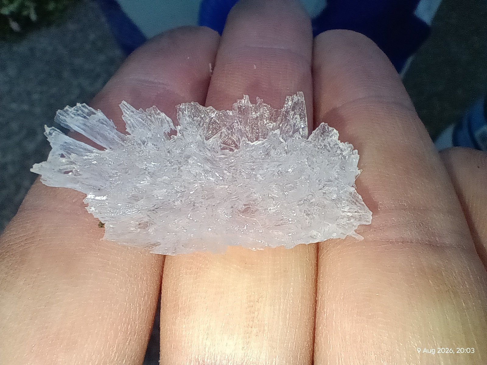

White piece of paper dipped into the adblue tank contents:
Red
Red
Very red!
Real sinking feeling that I know what is this colour
Spoiler: show
eolys / "PAT fluid" i.e. goes in the DPF additive tank, not the Adblue tank!
Wynn's treatment+ Adblue are the only products that have been in a long spout funnel I bought specifically for that task.
This deposit/ megs crystal goes not fill me with confidence in the Wynns stuff!
