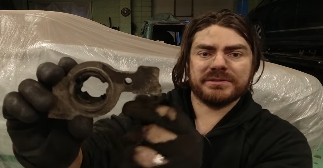

On the video above, 19 minutes in he has an excellent description of the differences between the 407 and C6 bushes.
Quick screen grab from the video. Seemed rude to crop out the man himself!
The that bush is visibly different in height either of the two above! So there's at least three types of bush to be aware of!

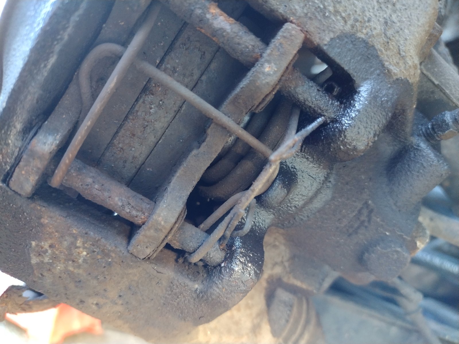

MattBLancs wrote: 19 Dec 2023, 11:33 Image
Those pad retaining pins could still put up a fight Matt, unless they're already out... They did in my AX, so much so that I got new calipers...

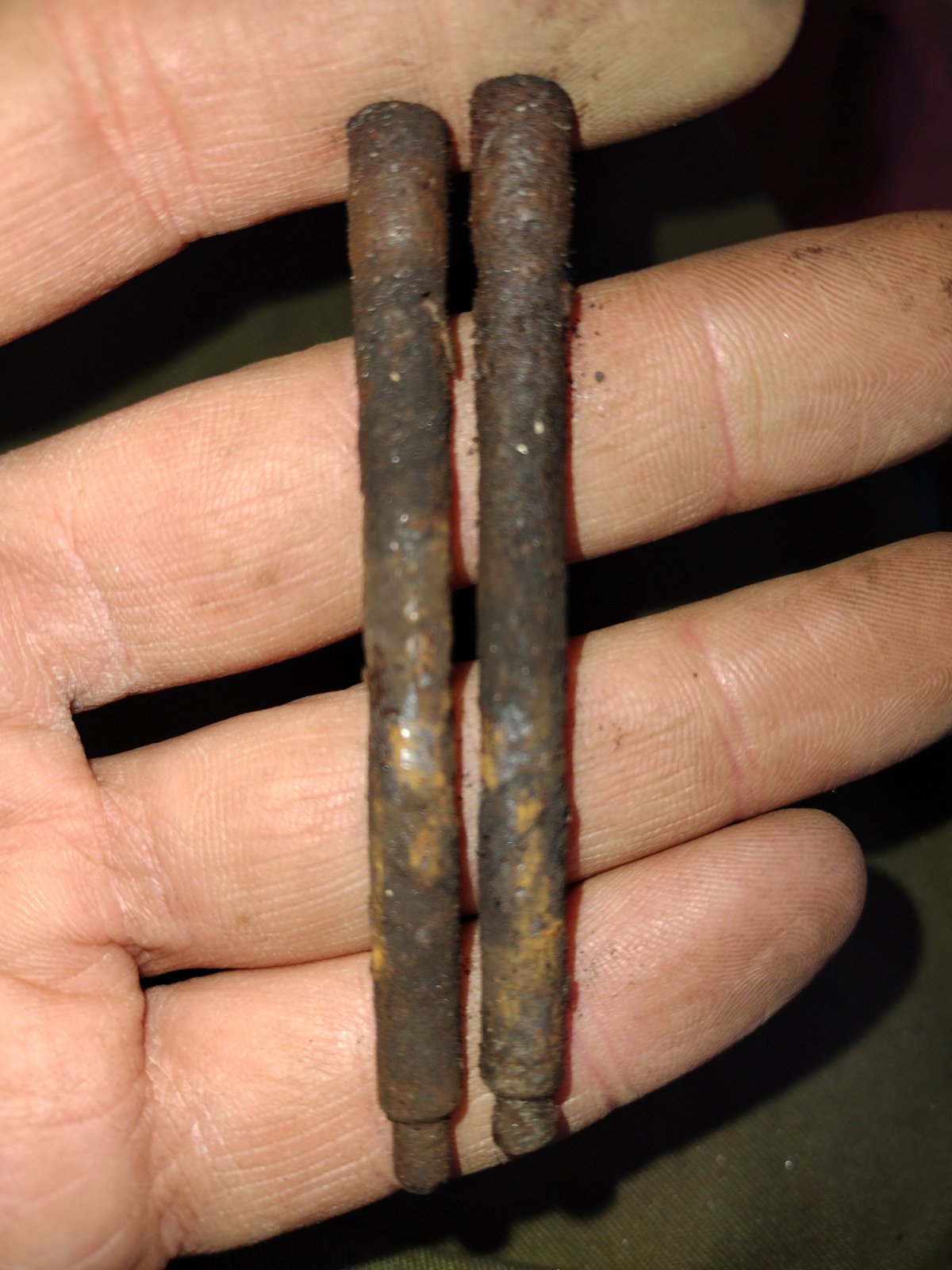

CitroJim wrote: 19 Dec 2023, 14:51
Pins: Nil, man with hammer + pin punch: 2 :-D
Quite surprised as they looked grim and likely to be a battle.

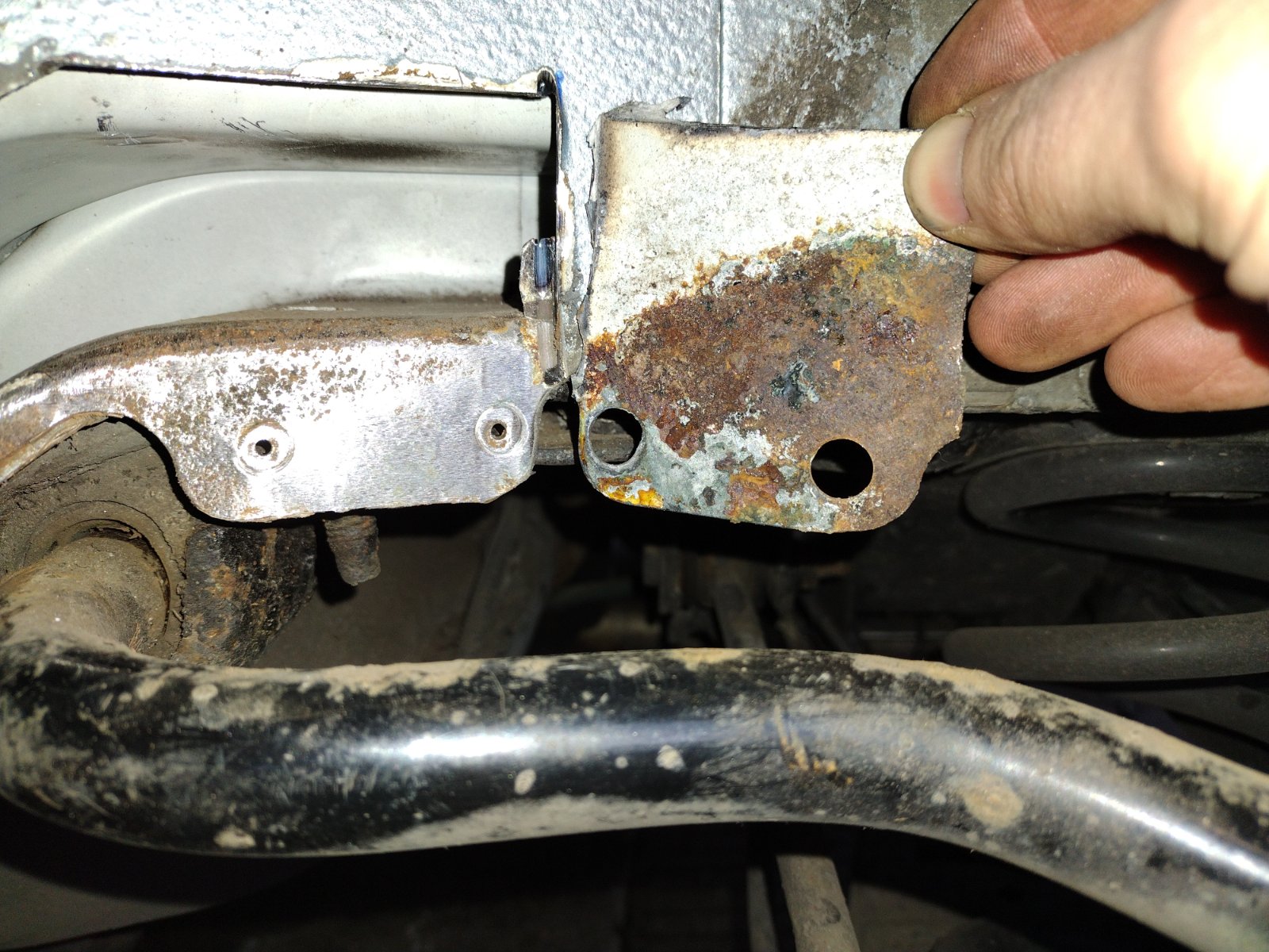

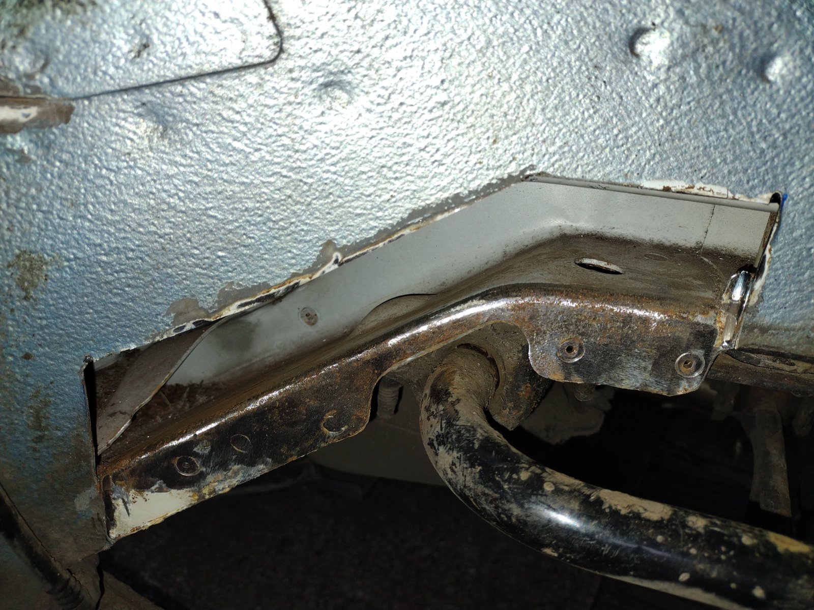

The pins in all their glory:

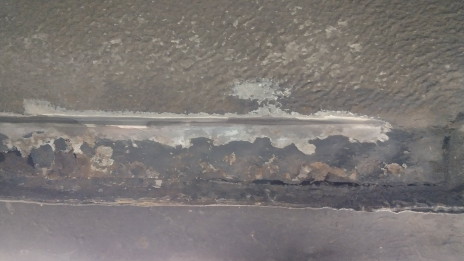

So the little hole near the anti-roll bar has escalated a touch....
Piece of metal in my hand is reversed piece from the two matching spot welds on the car

Those pins look super crusty Matt!
Funny how seemingly small patches of rust have a rotten habit of growing like Topsy :twisted:
Posts: 5101
Joined: 25 Apr 2022, 09:03
x 2227
Unread post by MattBLancs »
CitroJim wrote: 19 Dec 2023, 17:11 Those pins look super crusty Matt!
Yep, can see why I was fearing the worst!
Suppose it's about typical, I have new calipers ready to fit, so what otherwise would have been a big issue if they had been stuck fast, unusually wasn't an issue - so they "decided" was no point seizing after all! :)
Definitely from the inside, out in this bit, so I guess is to be expected.
Will be adding a nice point (covered with a blind grommet) to squirt some waxoil in as part of the fix

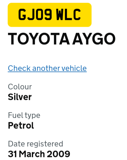

Post has arrived, oh no I have failed to pay the Dartford crossing charge, which I apparently went over on the first October this year in the C5!
Thankfully they have included a picture of "me" in the act of this awful misconduct...
Spoiler: show
Amazing how different an enormous black estate car looks when photographed from above, almost say, Aigo sized...
Posts: 5101
x 2227
It gets weirder!
Spoiler: show
Interestingly the website seems to have no method of disputing this, so would need a 0300 number based argument.
Spoiler: show
it's a C not an O at the end of that plate

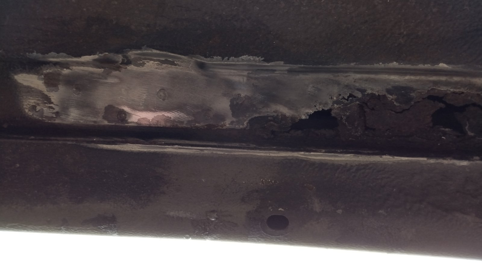

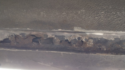

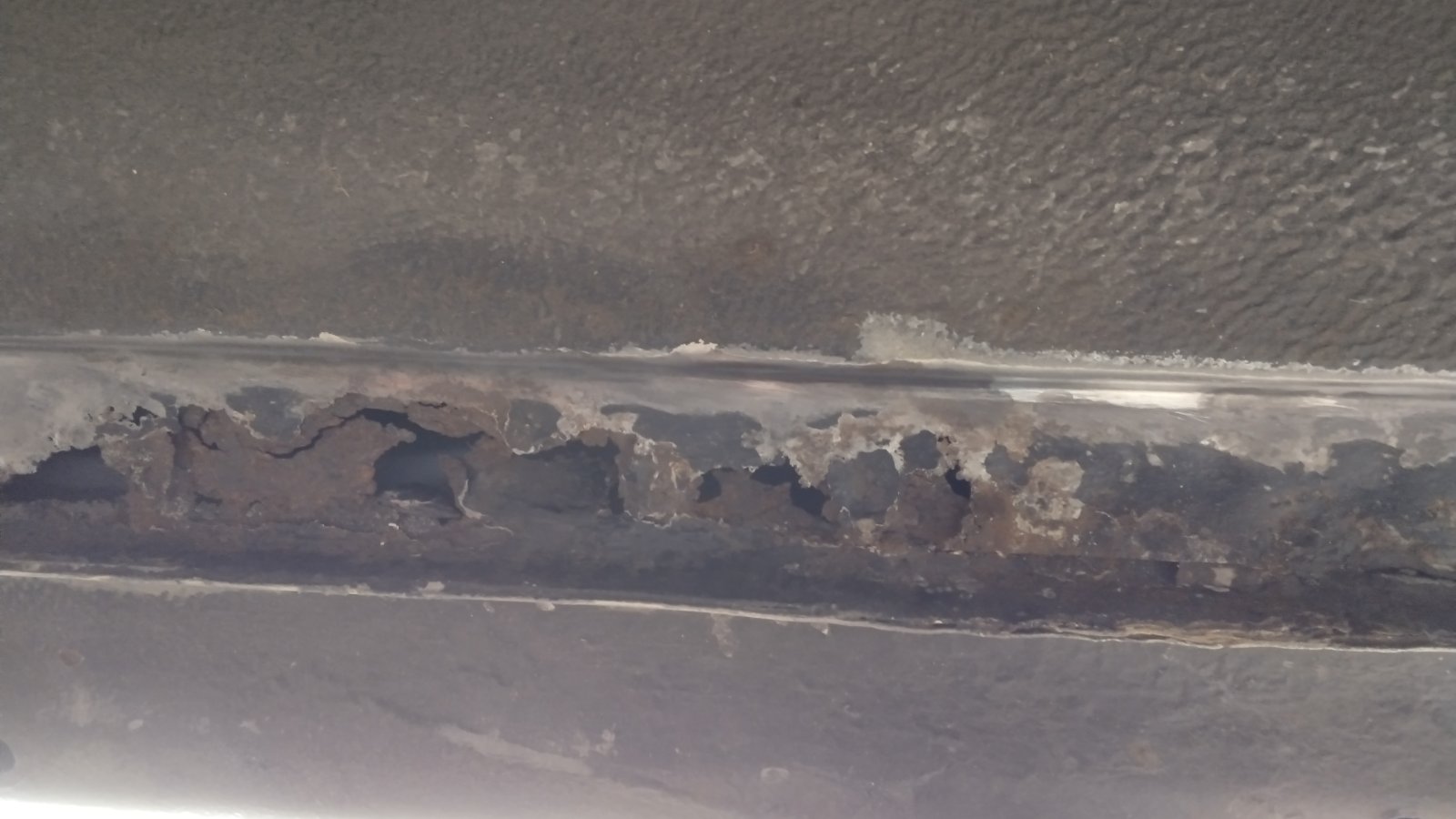

Rp0thejester wrote: 19 Dec 2023, 13:58 I'm surprised at the amount of rust for the age of the vehicle

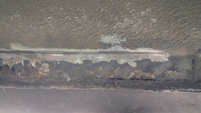

I hope you are sitting down, a "slightly more enthusiastic** tapping" still with a small hammer, further down the floor where it meets the cill has revealed:
Spoiler: show
much more work to be done.
** enthusiastic really not the right word given what it reveals!

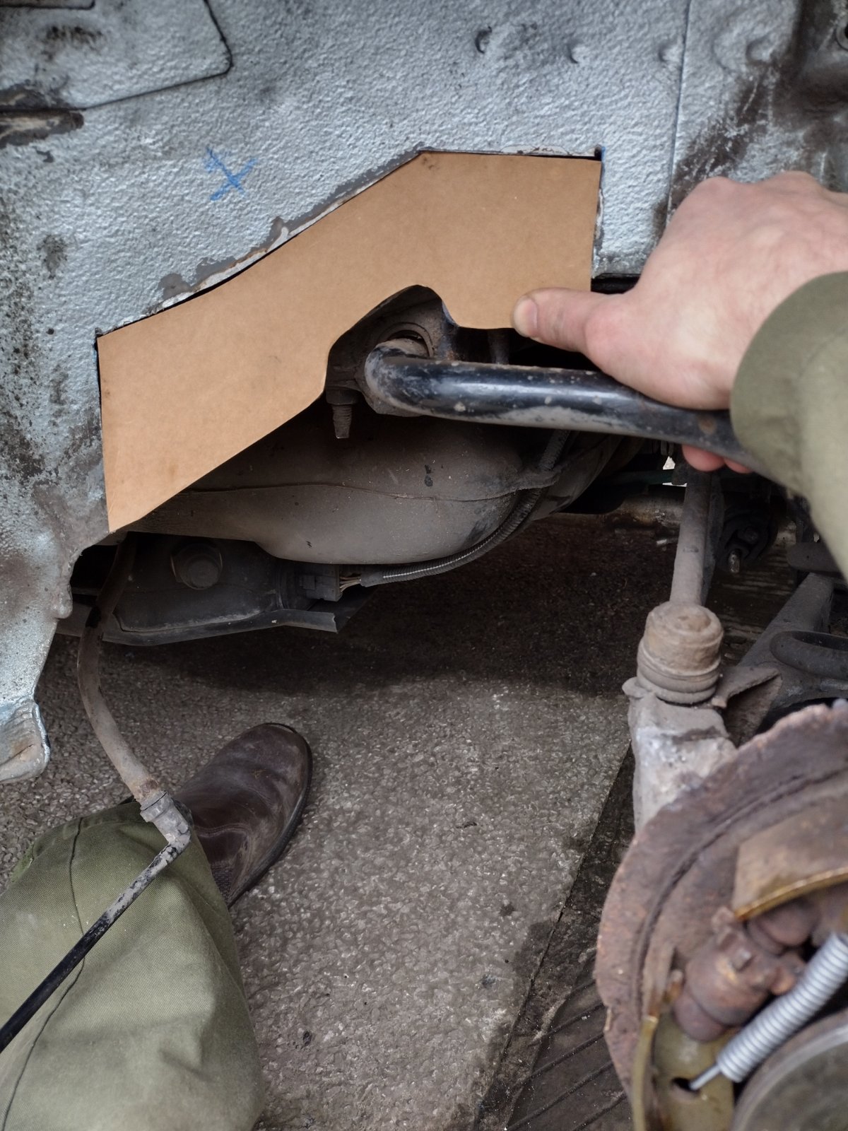

A bit of CAD on the go:
Cardboard Aided Design
