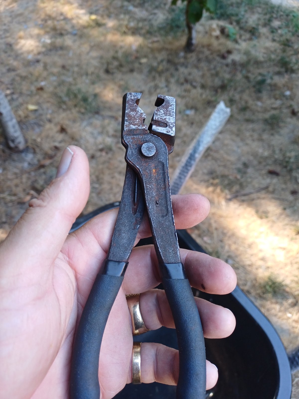

I have managed to do the proper clip without the proper pliers - a pair of nail pulling pincers can stand in fairly well.
I'd thought of using jubilee clips - but it depends on what hub clearance there is (pretty tight when I've been considering it) the bulk of the worm drive bit cleared ok on the Cactus = good to know.
I've recently bought some cheap "dedicated" CV Clip Pliers, but yet to actually christen them! I think I've some metal clips stashed somewhere, so long as I can find them, a proper fix is imminent

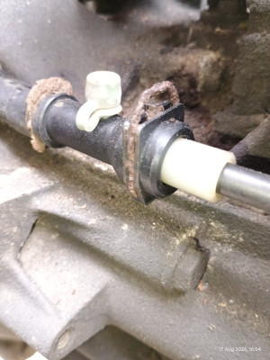

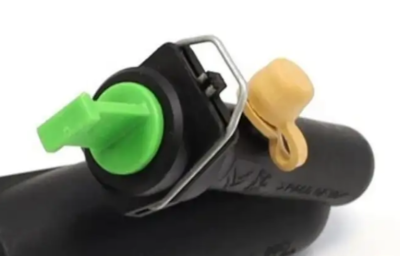

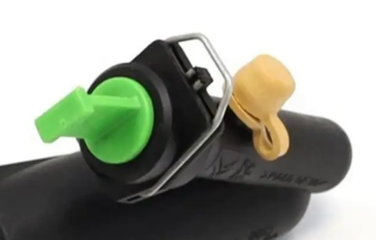

Any recommendations for the clutch bleed retaining wire clip? The red 308's item is just a thin rusty shadow of it's former self!
This sort of thing, I think:
https://ebay.io/m/MpxMH0
(Quick search result for "Peugeot clutch clip" )
Something like this :
Nicked from: https://www.peugeotforums.com/threads/3 ... um=organic

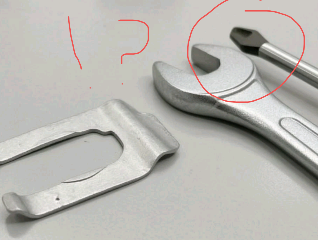

Or specifically, looking a lot less like this:
Posts: 20810
x 8012
Posts: 5192
Joined: 25 Apr 2022, 09:03
x 2272
Unread post by MattBLancs »
Precious little dimension data on that Mick - but it looks quite big. In fact looks more like a brake pipe retaining clip to my eyes. Do I spy an AI
"spewdliwer" ???

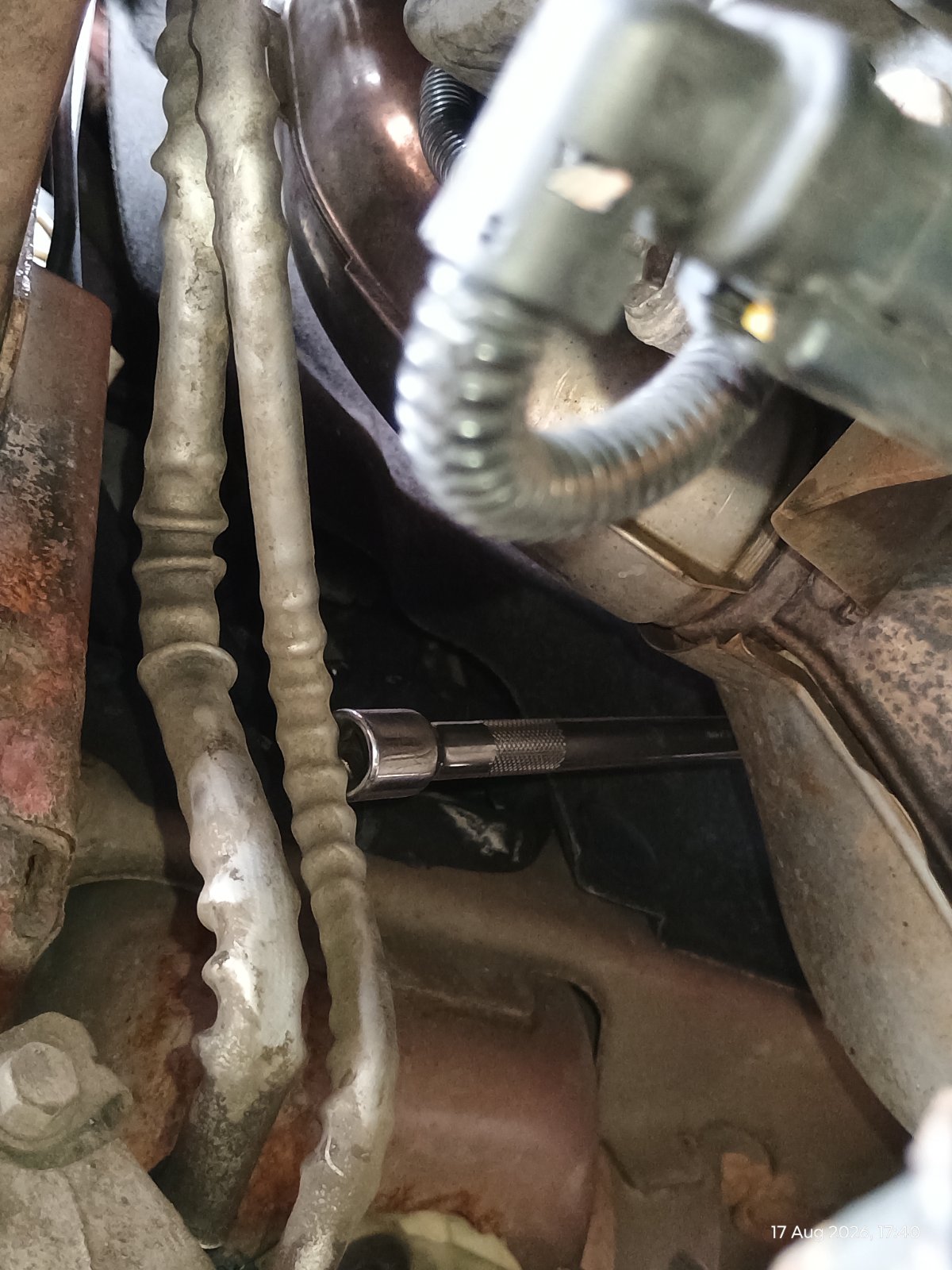

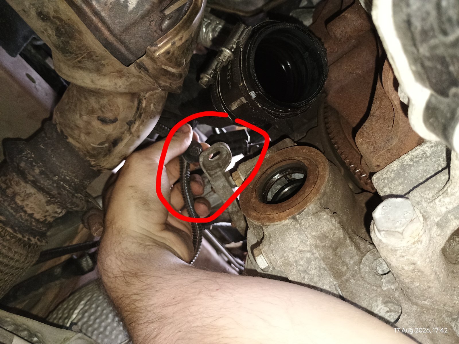

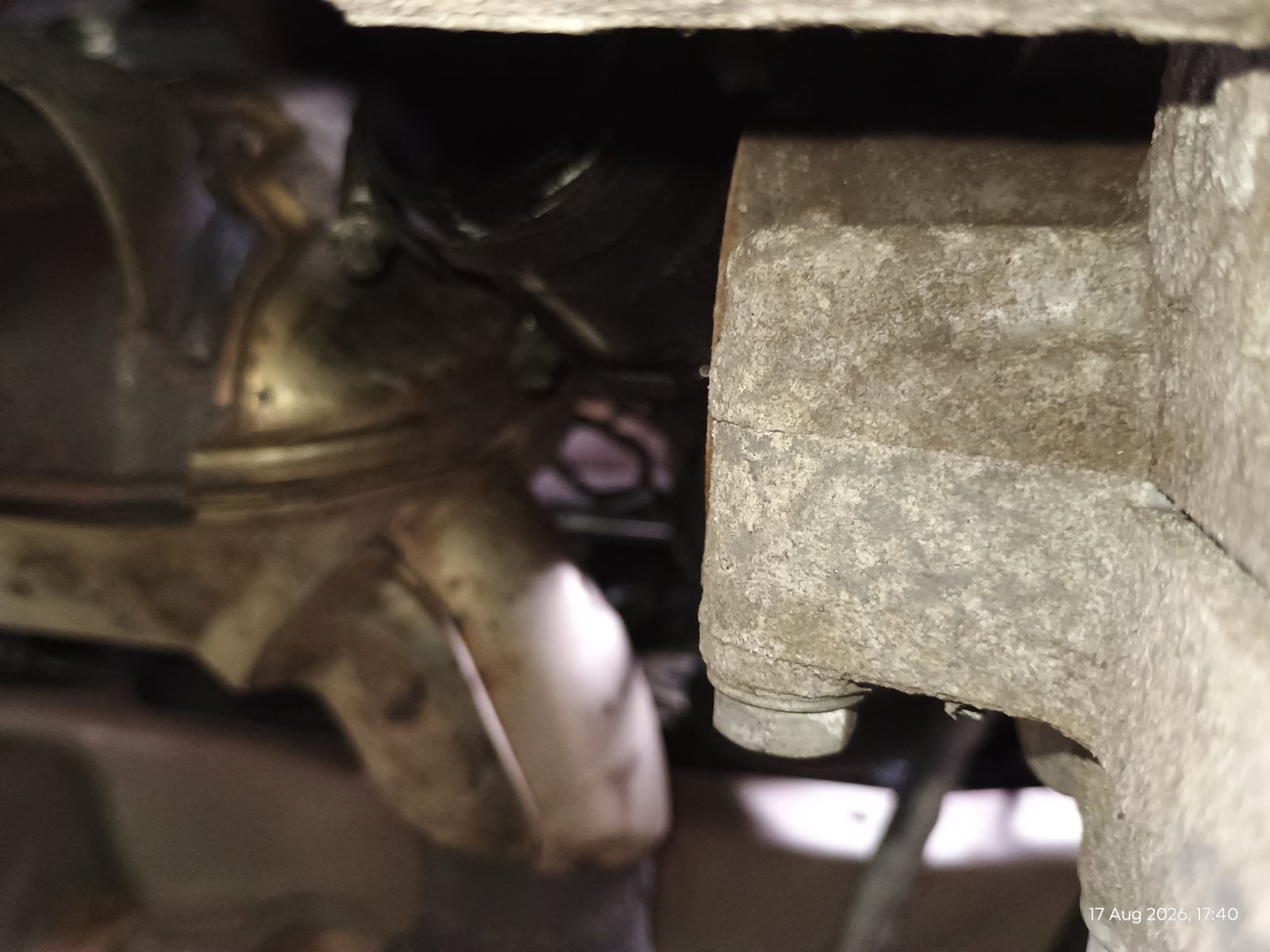

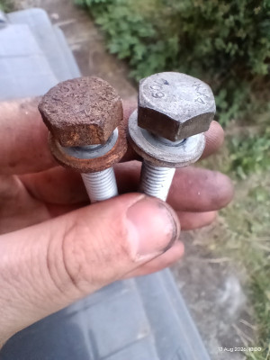

One of these bolts lives up high on the back of the engine, tucked up nice and warm with the turbo. The other down low front of the engine. Guess which is which ?
(Not sure how long without an under tray)

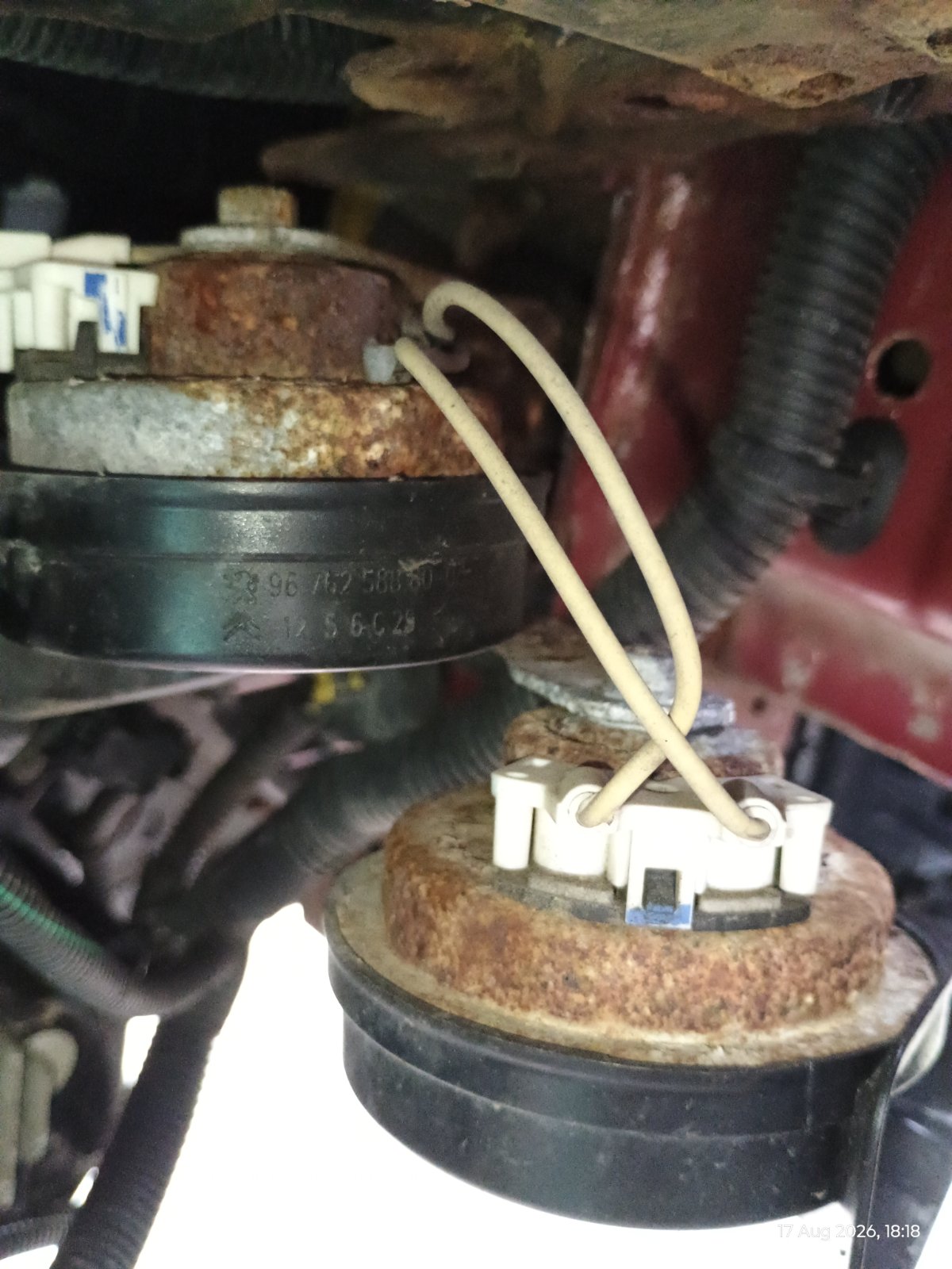

Crusty horns too

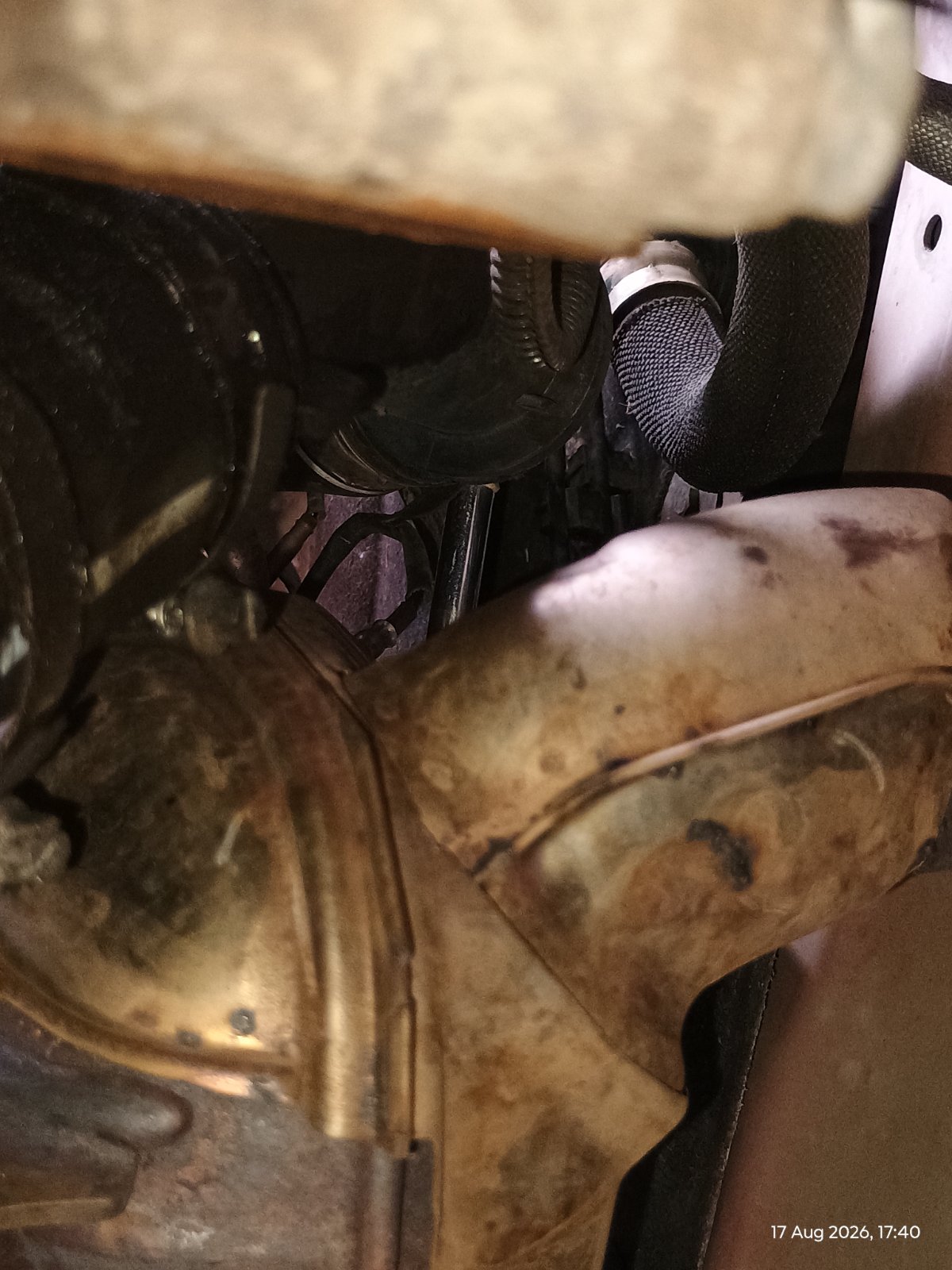

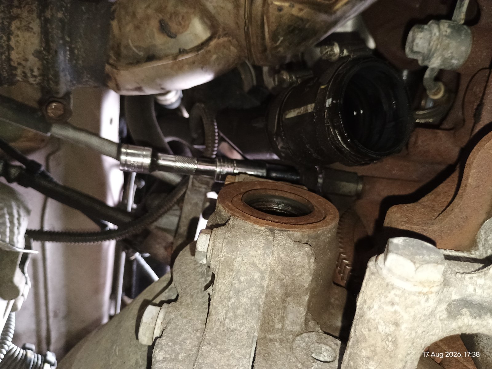

Another dump of photos.
Pipe under the sump removed (2x 10mm) but it's the next one up back if engine bay that's also hiding an engine to gearbox bolt (the clean one, above) another 10mm bolt and a house clip 8mm hex (rather than 7mm hex if the next 2x hose clips further down!)
Wheel arch liner (left) and bumper tray removed together to attack rusty fixings off the car.

MattBLancs wrote: Yesterday, 18:18 Crusty horns too
A now retired stripper from Clacton, they just call the ole fella crusty now , due to his age
