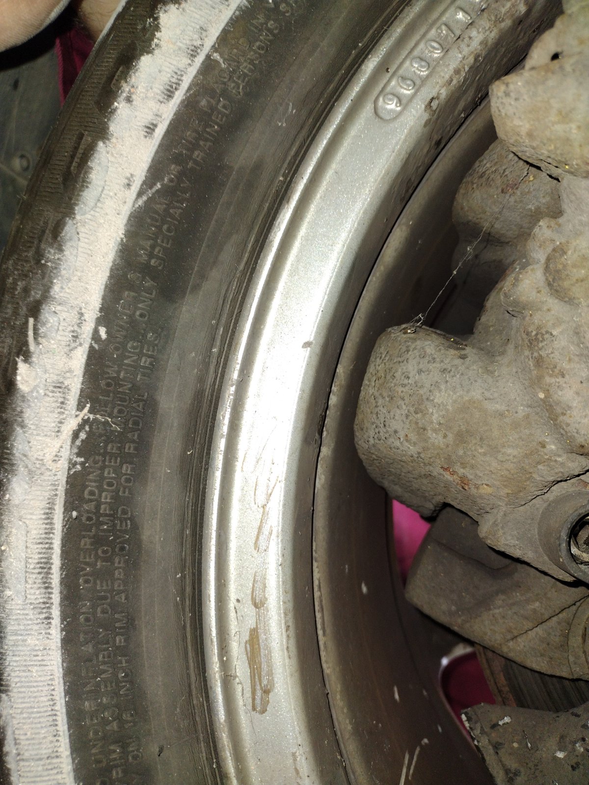

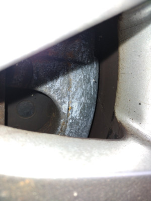

New car's awful oxidized wheels have pretty equally awful tyres so replacement of these is high in the list.
In the short term I am considering a wheel swap between the C5 and the new car.

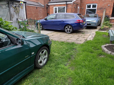

Final image before I am off to bed
"think I might fit in ok here"

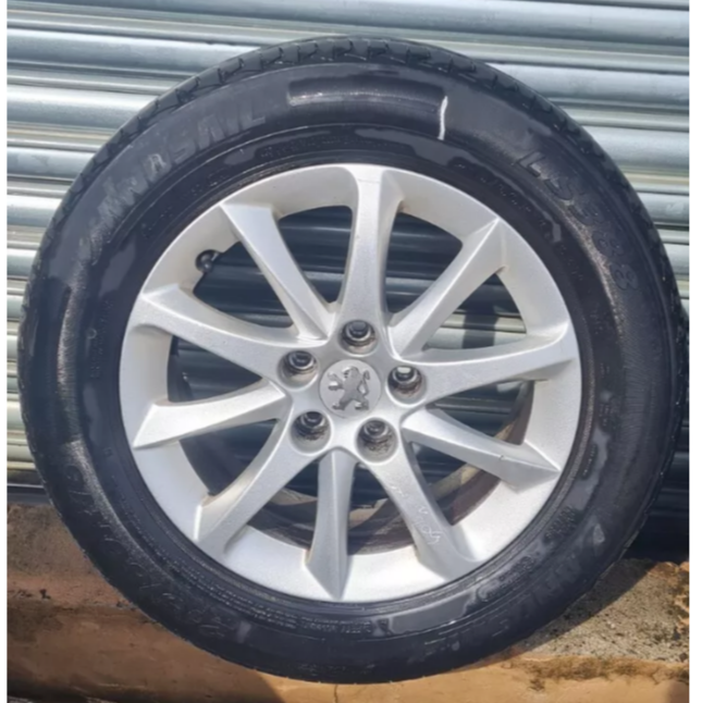

Possible wheel options I'm thinking about
508, 16" ten spoke.
5x108, 7.0J 16", ET46
Normally have 215/60R16 tyres from 508 application.
Example:
eBay photo
eBay photo
From https://www.ebay.co.uk/itm/145068985776

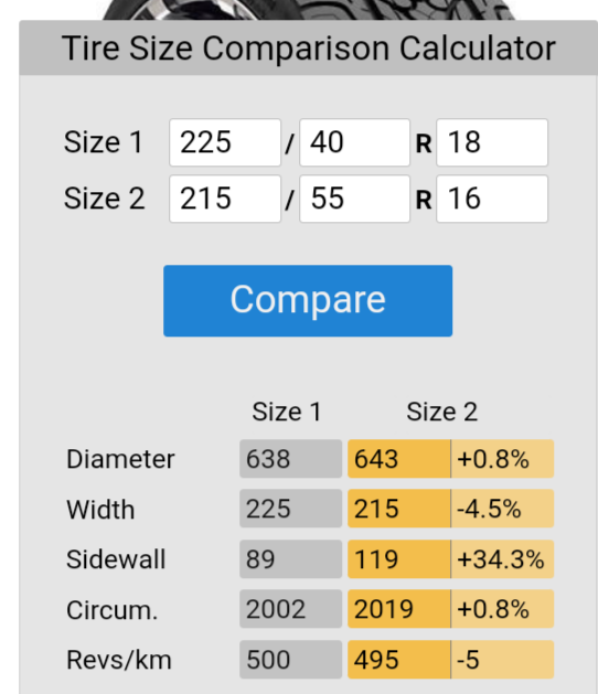

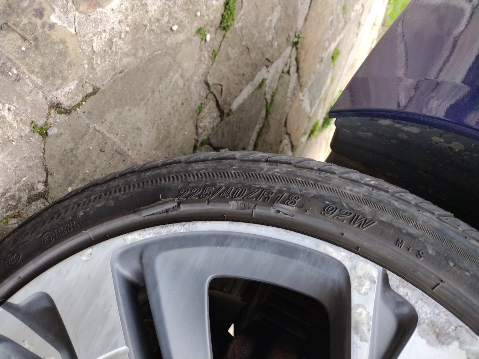

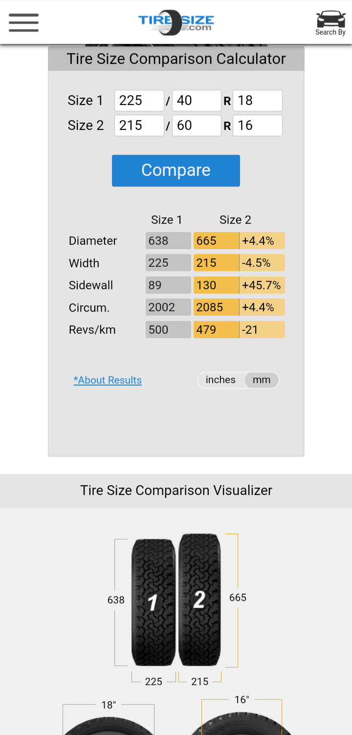

Current tyres are
18" current
18" current
225/40R18
This excellent website:
https://tiresize.com/comparison/
Suggests the overall diameter of the 16" is greater than the 18" so a touch too much nice squishy sidewall!
Current Vs 508 16" and tyres
Dropping to a 55 profile would be about perfect (will confirm availability of such a size)
Dropping to 55%
Dropping to 55%

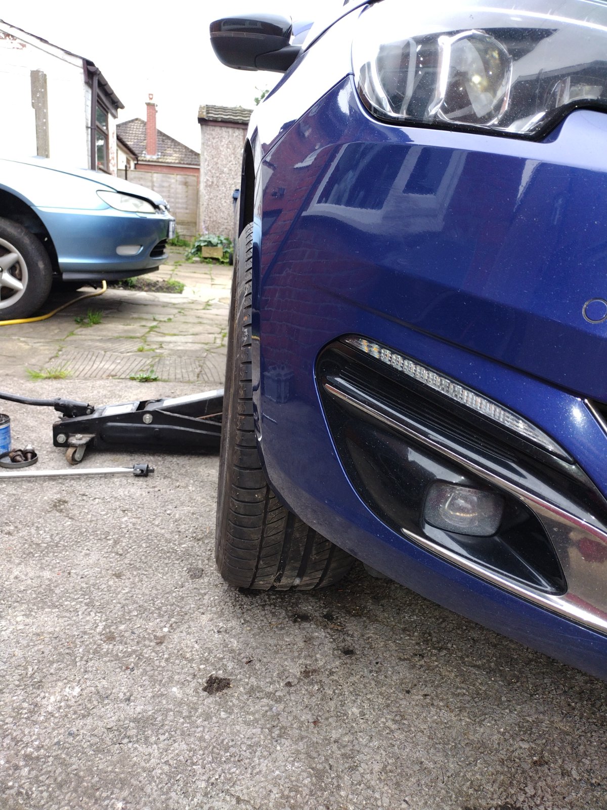

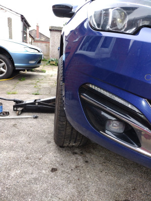

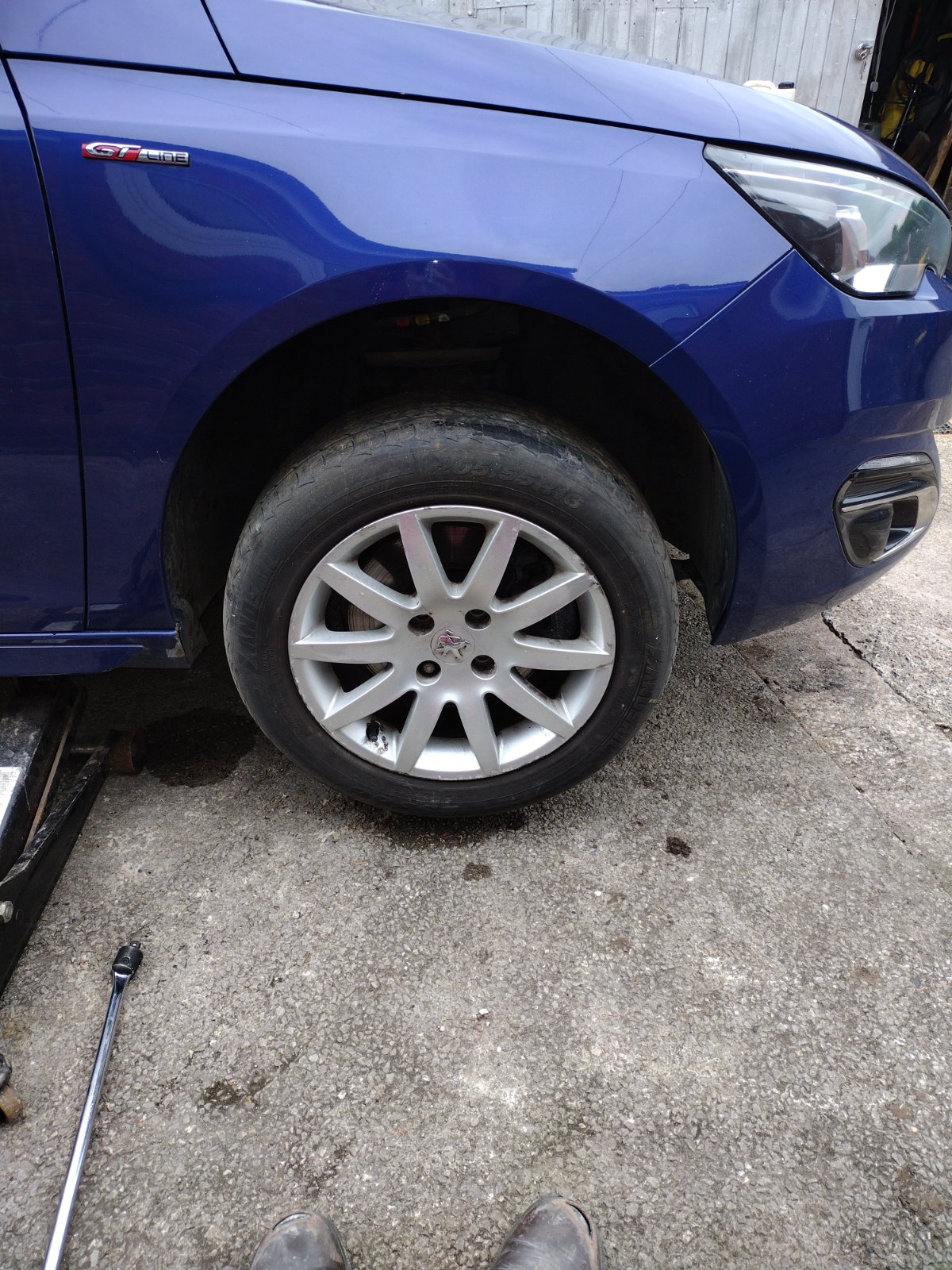

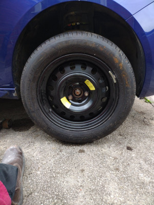

Further wheel investigation, not just online digging! Out with the tools:
C5 spare, 17" full size with a 225/55R17 tyre = considerable size increase over the 308 wheels (+6.4% 35mm says the tire size site). Tried it on front anyway= clears caliper with room to spare.
C5
C5
C5
C5
C5
C5

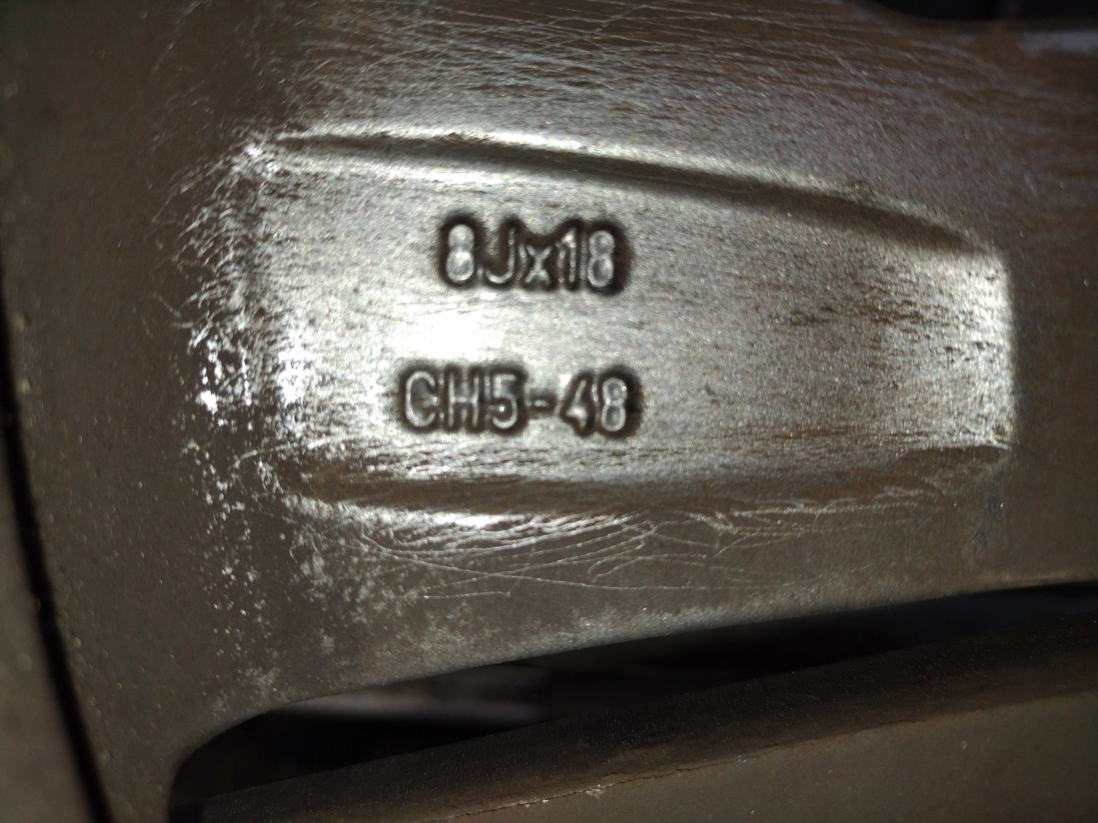

Offset noticibly different too. Will check the C5 steel offset as am sure it's marked. Edit: ET32
Et32
Et32
On that note, 308 current wheels are ET48
308 wheel spec
308 wheel spec
Next, I thought I'd see how far I could get on one wheel bolt as strangely the rest would not go in! :rofl2:
Other 308's (spare) wheel on later 308

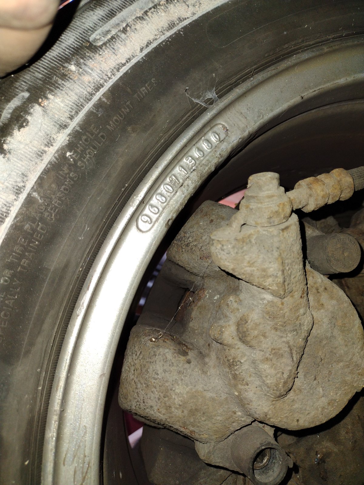

More seriously, thought this would give chance to check clearance of a 16" wheel Vs the large front brake caliper.
Obviously considerably tighter than the 18" with a full inch off the radius. But it does clear:
Clearance
Clearance
Clearance
Clearance
Clearance
Clearance
Clearance
Clearance

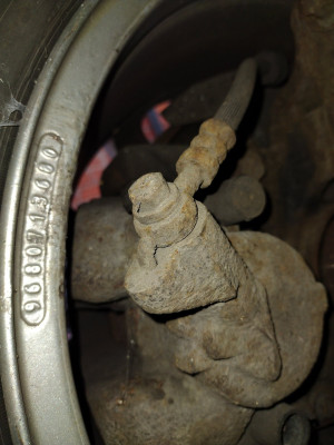

Oh look that lower caliper Allen bolt slider is missing it's dust cap.

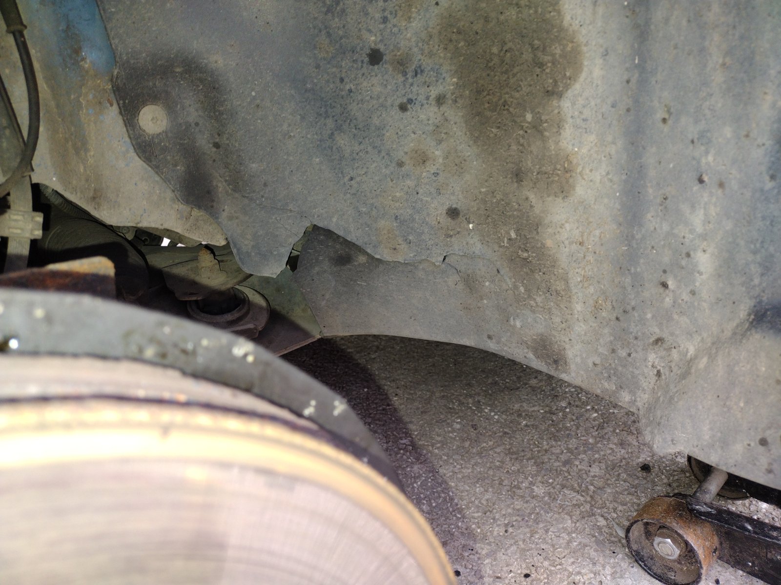

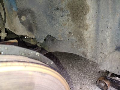

  • Passenger side wheel arch liner will come off for a session with the hot staples:
    Liner cracked.
    Liner cracked.

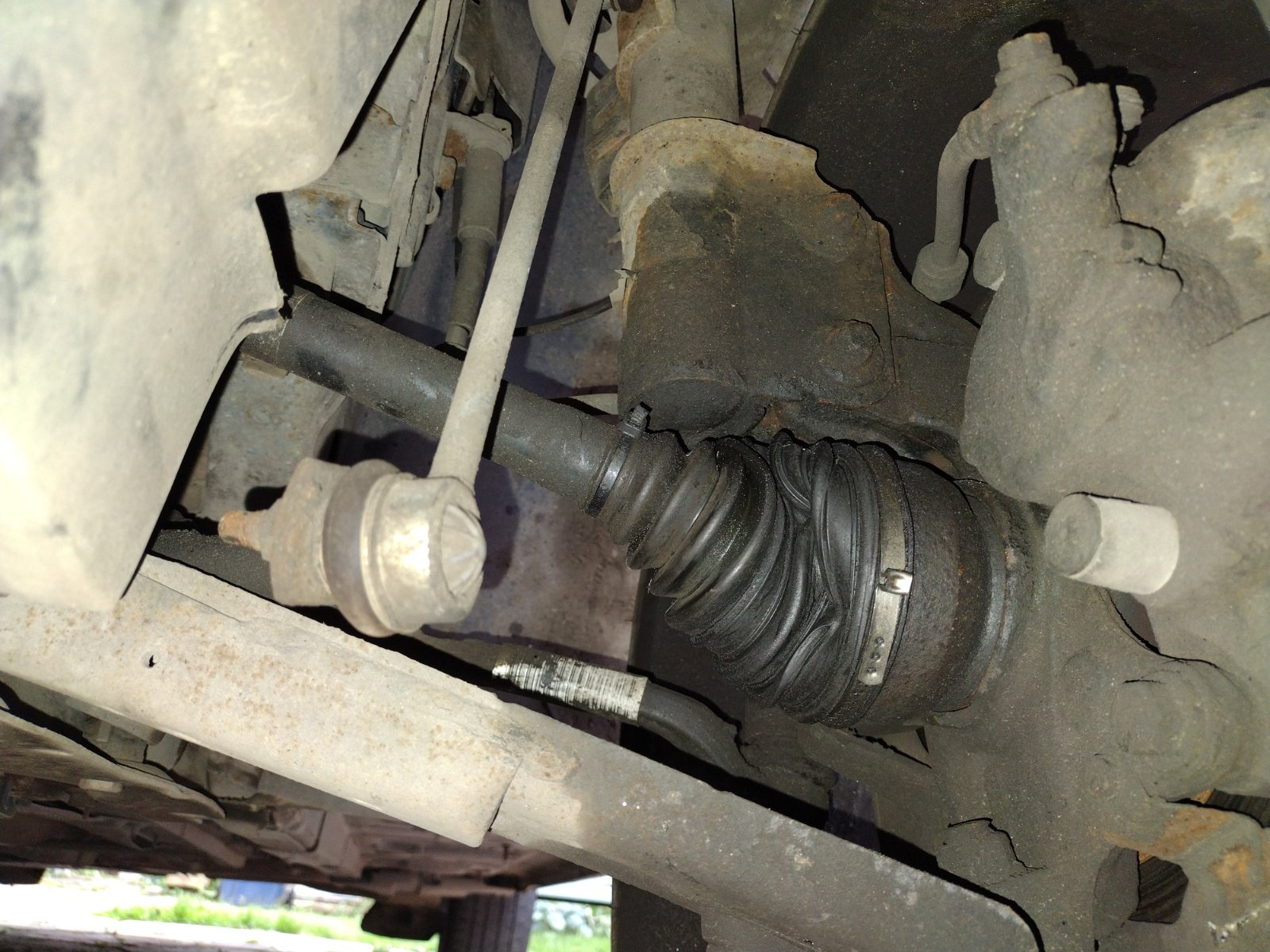

  • rather unconvincing looking CV boot (and grease everywhere) suggests I've found my clacking noise.
    Boot-ish
    Boot-ish
    Currently researching new CV joints. GSF and euro both don't list a CV for the 2.0 308.

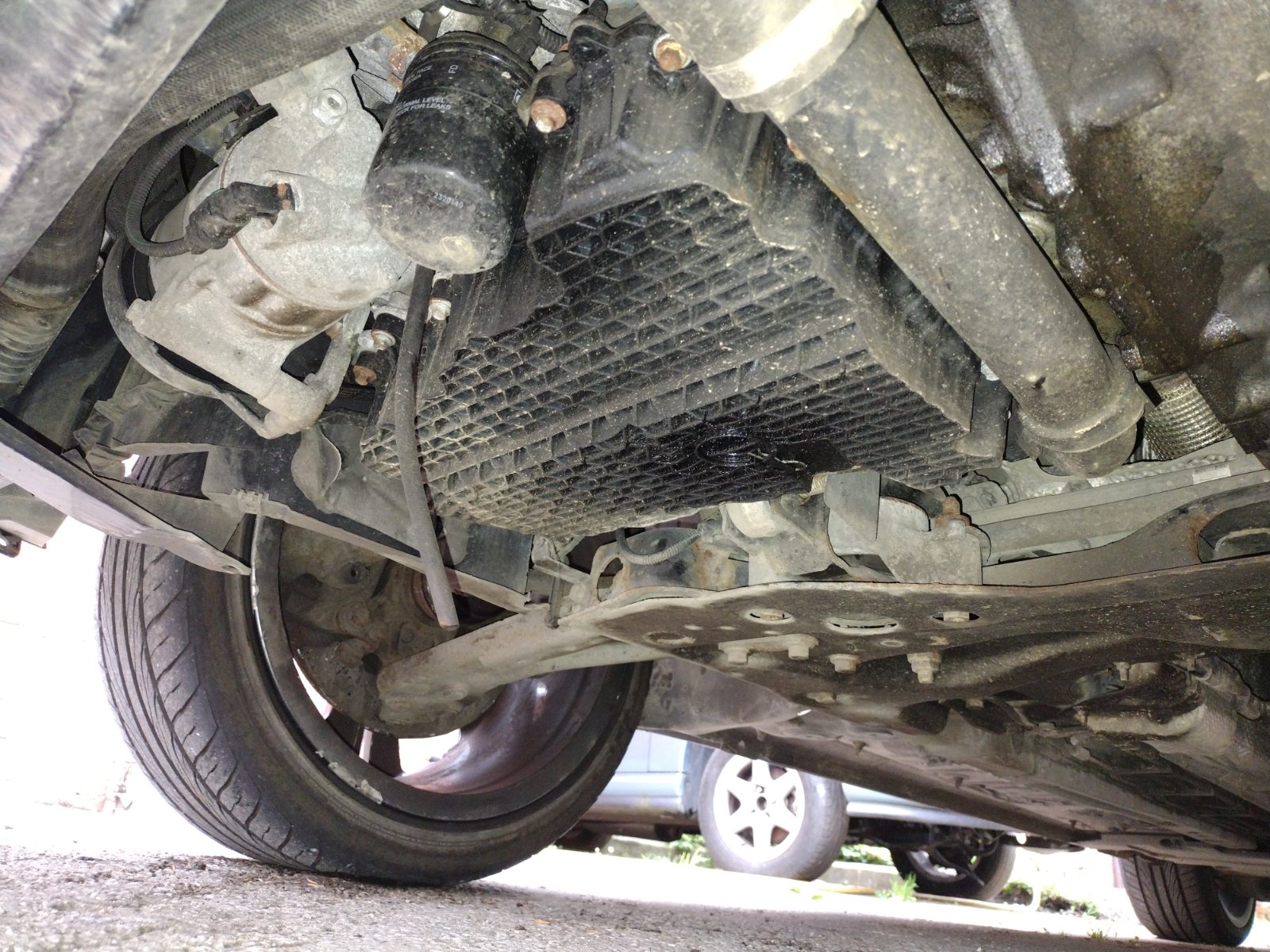

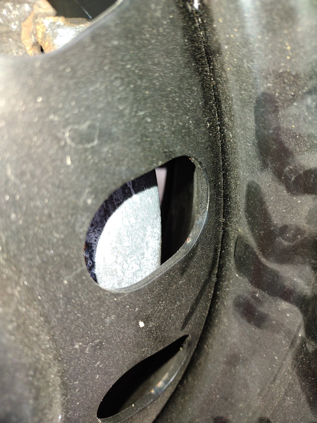

Other news, oh look a plastic sump.
Sump
Sump
Curing whatever the problem was with a cheap stamped mild steel version?? Guessing the least forgiving sump drain plug I've yet to encounter, fingers crossed not mangled in some way by previous service technicians.

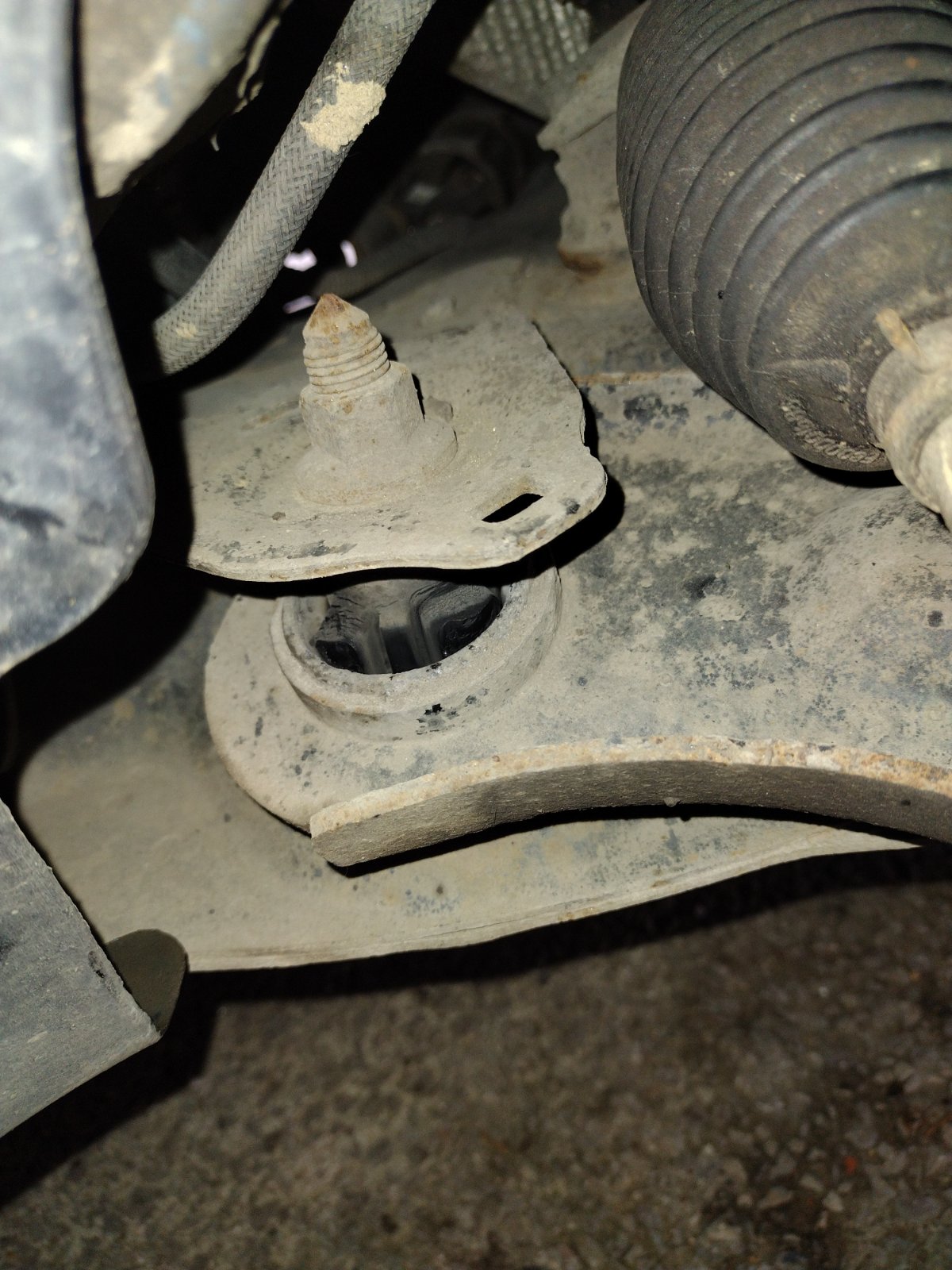

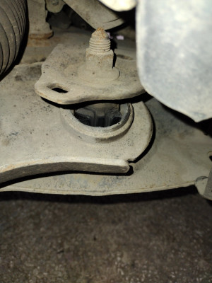

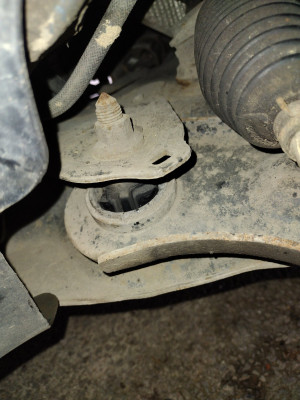

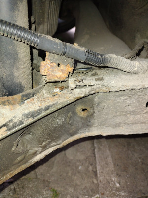

Oh and tired looking wishbone bushes, rear end of both front wishbones:
I'm bushed
I'm bushed
Me too
Me too

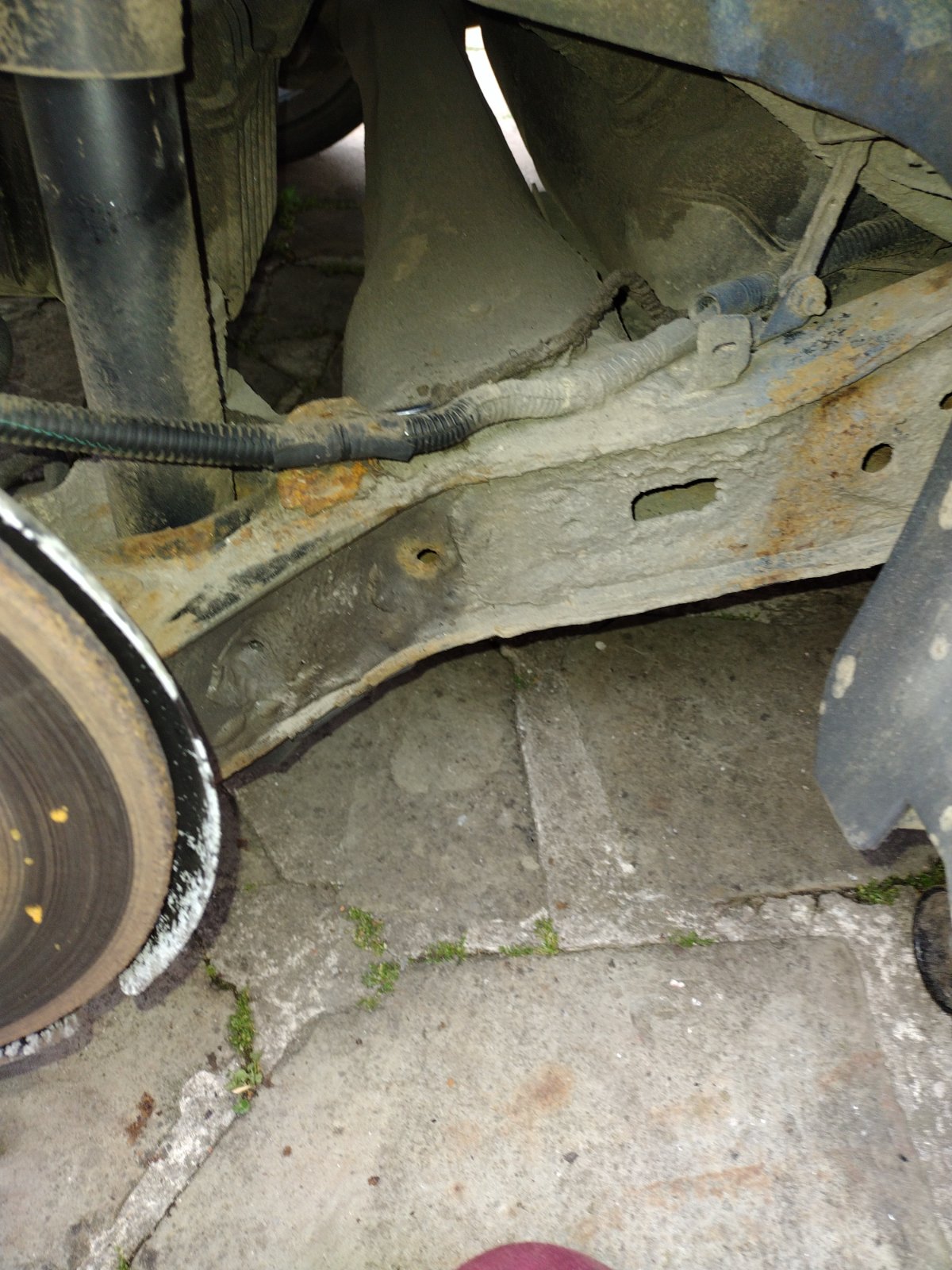

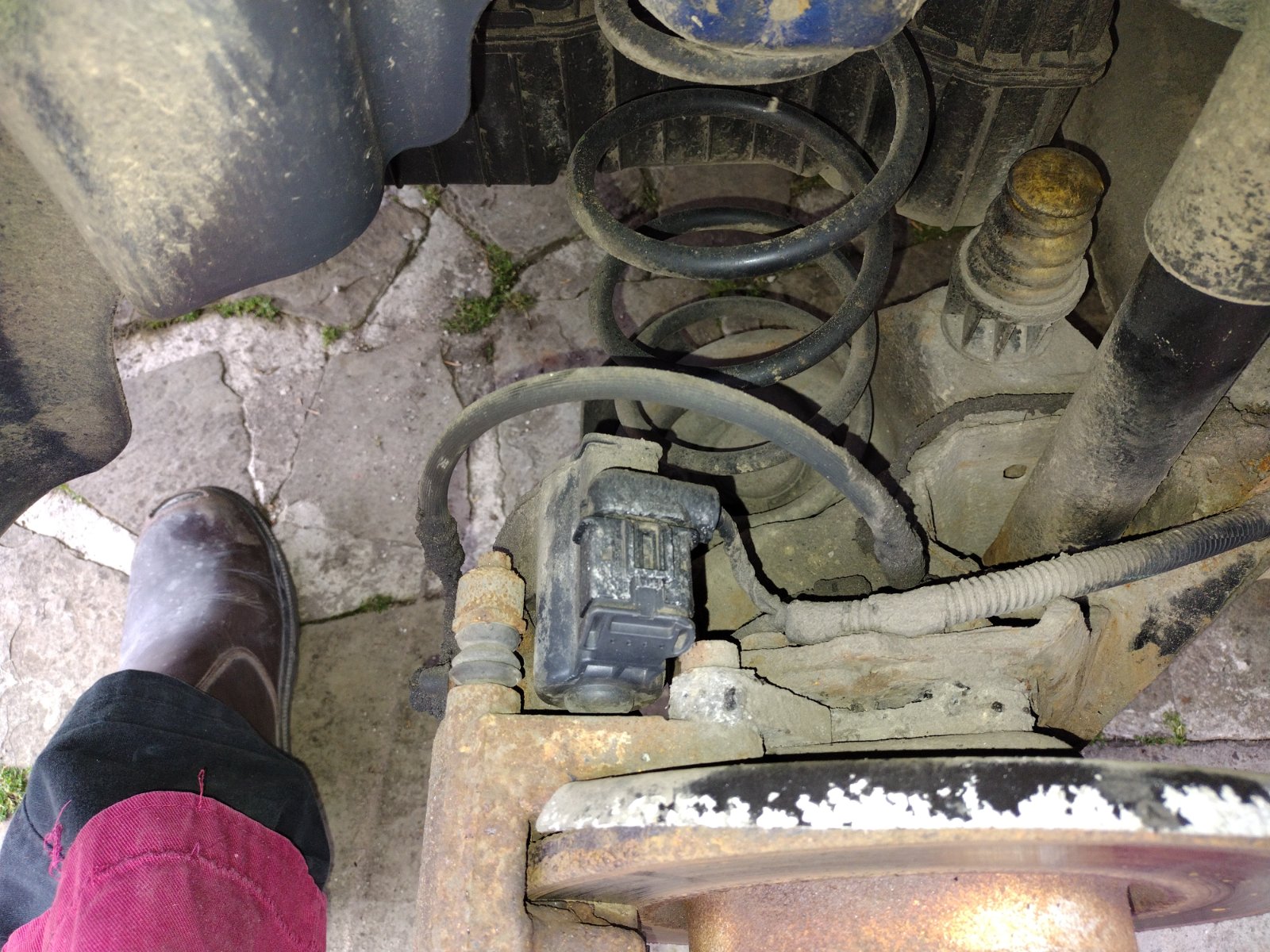

Rear wheels off, I see the 308 electric handbrake won't suffer the snapping Bowden cables of the C5 electric setup as it has caliper mounted motors instead. So more unsprung weight.
Handbrake motor
Handbrake motor
Hey-ho beats a manual setup up that "just works" and only cost sub £20 if a cable snaps .

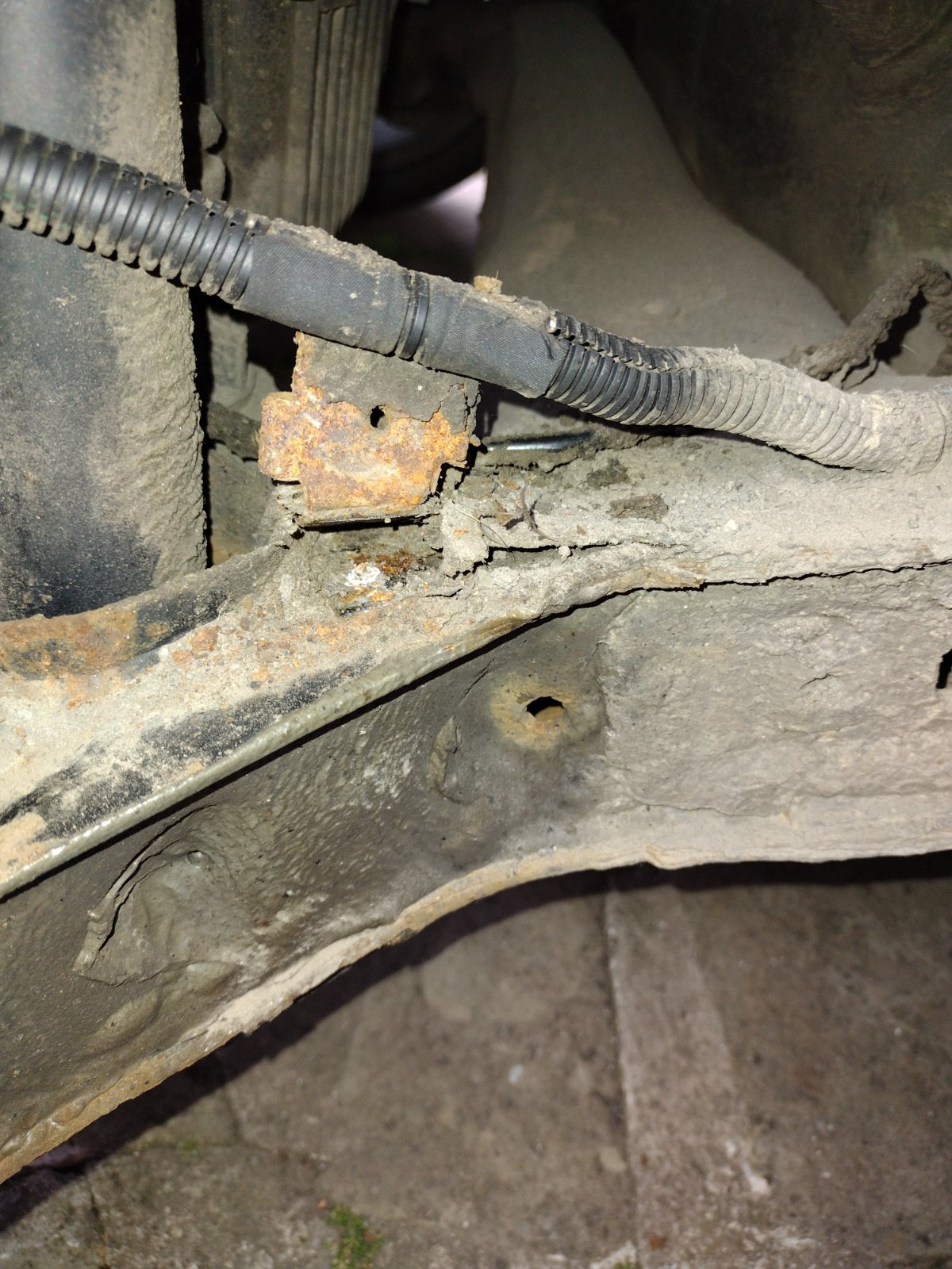

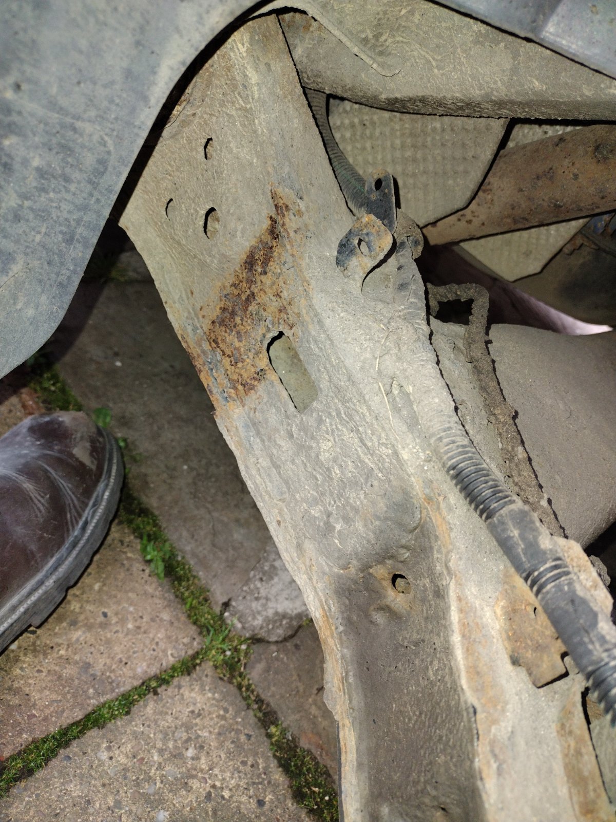

Rear suspension "beam" is pretty crusty - that'll get cleaned up and painted / undersealed.
Beam
Beam
Beam
Beam
Oh, crusty beam!
Oh, crusty beam!

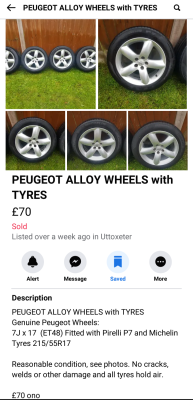

Ah, missed a nice set of 17" 407 Coupe alloys here:
Cheap!!
Cheap!!

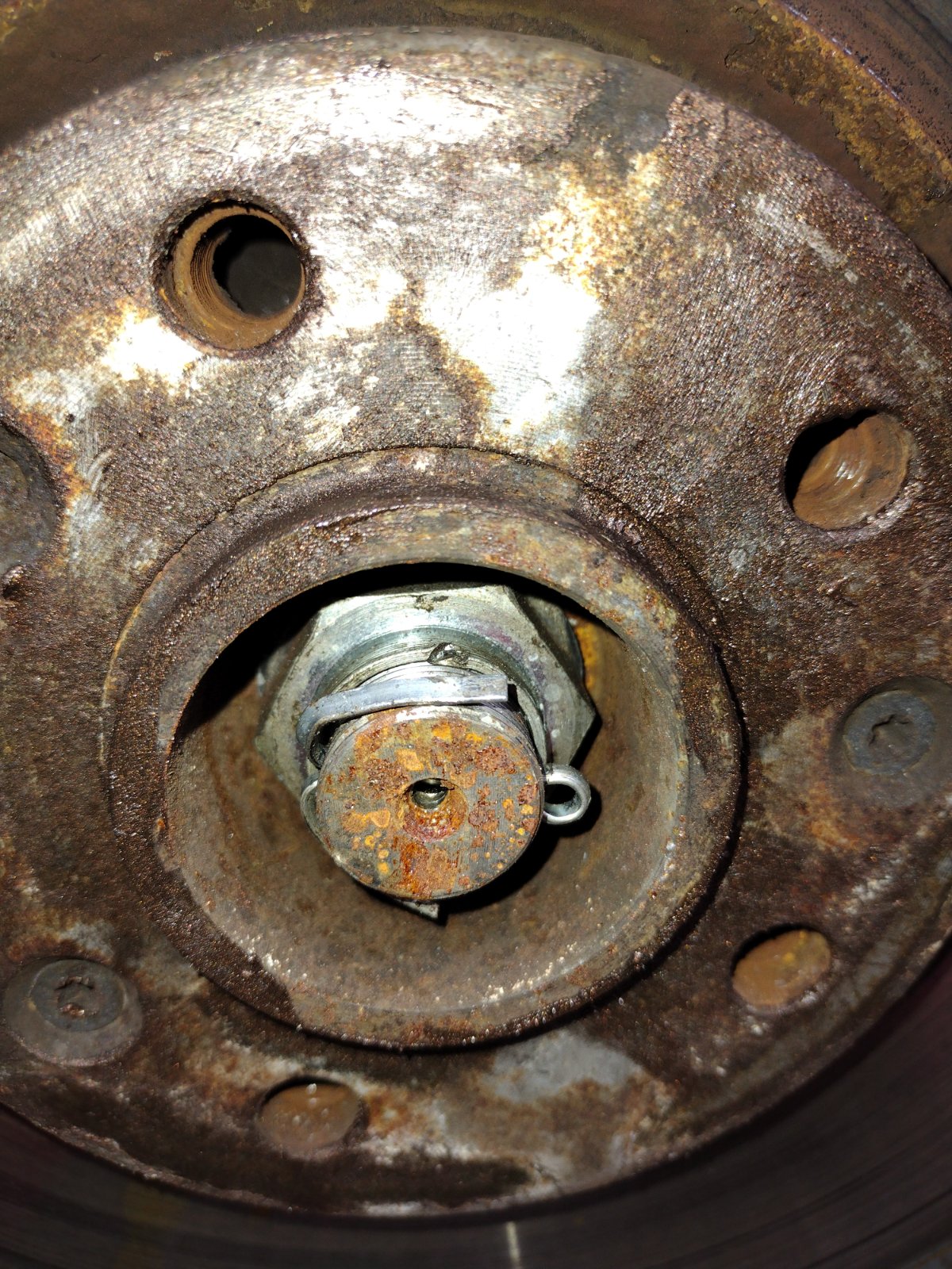

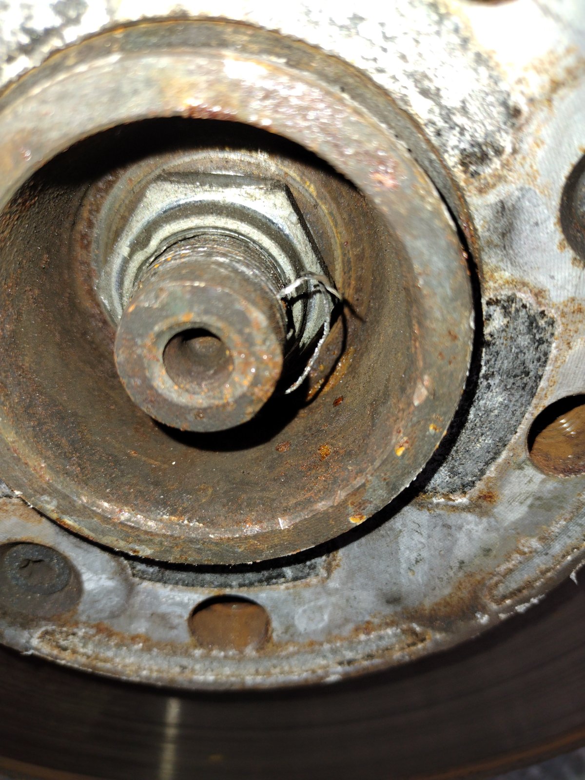

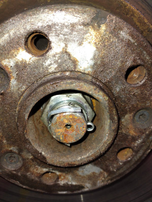

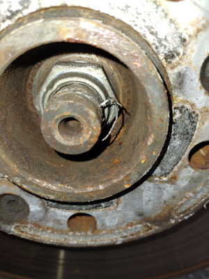

Aye, and I've not shown you the "make it up as you go along" approach taken with respect to hub nuts!
Driver side
Driver side
Take a nut designed to be staked over, then add a random split pin.
Passenger side
Passenger side
Or just omit the split pin if feeling tired!
Think there is a big thick washer missing on both sides.
That "shard" suggests cross threaded potentially.
So some fun there to be had!!

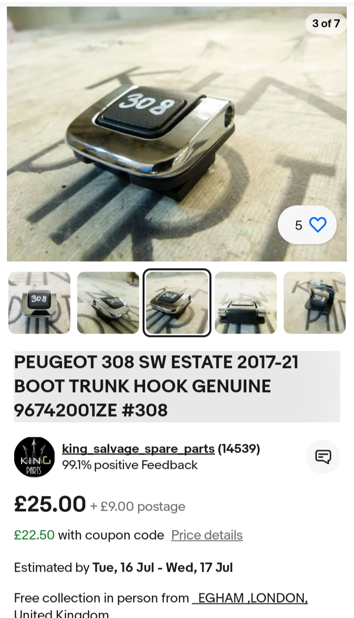

Gosh these are quite dear considering second hand!
Tie down points - cheapest I can find
I'm lucky to have a set of 4, but two have lost the button and associated mechanism beneath which locks them in position. Think I'll make do rather than chuck £60 on a fully functional pair!!
