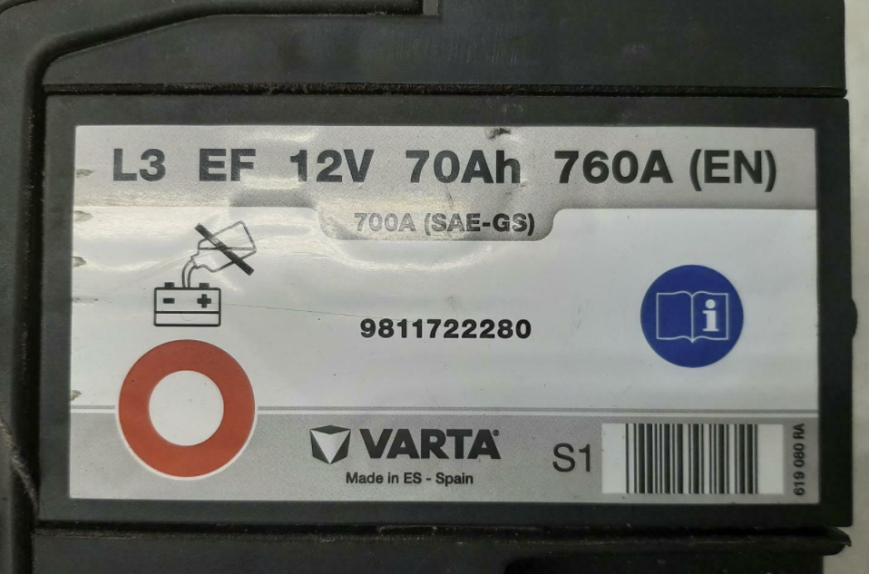

Not really - get the best battery you can afford that as a minimum meets the requirements of your vehicle's original.
The size of the battery and location / position / orientation of the terminals are also essential as there is not a lot of room nowadays under the bonnet. Also if you have the Stop and Start system, you will need a certain type of battery - either an EFB (Enhanced Flooded Battery) or an AGM (Absorbent Glass Mat) depending on your vehicle specifications and what was originally fitted. Getting the wrong battery can reduce the life considerably on vehicles with Stop Start, as standard batteries are not designed for the cyclic durability and charge acceptance of the other types.
Let me have your VIN and I can advise on the correct battery code for your vehicle.

Ok, so you should have a 760A/70AH. You have Stop & Start system, so need an Enhanced Flooded Battery (note the 'EF') marking on the battery as in the picture below:
This is the minimum specification:
Personally, I'd recommend a YUASA battery - they are recommended by many people here as a high quality battery. The Yuasa code for the recommended battery for your Picasso is: YBX9096. YUASA sell them for £252, but you can get them for much less - like here from the battery shop at £111 inc. VAT:
