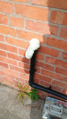

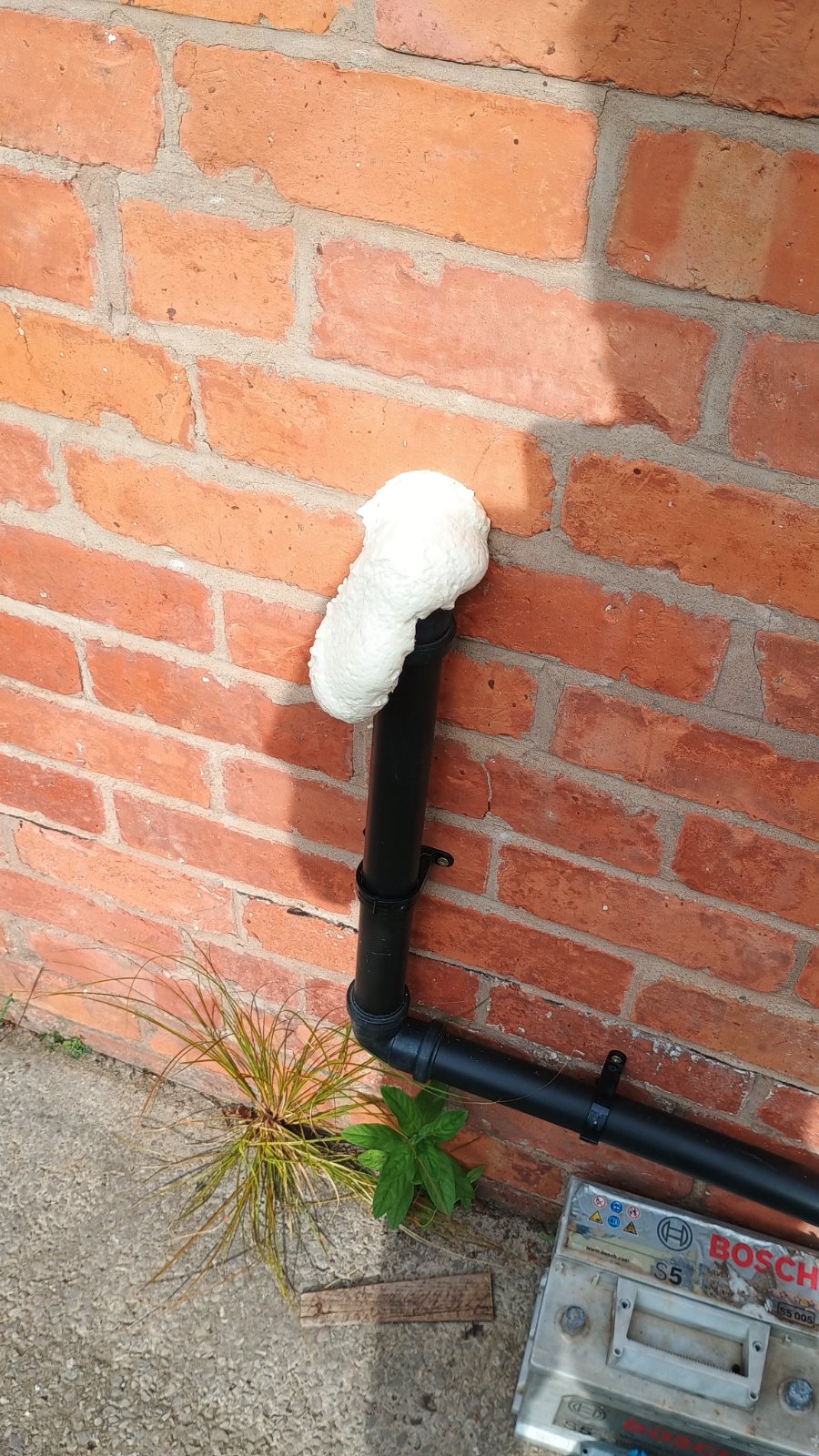

Perimeter sealed at last following my hacking a hole in it a good while back.
Here:
viewtopic.php?p=838076&hilit=Waste#p838076
I have used "squirty foam" a good few times so am aware of it's high rate of expansion.
Today's lesson was:
"If you buy cheap, over it's "best before date" squirty foam it may initially be reluctant to leave the tin."
When it does finally get going however....
Spoiler: show
Oh well, trim back once it's dried!
