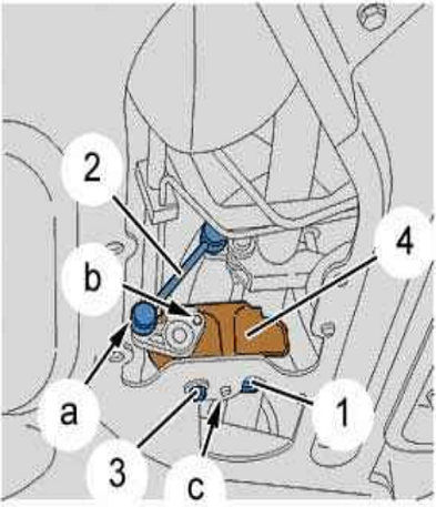

So this is an issue with the front height corrector. It has probably rusted or got contaminated (unless it has been removed or adjusted deliberately) and is sending the wrong height data to the suspension ECU. As a result the suspension ECU thinks the front is lower than in reality and the pump then tries to compensate to adjust. So when you have it on normal it is constantly trying to operate to raise the vehicle. So I suspect any hydractive adjustment (made according to road conditions) where it would normally raise the car slightly - will make the pump keep operating as the height information is erratic and it thinks it is lower than it is.
So you need to get it checked (but don't get underneath the car without supporting it independently - it can easily drop and crush you). Give the dog and bone joints a spray with some silicone oil spray.
If that doesn't improve it, then I suspect that the internal tracks are shot / worn and you need a replacement unit.
Note! If replacing it, make sure you follow the guidance on removing and refitting it (including disconnection of battery beforehand) - to stop the pump engaging whilst you are working on the system.
BSI Reset / Battery Disconnect / Reconnect Procedure
Disconnect the connector (1).
Disconnect the rod (2), as "a".
Peg the height sensor at " b" using a 4 mm diameter rod.
Remove:
Refit the height sensor ( 4).
Note: The positioning of the height sensor on the subframe is done with the aid of the pin " c".
Refit bolt (3), Tighten to 0,4 ± 0,1 daN.m.
Caution: Remove the setting rod from the height sensor!
Connect the connecting rod ( 2), as "a".
Reconnect the connector (1).

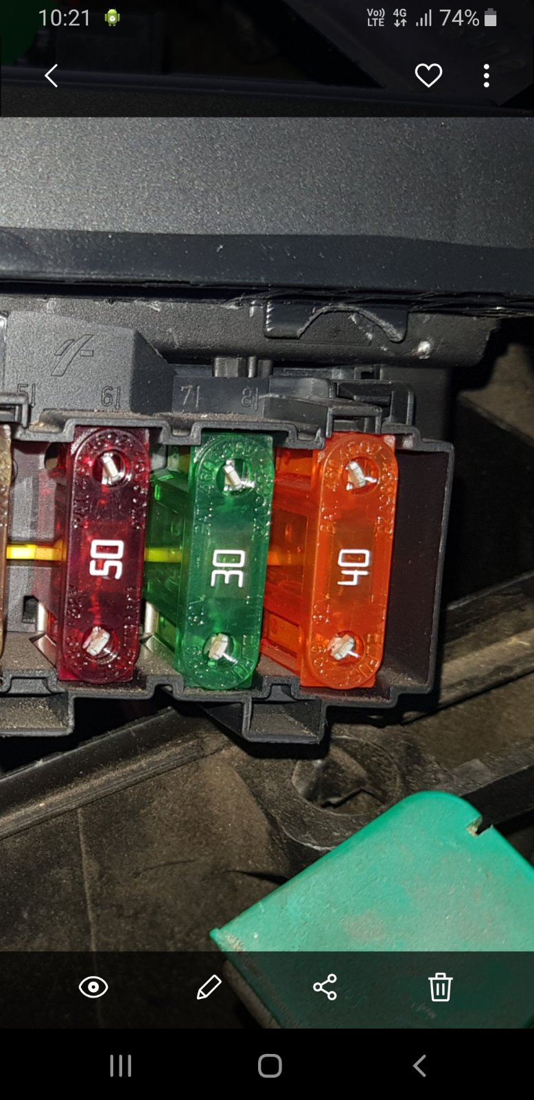

Before doing any wsnt to check the maxi fuse not blown. Previously I checked wrong fuse. Correct one 8. I have also attached the photo. Just wondering how do i remove maxi fuse. Do i need any special tools.
- x 6950
Re: C5 front suspension stuck at highest setting
Maxi Fuse 8 is the one for the Hydraulic Pump Motor. - It should be a 40 Amp - but test it with your multimeter - don't rely on a visual alone.

I tried to open by hand but didn't come out. Should i just pull it using plier or do i need special tool. Just don't want to break it.
- x 6950
No - they can be quite firm as they will have been in there since the car rolled out the factory. Just use some pliers gently to remove it.zeeshanzaki wrote: 23 Nov 2019, 11:24 Hi Marc
