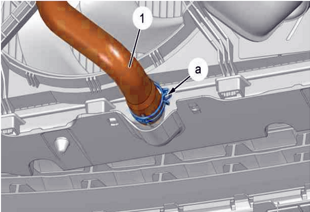

Uncouple the pipe (1) (at "a"); Using tool [0165-2].

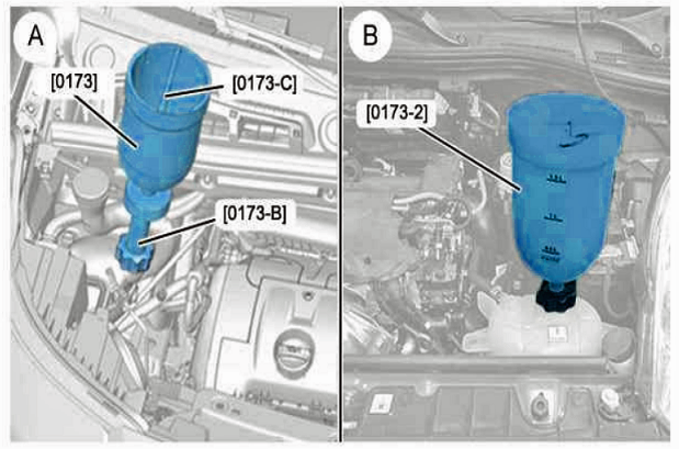

Filling the cooling system by gravity
Connect the hose (1) (at "a"); Using tool [0165-2].
N.B.: Refit new clips.

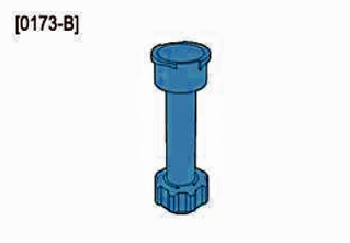

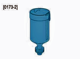

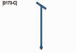

"A" : Fitting with filling cylinder offset; Using the tools [0173], [0173-B], [0173-C].
"B" : Fitting with filling cylinder direct; Using tool [0173-2].
- Fit the filling cylinder, blank and adaptor assembly on the expansion chamber (according to assembly).
- Open the rod on the filling cylinder.
- Slowly fill the cooling system with clean coolant.
- Close the bleed screw when the fluid is flowing freely without any air bubbles.

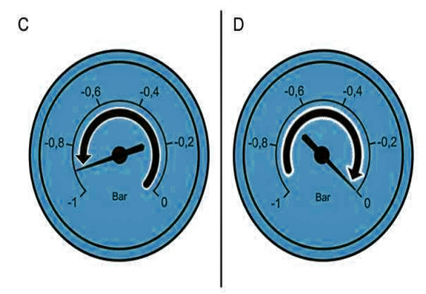

- Place the cooling circuit under a vacuum to reach -0,9 bar (diagram "C") :
- Wait 10 seconds and check that the value obtained does not drop
- Fill the cooling circuit completely and wait for the return to 0 bar (diagram "D")
