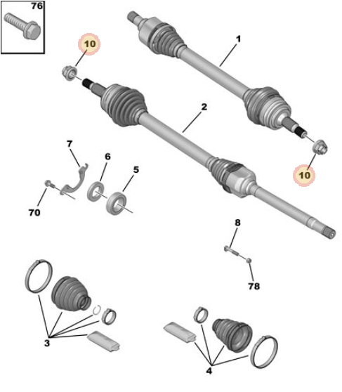

Copied from the parts thread:
GiveMeABreak wrote: 03 Aug 2024, 12:50 No worries
(10) Driveshaft Self-Locking Nut, Torque: 28,5 da.Nm
As for Gearbox oil, you're supposed to replace the amount removed, but if unsure, drain and refill. Quantities here depending on operation:
Quantity of oil to fill after draining: 2,1 ± 0,1 litres.
Quantity of oil to fill after an overhaul: 2,2 ± 0,1 litres.
Oil quality: 75W80.
Cabin Filter:
(7) Cabin Filter, 3 Options:
OEM Original Carbon Filter (Particles & Gas), part: 9804163480, £50.96
Cheaper Carbon Filter (Particles & Gas), part: 1612920480, £21.07
Anti Allergenic (High Performance Carbon, part: 1616959280, £63.65
On a LHD this on on the right side, so can't see it being different for a RHD. I believe you need to remove driver side centre console trim (remove centre console side trim cap to reveal screw). You'll need to find the cover as below and remove this to extract and refit the 2 filters. There are 2 plastic clips (tabs) to release the cover.

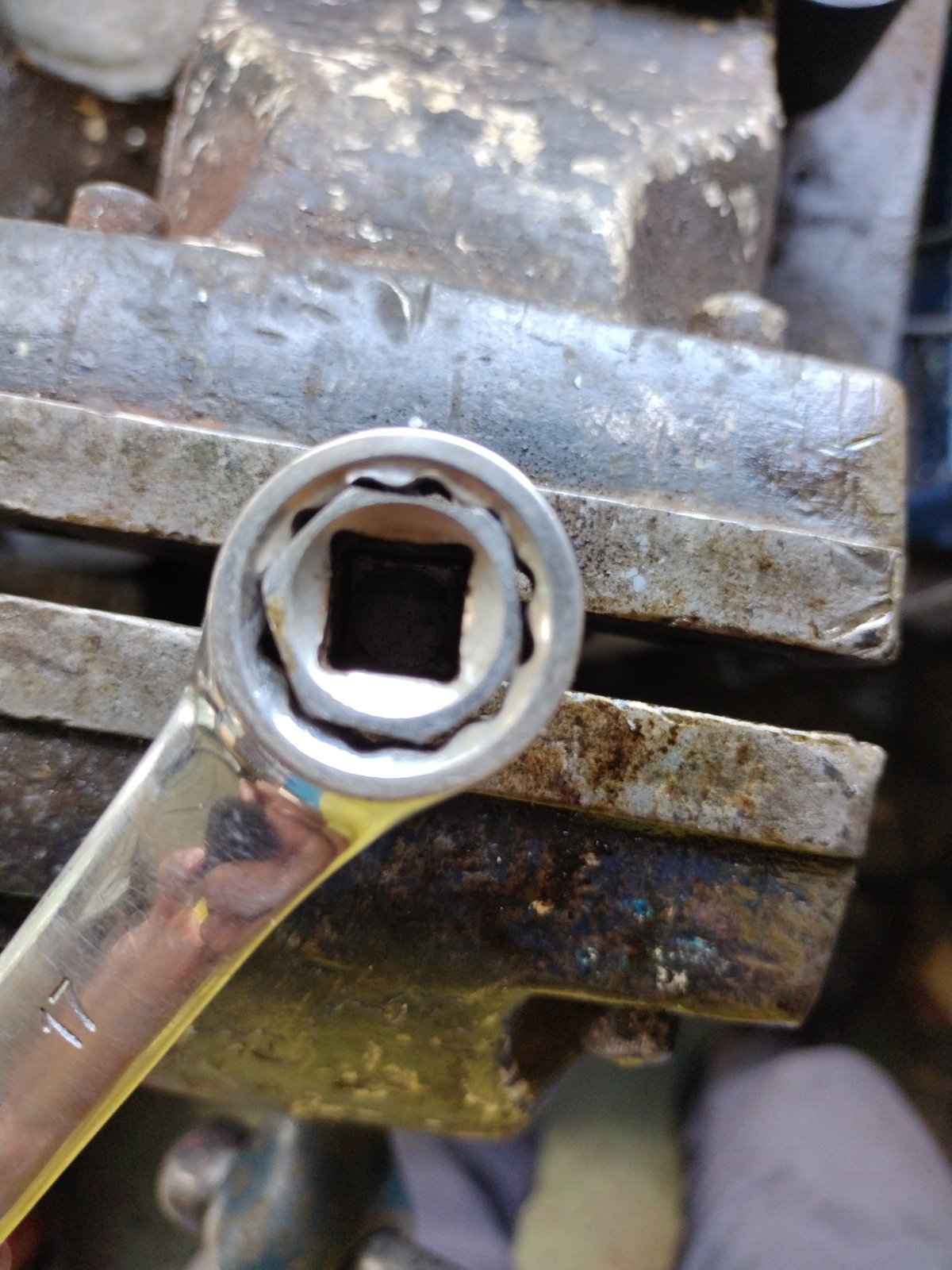

Gearbox oil drain location is suboptimal!
See if I can grind some flats either side of this 3/8 drive 8 mm Square adapter
Posts: 5237
Joined: 25 Apr 2022, 09:03
x 2296
Unread post by MattBLancs »
One smoking hot 17 mil drive to 8 mil Square plus 3/8 drive :)

The guesses at 60° aren't too far off amazingly!
