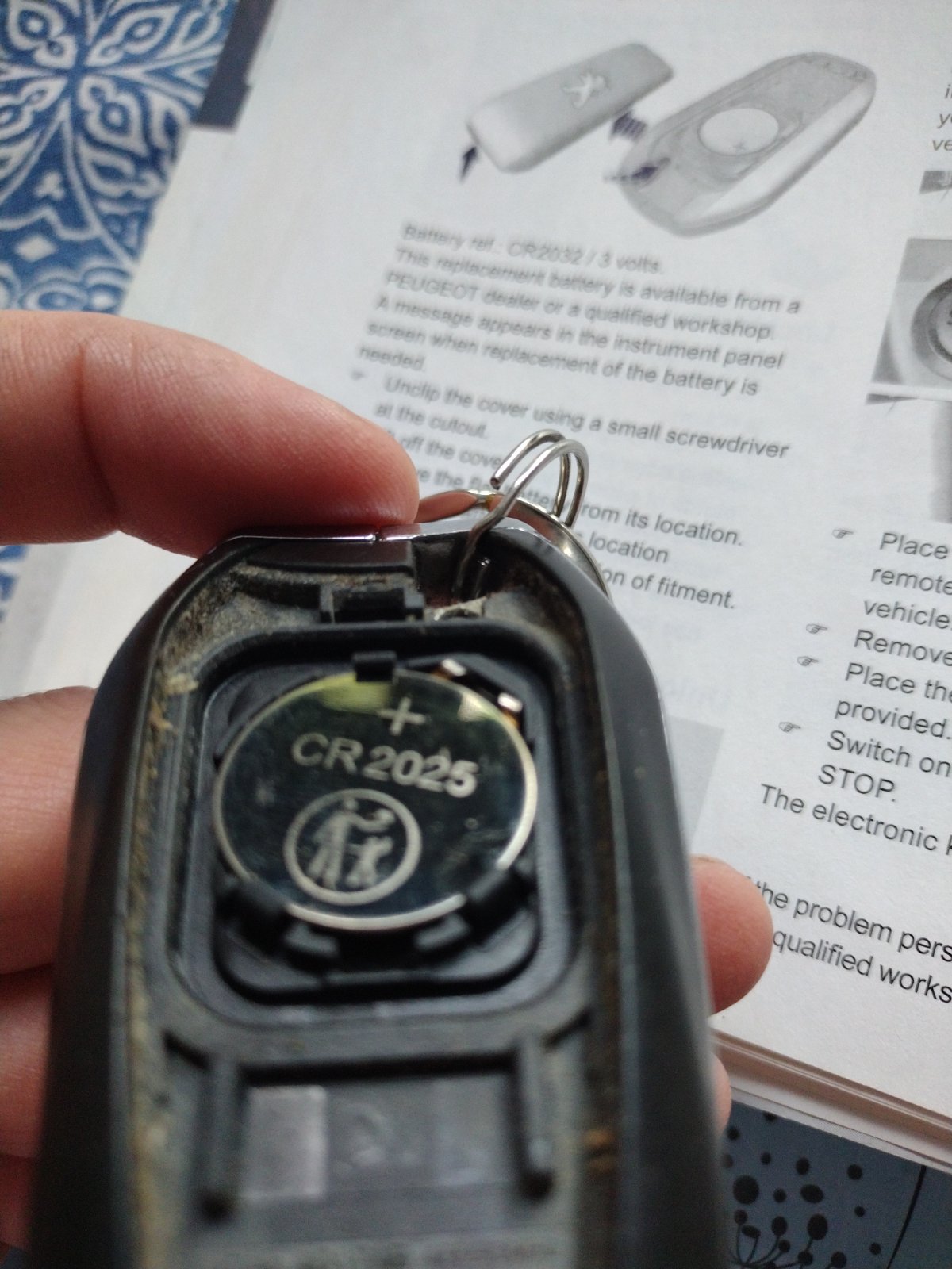

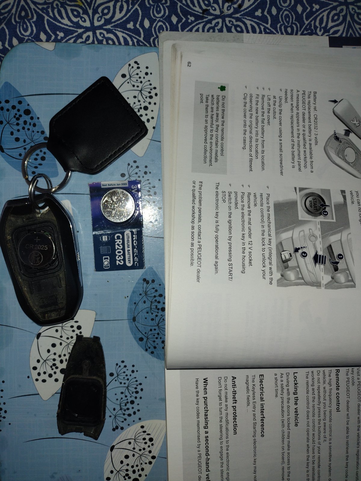

Trying a new battery in the key

Vs
x 3567
Thankfully, the only real difference is the thickness and capacity of the battery, so no harm should have occurred :)

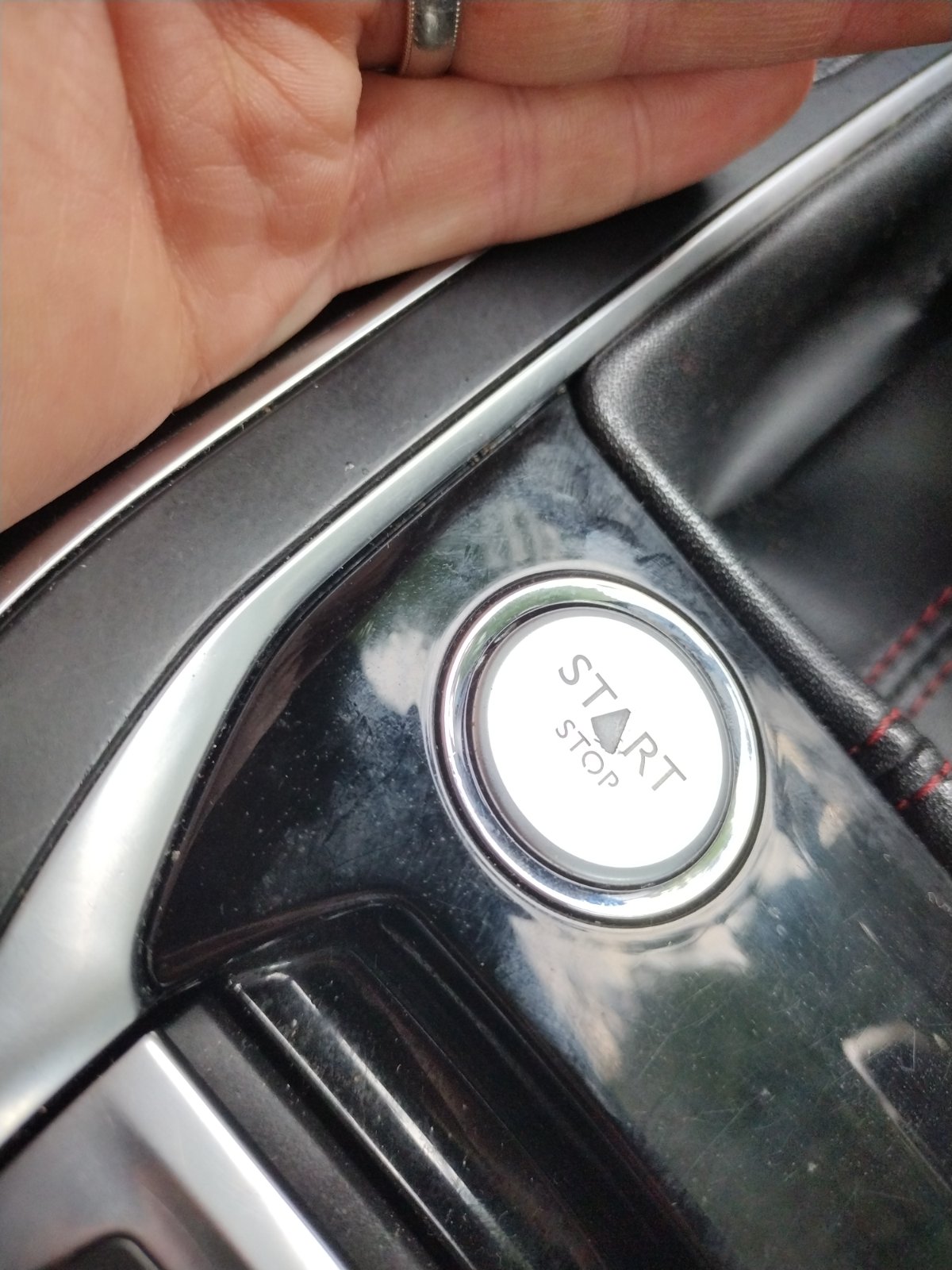

Start button ordered
eBay
eBay
£16.39 with a voucher. Decided to try a black one in the hope of avoiding any peeling chrome issues. (Genuine, second hand. Rear connection visually same as the correct chrome faced item, so hoping a direct swap)
By the way, here's the current one:
ST {triangle} RT STOP!!
Which feels horrible under your fingertip too!

Just for information:
CR2025 = 20mm outside diameter, 2.5mm thick,
CR2032 = 20mm OD, 3.2mm thick!
So I think there's a good chance that poor connection (due to thin battery flopping about in the key's battery holder) was behind yesterday's issues!

bobins wrote: 31 Jul 2024, 06:49 Thankfully, the only real difference is the thickness and capacity of the battery, so no harm should have occurred :)
Yes, if they'd stacked a couple of CR2016 in place of the single CR2032 then we'd be in trouble!
