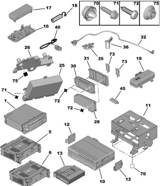

Ok, so originally, your car was fitted with the RD4 system, which has a telephone interface unit, shown as item (28) on the diagram below:
Although there is a lot of kit on the parts diagram, you have only the following items:
(1) The RD4 Head Unit
(28) The Telephone Interface Unit
(32) USB Socket Harness
(36) USB Port
(40) Radio Telephone Microphone.

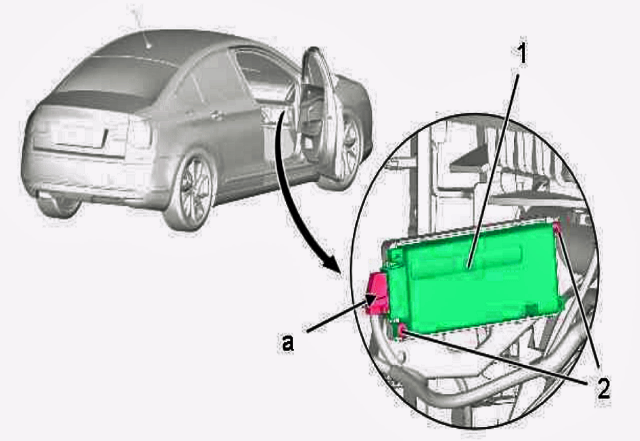

As for location on the left hand drive models it is tucked away behind the glovebox on your right hand side (passenger):

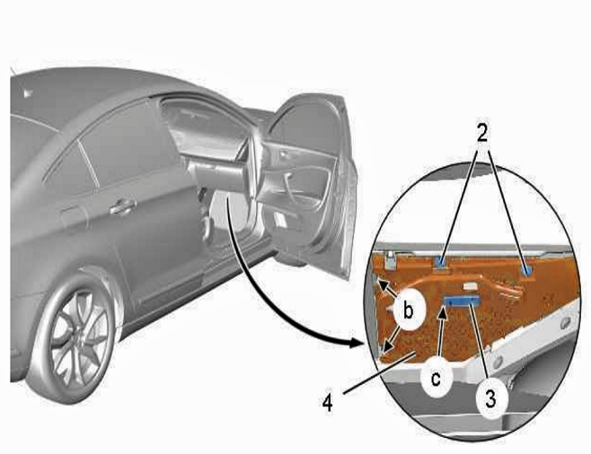

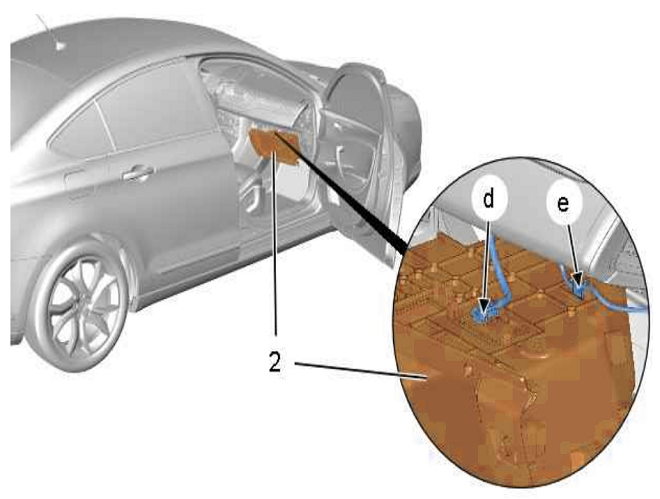

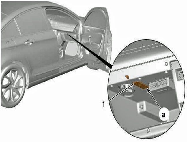

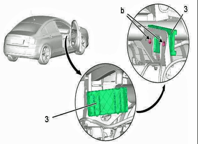

Ok, so here is the guide for the glovebox for you - in 2 parts:- the lid first, then the glovebox itself.
Warning:- it highly recommended that you follow the battery disconnection procedure due to proximity of Airbags. Once you have moved the seats rearward (where electric seats are fitted), follow the relevant part of the procedure and again when refitting at the end. But allow 5 minutes minimum after disconnecting the battery to allow the airbag ECU power reserve to dissipate!
BSI Reset / Battery Disconnect / Reconnect Procedure
Glovebox Lid Removal
Slide the front seat rearwards as far as possible.
Switch off the ignition.
Refit in reverse - but allow for replacing the shafts (7), (8) (if necessary).
Glovebox Removal
Refitting is in reverse, but allow for any clips that may need replacing

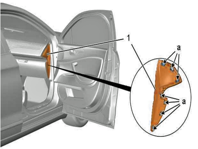

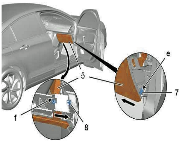

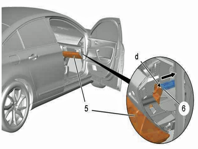

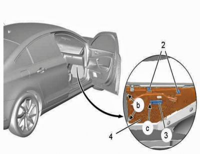

| Detach the dashboard side trim (1) ( as "a") using trim removal tools. Remove: The dashboard side trim (1). | Turn the fasteners (2) a quarter turn. Unclip - Detach: The lamp (3) ( as "c") using trim removal tools. Unplug: The lighting connector (3). Remove the lamp (3). Unclip the trim under the fascia (4) ( as "b") using trim removal tools. Remove: The trim (4) under the fascia. |

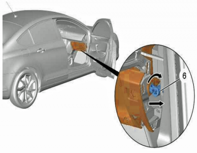

| Open: The glove compartment lid (5). Unclip - Detach: The stem of the ram (6) ( as "d") (following the arrow ) using trim tools. | Unclip: The shaft (7) ( as "e") using trim tool. Remove: The shaft (7) (following the arrow ). Unclip: The shaft (8) ( as "f") using trim tool. Remove: The shaft (8) (following the arrow ). Remove: The glove compartment lid (5). |
Glovebox Removal

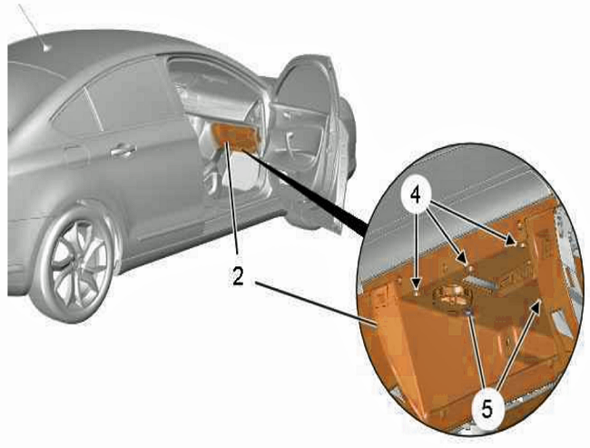

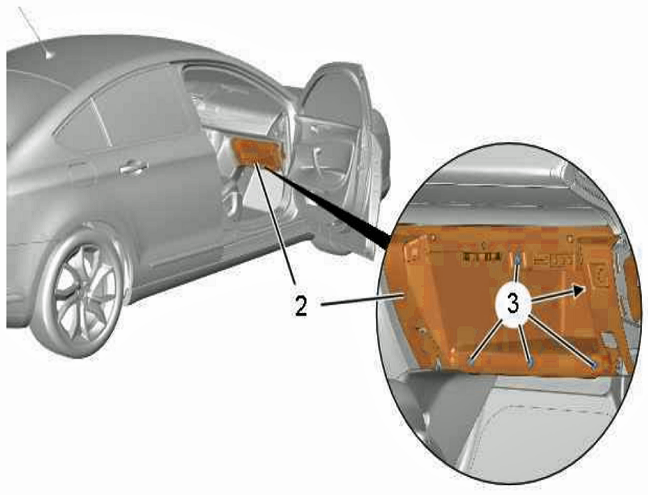

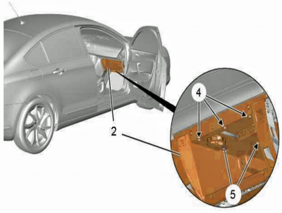

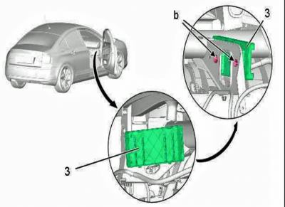

| Detach the lamp (1) ( as "a") using trim tools. Unplug: The lighting connector (1). Remove the lamp (1). | Remove: The glove compartment (2) bolts (3). |

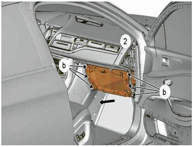

| Remove: The glove compartment (2) bolts (4), (5). | Unclip: The glove box (2) ( as "b") using trim tools. Detach: The glove box (2) (following the arrow ). |

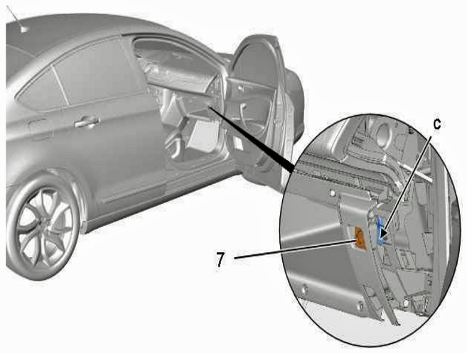

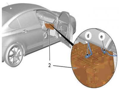

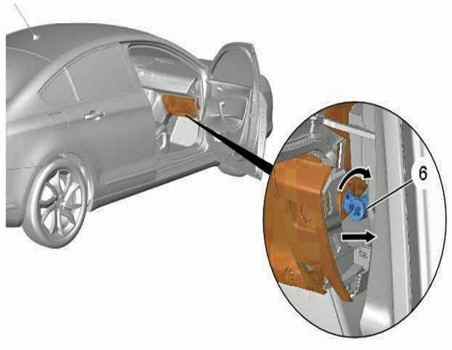

| Turn the ram (6) a quarter of a turn (following the arrow ). Detach - Remove: The ram (6) (following the arrow ). | Disconnect the connector of the passenger airbag deactivation switch (7) ( as "c"). |
| Disconnect the connector ( as "d"). Unclip: The harness ( as "e") using trim tools. Remove the glove box (2). |

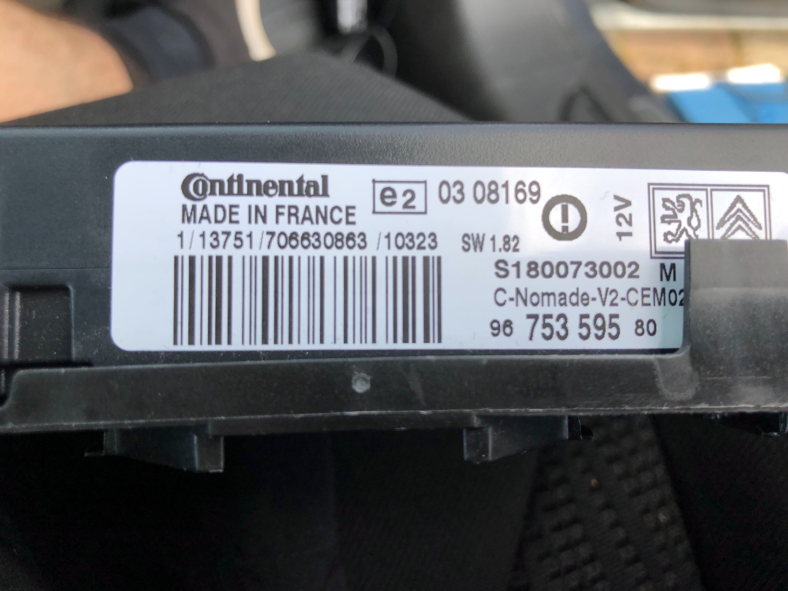

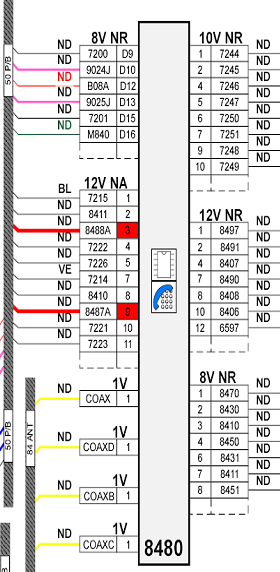

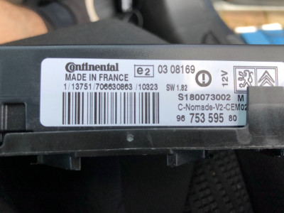

So the difficulty is that your car was originally fitted with an RD4 with the Nomad Hands Free Kit.
You have now upgraded to an RT6 (Telematics Unit).
So the Nomad Bluetooth Module is no longer required and should be removed as it might conflict with the the RT6.

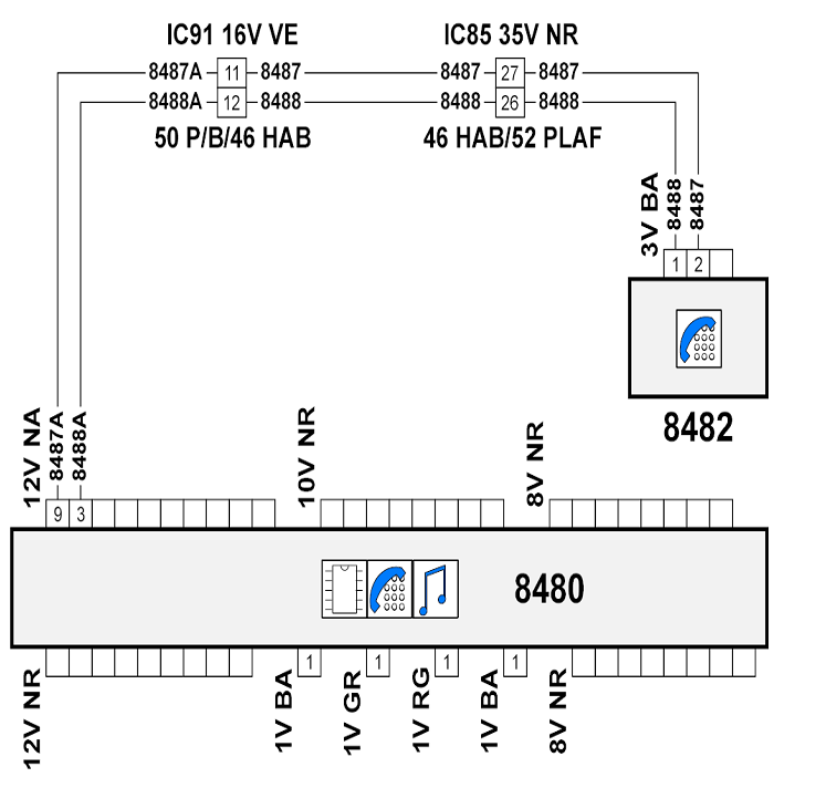

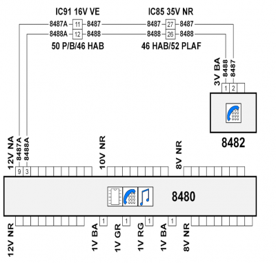

The other issue now is the wiring diagrams are not 100% specific as you have a hybrid setup. I have done what I can to locate the microphone connections - but these are routed via an interconnection harness as you can see:
There should be a 3 pin connector in the microphone unit , but only 2 pins are used:
8487: Hands Free Positive +
8488: Telephone Microphone Earth
The interconnection should provide 2 connections into the a 12 pin connection shown.
Here is another look - the 2 connections in red are shown from the harness into the telematic unit connector in one of the 12 pin blocks on the (RT6):

I have disconnect the the nomade and turn it of in Diagbox, but i Can stil see it on the list.
