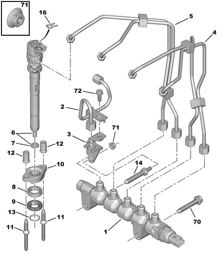

Ok, I've got the VIN, so you have the 1.6 HDi 92 DV6ATED4 engine.
Now I know that Citroen DO NOT sell the fuel rail sensors separately, as you can see on the diagram. In fact, I do know several members that have bought the sensor aftermarket and had problems - only resolved when they replaced the rail itself - that comes with the sensor incorporated. The official technical information actually states NOT to separate the sensor.
So I'm not sure if this is what is giving you other fuelling problems as a depollution fault can be emissions related - but can also be air and fuel related. You don't have a particle filter so can ignore that, but EGR is another possibility if the vacuum solenoid is playing up.

I appreciate what you say about the rail. The sensor is obtained is a genuine part, tested and guaranteed. I was gambling on it at the time. PSA would never sell it separately given the pressures involved.

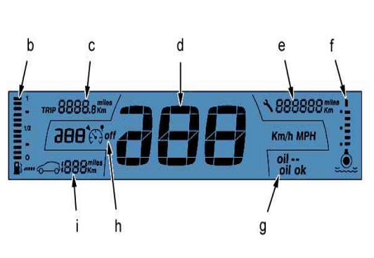

Re: C4 Dash warning lights- none
This is the instrument display - where is the 'lollipop'?
The instrument panel is equipped with an autodiagnostic function which is active from the time the ignition is switched on. The autodiagnostic function consists of the warning lamp test and of the checking of information which is not available.
The warning lamps and indicators checked are the following:
| Reference | Key |
| b | Fuel level indicator |
| c | Trip odometer |
| d | Speedometer |
| e | Maintenance indicator |
| f | Coolant temperature indicator |
| g | Oil level gauge |
| h | Cruise control and speed limiter functions |
| i | Fuel range indicator |
- EOBD
- Airbags fault
- Passenger’s airbag deactivation
- ABS fault
- ESP fault
- Brake fault
- Low fuel level
- Service
- Stop warning lamp

Forget the lollipop. I think I have solved that. I think its the mpg indicator on the other (multiplex screen the one that shows the radio) The car has been idling a lot and yesterday was the first time it moved. I think it has sent the mpg indicator into a bit of a spasm. This car has so many screens I do not know the correct name for each.
Right. The screen you are showing all appears to work. The speedo tested yesterday, fuel level and temp ok so I am assuming this screen all good. What is definitively not working are the two small screens either side of the display you have shown above. Both are totally blank/black at all times. From memory should have oil press, handbrake, check engine etc to the left and open door and seatbelt to the right.
