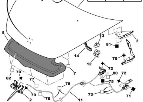

I don't know if anyone can help ,but I need a part number for a c3 puriel and I can't seem to find service citroen so I can't use malcolm a count to find the part number . I am look for the part number for the bonnet catch mechanism with leaver it is a 2005 plate

I have just looked on my PC, and the part number for the bonnet lock is 7934 67. I would wait until somebody with Service Citroen can confirm my findings though.

chris citro wrote: 10 Jun 2018, 02:18 I don't know if anyone can help ,but I need a part number for a c3 puriel and I can't seem to find service citroen so I can't use malcolm a count to find the part number . I am look for the part number for the bonnet catch mechanism with leaver it is a 2005 plate
This comes in 2 parts depending what you need. Number (2) is the locking mechanism that appears to contain the lever, part number and is £28 from Citroen.
The actual cable part that goes back into the cabin is part (11), part number 7937 J9 for the right hand drive version and £28.75 from Citroen. For the left hand drive it is
part 7937 P5 and is £33. All inclusive of VAT.
For the small price difference in a second hand one that has been worn and used I would personally opt for a new genuine one for the sake of a few pounds. Put plenty of grease on the mechanism before fitting and also spray some silicon oil onto the wire if not replacing that part.

Thank you for your help it is part 2 I need I will wilmonths my local citroen dealer :-D
